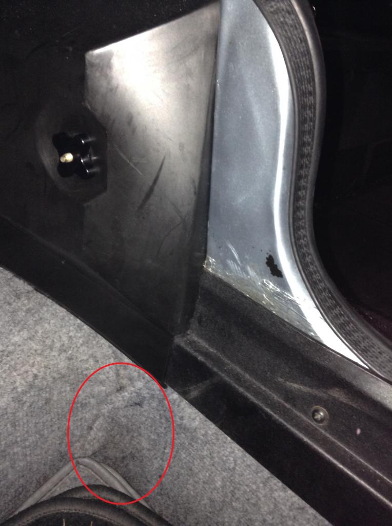

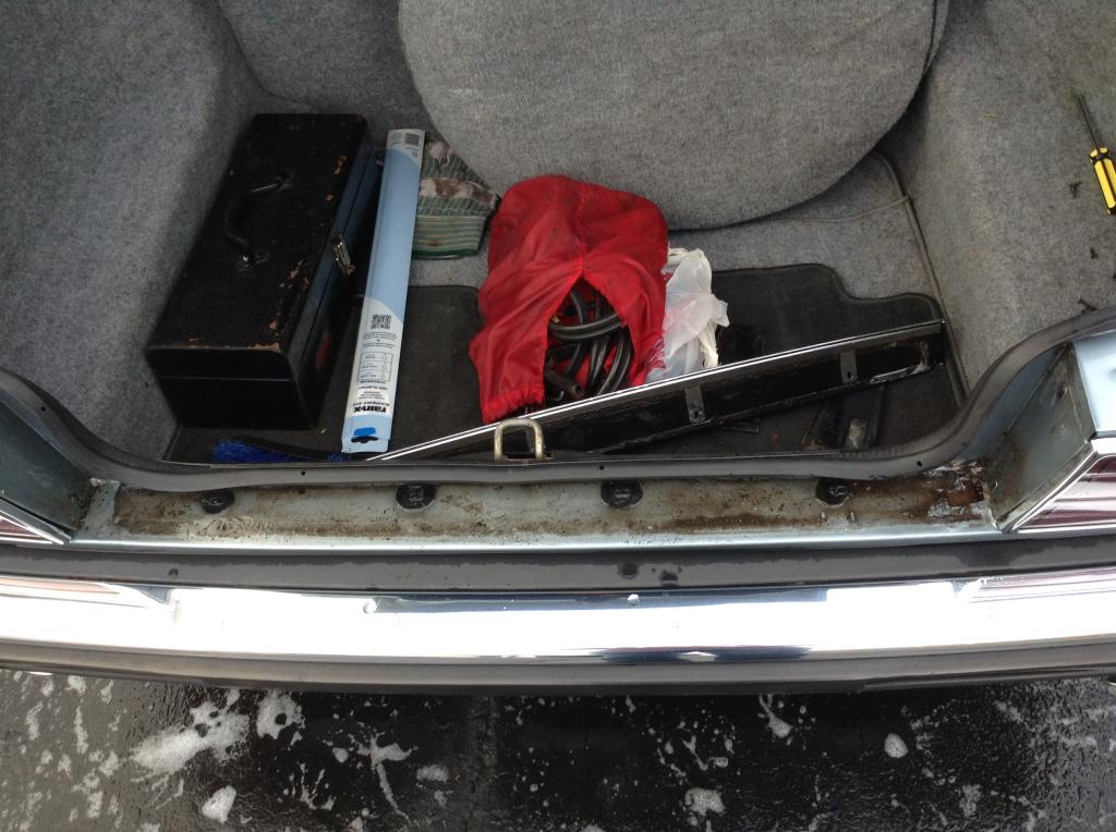

So it poured today. I went out during my lunch to move the car, and I needed to grab an item in the trunk. I opened it up, and the rain droplets on the trunk lid rolled down to the trough around the front of the trunk opening, and race down the sides of the trunk to above the tail lamps, where the water drops on the that black trunk sill plate. In the corners, water seems to be seeping into the inside of the car and running down under the carpet.
Is this a common leak point? Should I take the tail lamps and sill plate out to seal things up? What would I even use to seal it?
It seems like water loves to sit here as you can see from the surface rust there. I'll have to clean it up, prime and paint it once I get the leak fixed.

Nice pics. Take off those plastic sill plate covers, you may not like what you see.
That all needs to be ground down to bare metal, before you clean, prime and paint.
And before that you need to find how it's getting there. Pull out the backing from that tail light and look for anything wet. There is a small rubber seal around the taillight (exterior) check that.
The leak is back there somewhere, the rust, which we tend to focus on, is the resting place for the water. Where and how its getting there is the mission.
I can tell you love your car, which means you'll find it.
After you pull the plate that holds the bulbs in place, pour water on the tail light, then look inside. You said it poured, so you may need a ton of water.

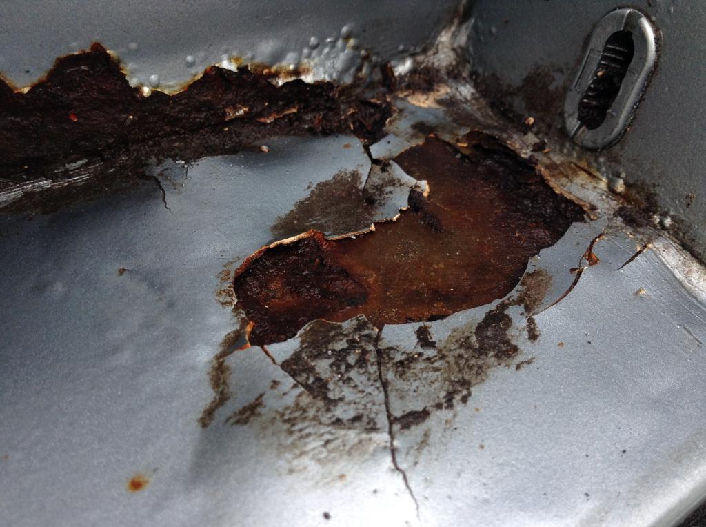

I know it's been a long while since I first mentioned the water leak, but after a day of fair weather, I decided to wash the car and vacuum it. I decided to do a little digging and took pictures.

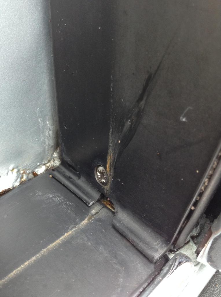

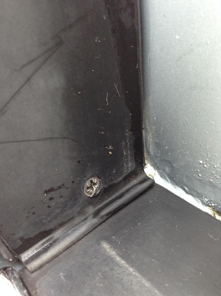

So this is what I found after taking the two side covers, and the bottom sill plate off. I was expecting worse, but I'm glad I checked it sooner than later.
After a quick cleaning up, the middle and left side appears to be perfect.

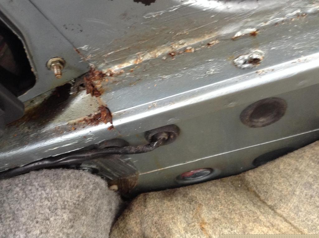

The right side is where there are issues. The rust on the vertical surface seems to just be surface rust. It appears it can be sanded, sealed with some rust inhibitor, and painted. The horizontal surfaces and the seam where they meet are where there's rust that's a little bit more severe. It's still nothing major though.
A close up:
A view of the right side from the inside of the trunk.
A view of the left side from the inside of the trunk. Perfect!

Now I've just go to figure out how to deal with the rust...
