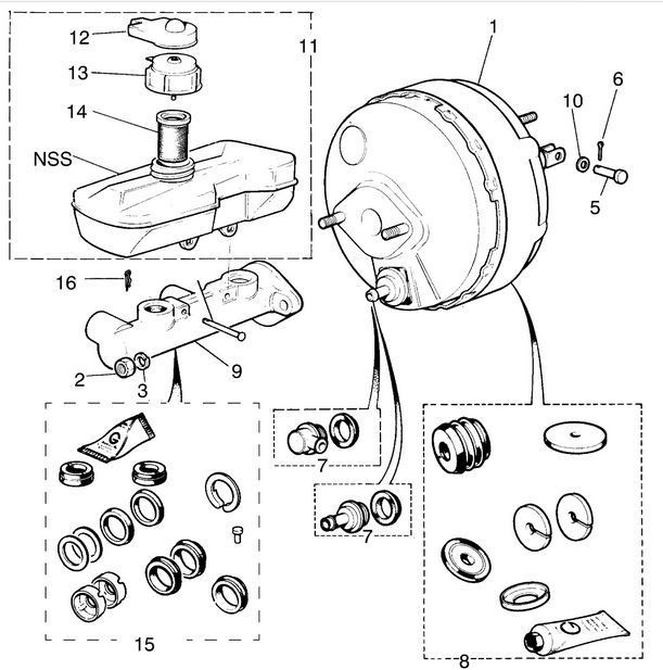

If your car has its original hydraulic brake power assist system, components can be viewed at this link:
https://parts.jaguarlandroverclassic.../brand/jaguar/
Here's the diagram:
However, hissing is not normally a behavior of the original hydraulic system, so it is possible your car was converted to vacuum power assist. If so, on the firewall/bulkhead in the engine bay in front of your steering wheel/brake pedal there will be a large cylindrical vacuum brake booster/power servo. As far as I know, most of the conversion kits used the booster from a Jaguar Series III XJ6. Here's what that part looks like (Part 1), and it is usually black in color:
If your car has been converted, check the vacuum hose connected to the check valve, part 7. It is possible that you just have a vacuum leak.

Here's the diagram:
