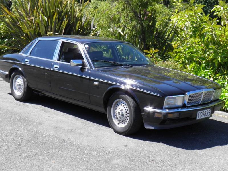

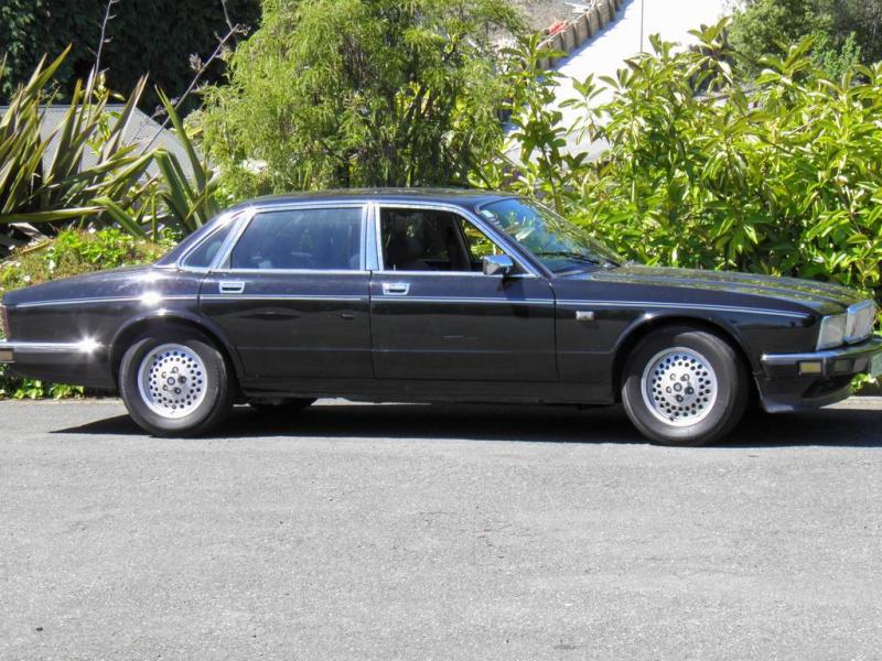

Thought I'll post some pic of our jag with its retrofit brake booster.

Holy cow! Well, under the auspices of 'whatever works!'... Good job!
