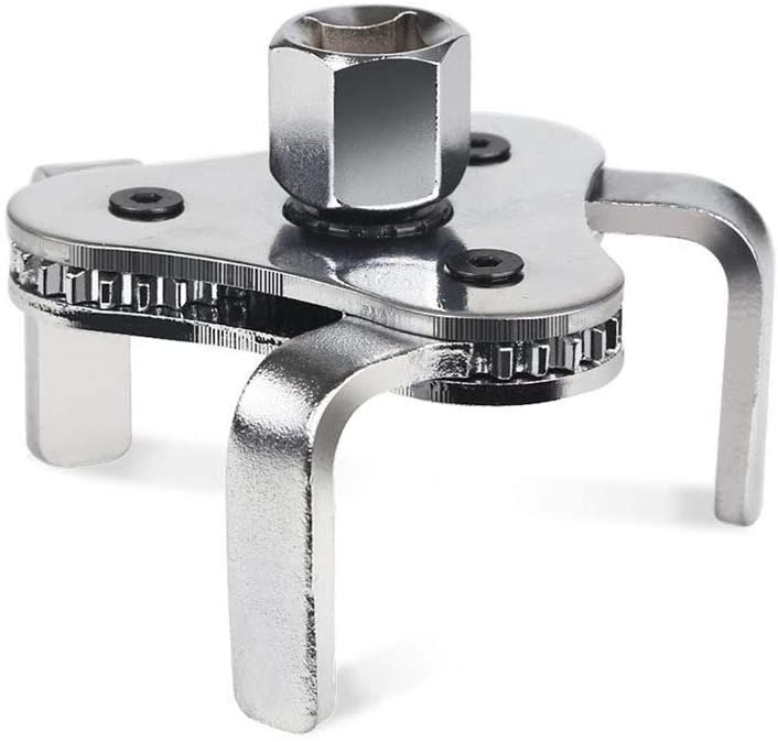

I've used one of these to remove a stubborn or overtightened oil filter on a few V12s. Works well in cramped spaces as you can put a socket extension on it and apply the torque from well below the actual filter.
