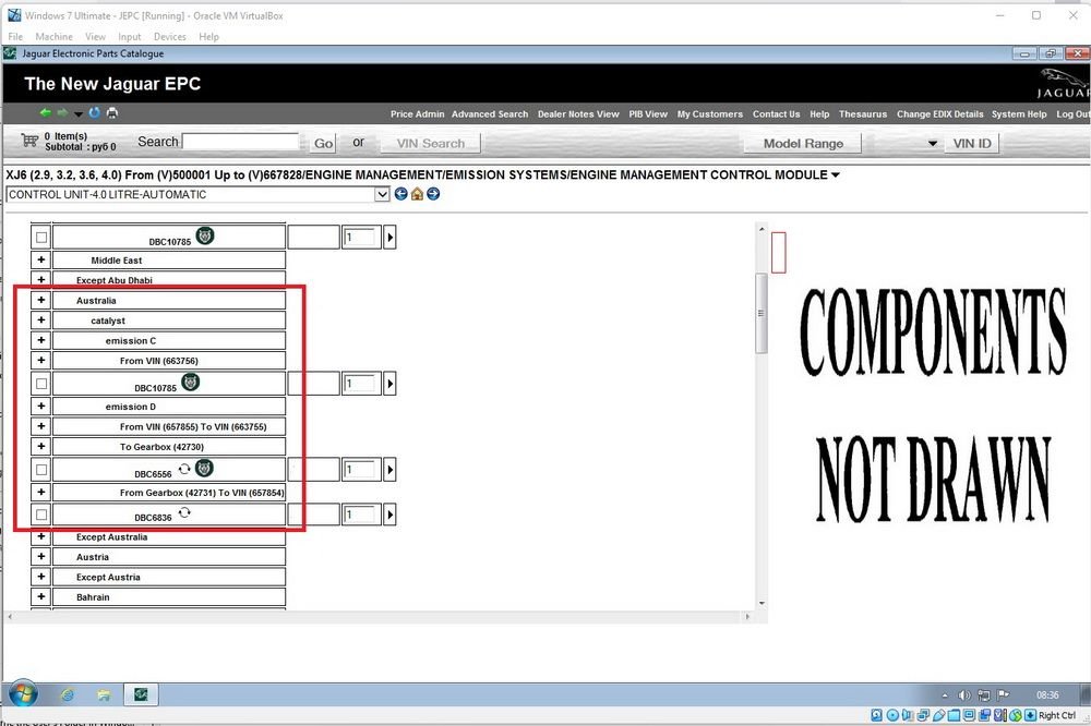

Hi all , I have a 1989 4.0 litre XJ40 , my question is will any ECU from a 4.0 litre car fit and be basically plug and play ? Or are they part number specific ? Take out and replace with exact part number ECU ? All and any advice welcome . Thanks Mark .
Old May 12, 2022 | 02:43 AM
Likes: 17,016
I've moved your question from General Tech Help to XJ40 forum as it is model specific.
ECU's are listed in JEPC (the parts catalogue) as both MARKET and VIN RANGE specific. For Australia there is also another categorisation difference for EMISSIONS:
It never pays to be dogmatic about Jaguars. Some member may be able to report they've successfully fitted an alternative ECU.
