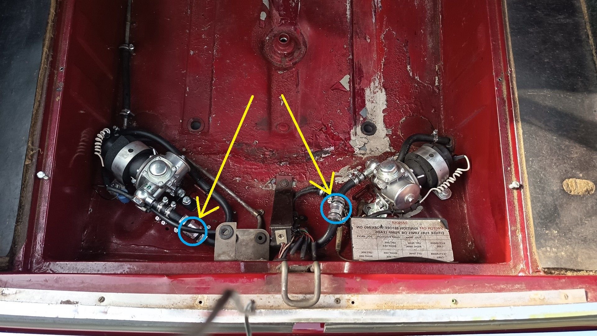

Oh, one other thing: which end would the one-way valves go?

Ok, it's self-evident: obviously where the word "OUT" is clearly marked on the pump outlet itslef with a felt-tip pen...

Yago
You got that right. I am surprised that the "new" pumps should be leaking back but as I said the cheapest way to fix it is installing the valves.

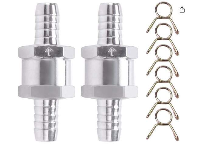

Bill Mac, I ordered these online (they'll get here on Tuesday, 26th Aug) but I don't know what to make of the clamps!

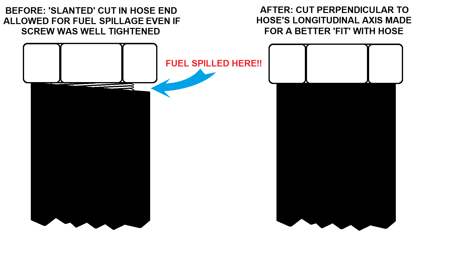

Also, I did not heed your advice on working on empty tanks, and I'm having trouble containing the continuous gas / petrol leak!
See, I wanted to make sure I was ordering the right-diameter-size valves BEFORE I purchased them–and now I have a split fuel line in my trunk till Tuesday, when the order comes in!
So far it's eaten up all sorts of plastic membranes, film, bags, the rubber bands holding them firmly onto the hoses... I've ended up opting for metal screws of the right diameter and I've managed to contain most of the leak, but not all: my guess is fuel is finding its way out following the 'path' between the thread and the interior side of the hoses, 'cuz I have driven the screws all the way in–and they're long too–but to no avail!

Also, I'm having trouble findind worm-drive clamps for such a small size (15 mm / 0.6 in outside diam.), but I'd prefer to use them over what they provide with the valves.
What's your take on it?

Yago
You are not dealing with very high pressure in this fuel system. At the most 4 PSI or .3AU.
Those spring clips should be able to do the job.

Bill Mac, Slofut: finally stopped the leaks by cutting away a bit of hose so that the head of the screws I was using as "leak-stoppers" would sit flat against the end of each hose end–and that worked!
Like so:
Tight fit achieved–leakage finally stopped!!

Yago
Glad to see the valves installed. That should be the end of cross draining tanks.
