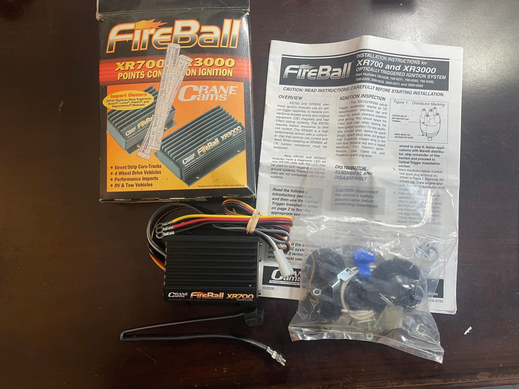

Thanks, Rob, I have a couple of these systems, tried different models of the Fireball/Crane Cams systems in my V12, unfortunately they did not work very well at all, in fact worse than the REOPUS system I currently have. Interestingly my main failure is the Ballast resistor which fails at most inopportune moments and completely randomly. So much so I carry a spare in the boot that I can unplug/plug on the side of the road. Talking with Grant he had similar experiences, which led to discussing the applicability with the Crane Cams Rep here in Australia when he was the 'Big Cheese" in Jaguar spares. Apparently by design they are susceptible to struggling with a high revving V12. Thanks for your response though much appreciated, and definitely worth a go in perhaps a cooler climate than Australia?

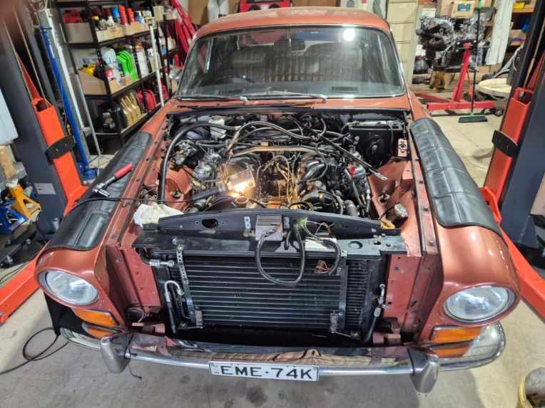

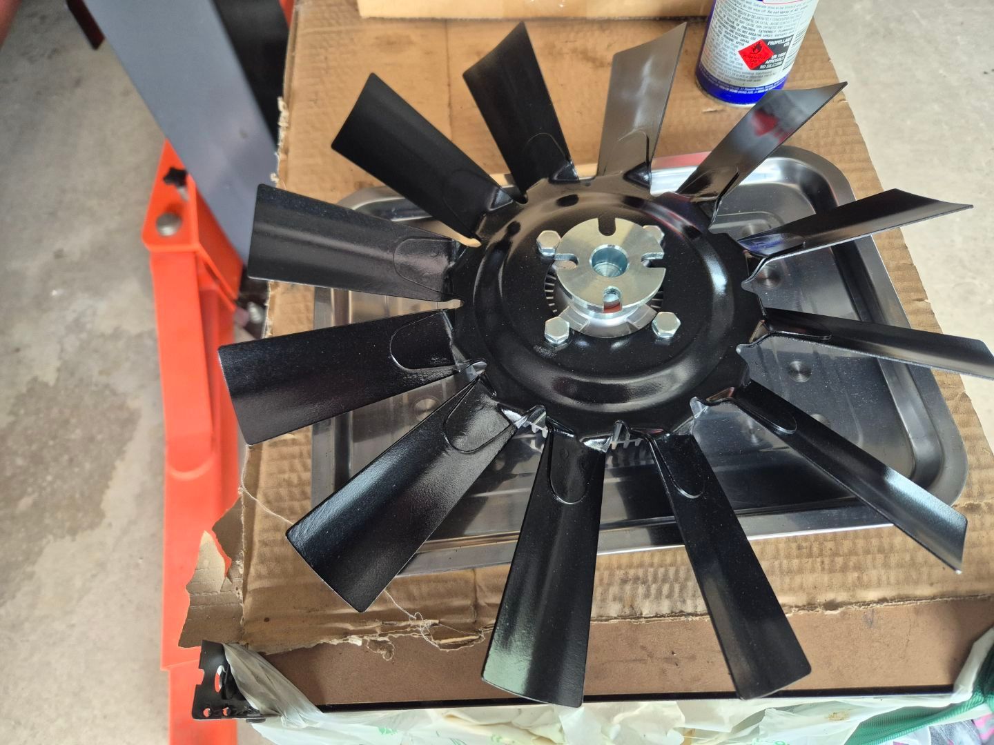

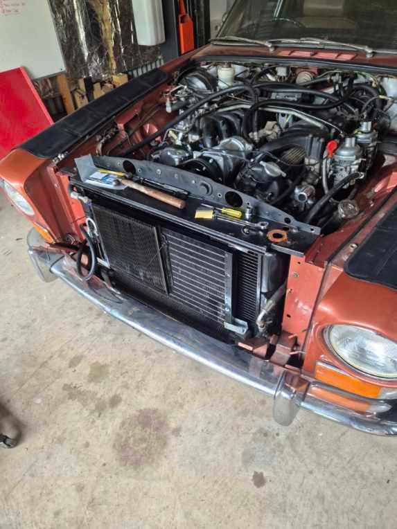

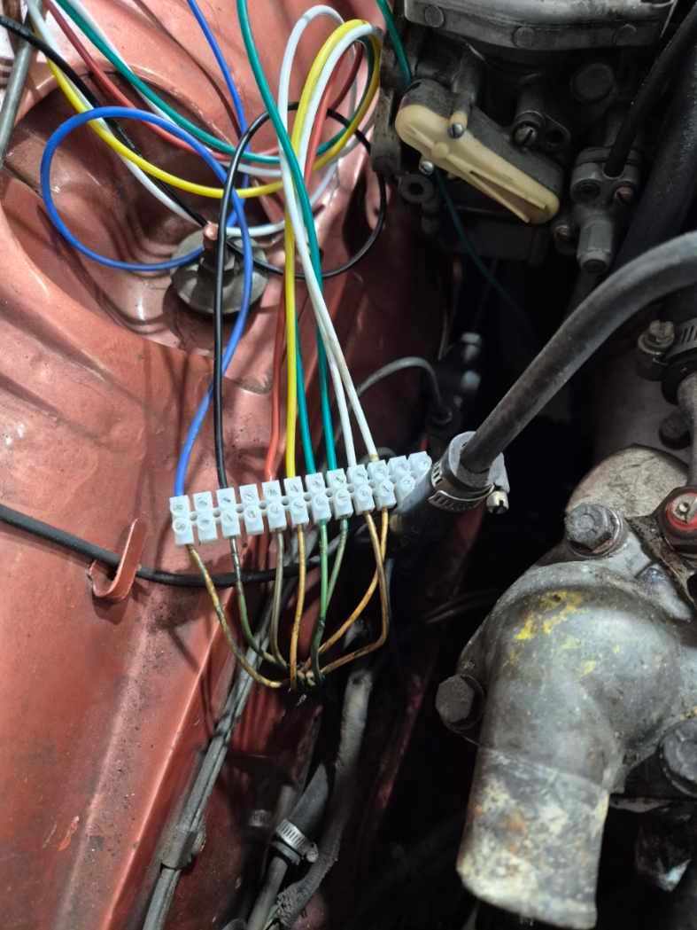

Quick update. I bought the PerTronix 9LU 1122A system complete here in Australia from Pro Quip imported from the US for the Daimler VDP Double Six (Series III E-Type). As advised by Greg I got the complete system: Flame Thrower Coil; Frame Thrower leads (2 x 6 cylinder set of 7mm); and the Ignitor II amp (I think that's what it is called). As I was updating the cooling system on the car: radiator; viscos fan; hoses; I also replaced the old engine wiring with some silicon wire. Sounds good BUT! Whilst redoing the wiring the two green wires coming from the main connector fell out of the harness, so I really hope I have them the right way round. Also, as the old REOPUS system has been removed, and there are an amplifier and a ballast resistor between the harness and the distributor I am making some educated guesses as to the continuity of the wiring entering the REOPUS system and that exiting it as being logically the same. Looks reasonably straight forward and I really only need the ignition wire and the tacho wire on the coil plus an earth to the block from the -ve terminal. Obviously, the ignition on/off wire goes to the +ve coil connection and the tacho goes to the -ve connection, but there are some hints from Chevy and Ford installers that mention an in line 10k ohm resistor which presumably stops the tach being used as a high voltage earth. Additionally, as I have a spare Series 2 engine sitting around, I was thinking of using the throttle pedestal from that engine on the series 1. The benefit being that the Series 2 has a lovely coil mount as per the Series 3/XJ-S V12 that allows the new coil to be located on it, just aft of the distributor rather than located down the side of the engine. The mounting bolts maybe different which may involve a swap over of the valley cover? I'm still thinking about that one. Lastly, and of course because I was waiting for the PerTronix ignition I decided to give the door rubbers a birthday and put a new rear vision mirror on the passenger's side door. All going quite well although getting the window channel rubber/furry seal in at the B pillar is causing some issues. I have had a quick trawl through the forum with limited success on how this might be achieved. ALL advice gratefully accepted.
