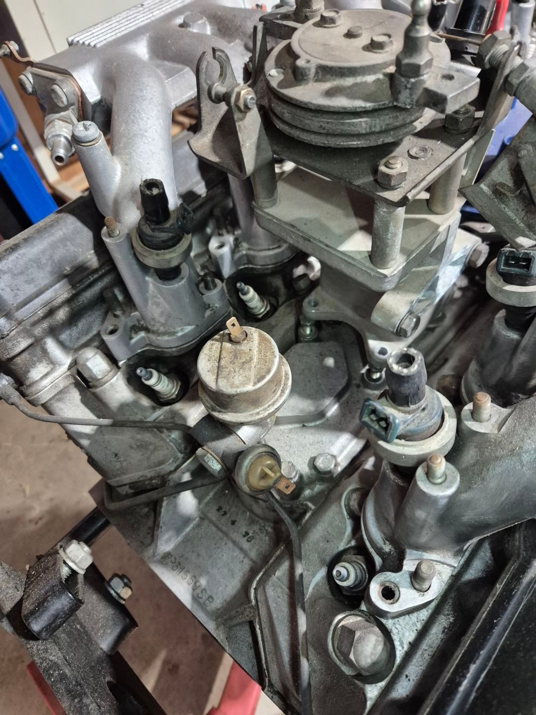

I would be amazed if the throttle pedestal mounting is different!
Old Apr 23, 2026 | 01:45 AM
Eggleton's Avatar
Joined: May 2021
Posts: 74
Likes: 74
From: Heatherbrae, Australia
Well unfortunately Greg the posts are similar but the bolt location on the valley cover are in a different position. Now I reckon if I swapped the valley covers from a Series 2 back into my Series 1 car it would probably work. However, I have decided for the time being to relocate the new coil where the original was located and hope it is up to the job.

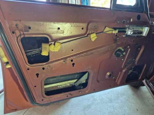

Also while I was waiting for new parts I thought I would renew the door rubber componentry: quarter glass seal, window rubber wiper seals, and the widow channel. This involved removal of the 'cheater panel/quarter glass frame'. This is quite difficult, and although back in after replacing a loose bracket with a new rivet, the window now doesn't go all the way to the top of the door frame, being some 3-4mm short. This will be very noisy at speed and needs resolving: any hints gratefully recieved.

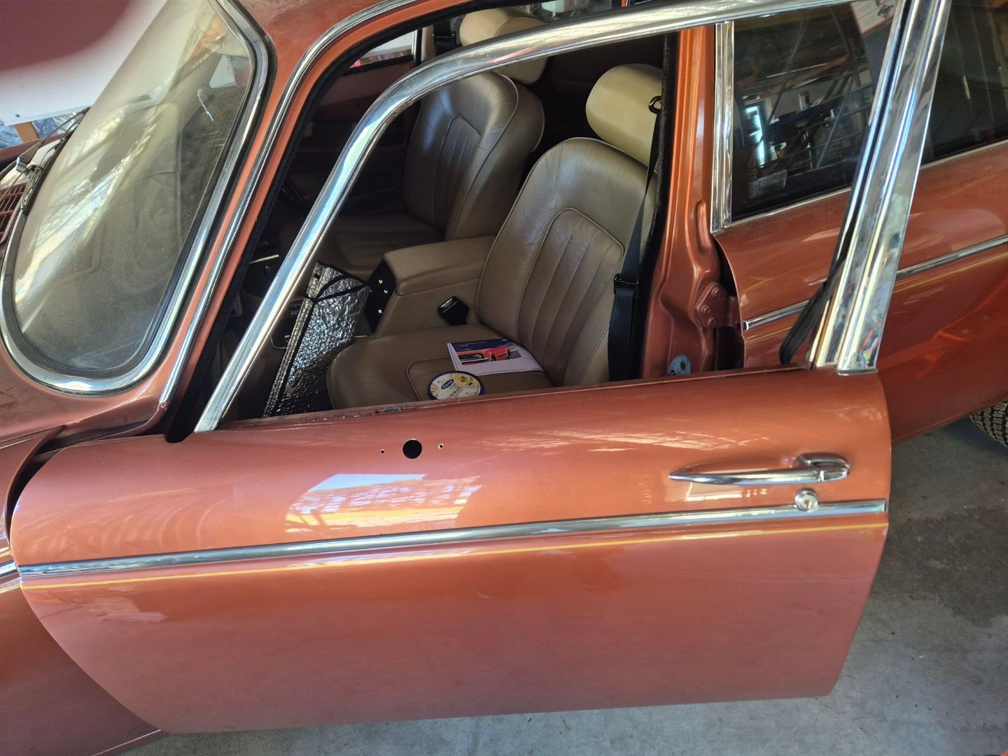

Can you post a photo of the other side so we can see what it should be like?
Is the glass jamming towards the top, or just not reaching the top?
Apologies for the capstan stand guess!
Old Apr 24, 2026 | 02:37 AM
Eggleton's Avatar
Joined: May 2021
Posts: 74
Likes: 74
Good evening, Greg, as requested. Couple of observations:
a. The window is not getting jammed as it goes towards the top;
b. The window slows as it reaches the top; and
c. The glass doesn't reach the top of the frame.
Other interesting points: I removed the glass channel at the rear of the widow, and it didn't make any difference to the travel?
No problem with the pedestal, as I mentioned it will probably work if I change the valley cover over.
I am sure that there must be an adjustment for window height. However, my usually excellent Jaguar Workshop manual doesn't mention an adjustment procedure when relocating the glass.

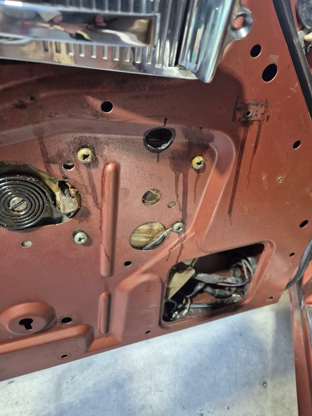

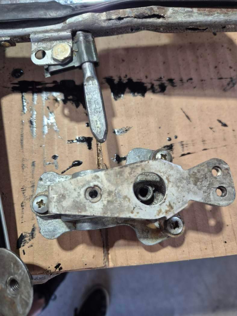

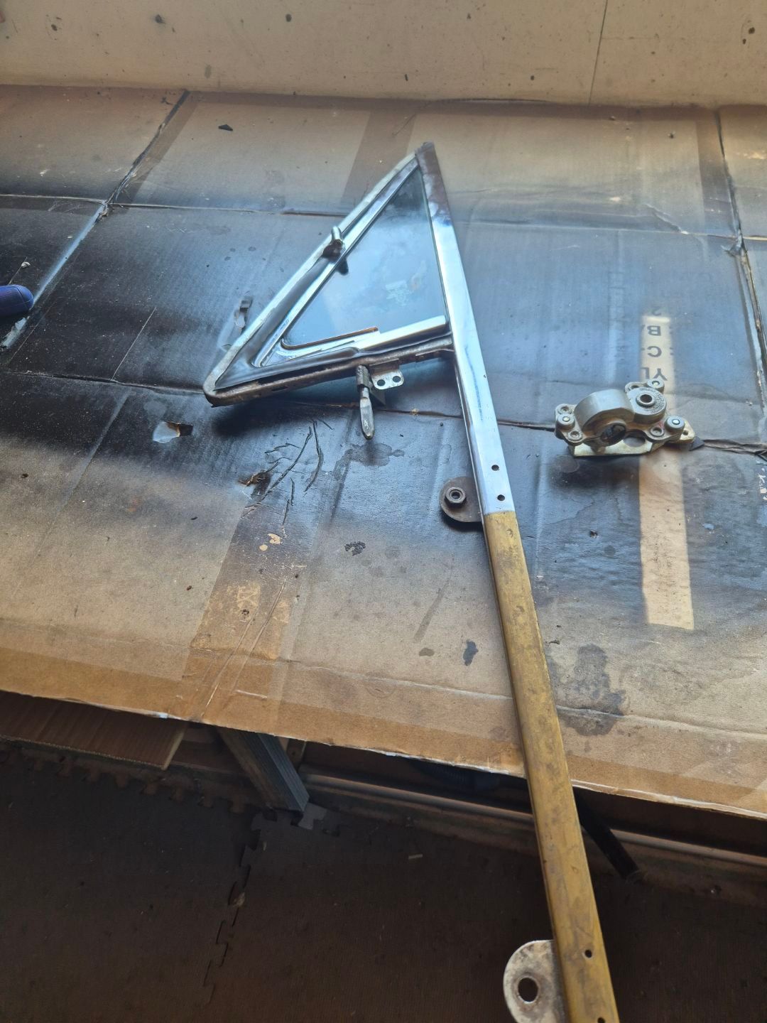

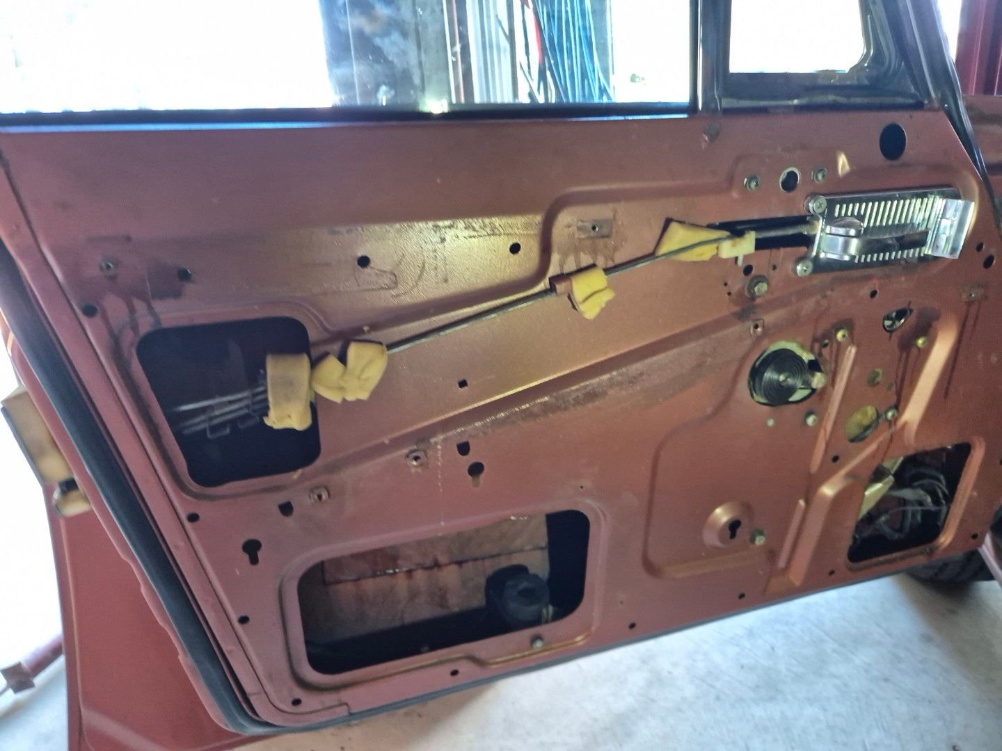

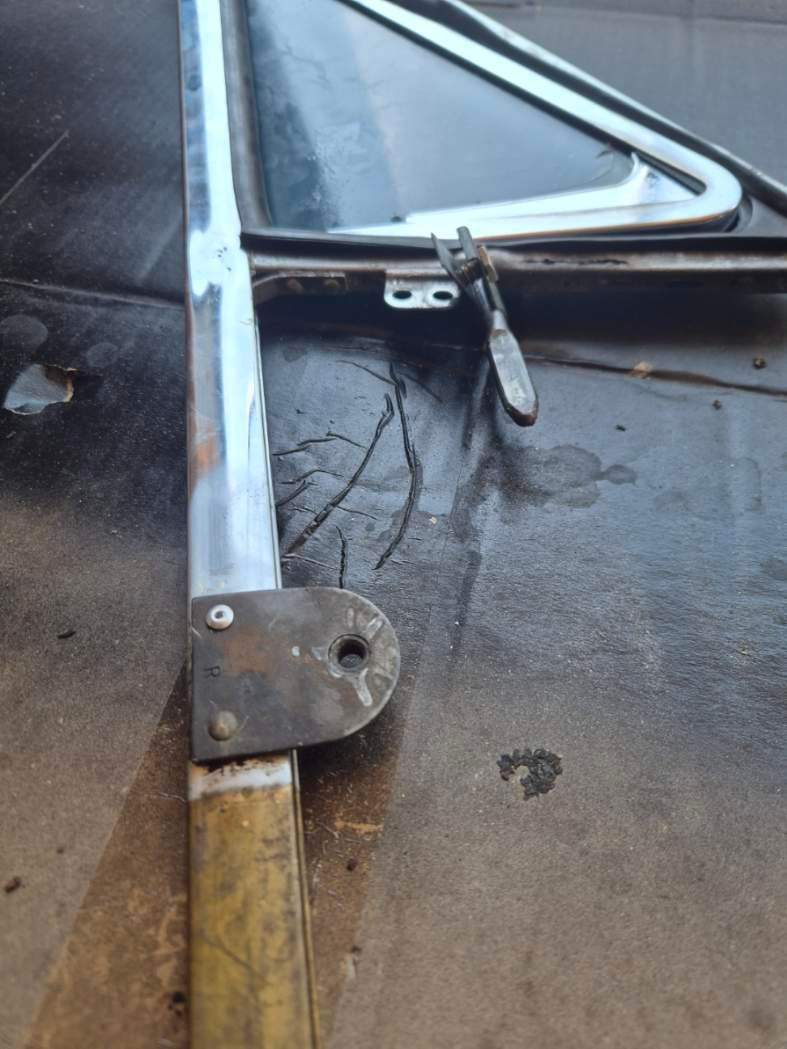

We have updates! Removed the quarter glass frame again and adjusted the window lift using the four screws in the picture below. Seems to have worked although having difficulty getting the quarter frame back in the door, it is a seriously fiddly job. The window now goes into the door frame perfectly. Few tips:
a. Taking the winder mechanism off before removing the quarter frame is achieved by alignment of the spade connector with the winder mechanism;
b. The quarter window needs to be fore and aft, and two screws in the door frame release the mechanism into the door cavity;
c. The window must be fully raised to achieve removal and catching of winder mechanism;
d. Whilst the window is fully raised remove the two bolts holding the lower portion of the frame. They have a spacer so you will need to catch them as the bolt is removed. The top one goes into a threaded bracket, the bottom one has a nut behind the spacer
e. Once removed lower the window fully to remove the quarter glass frame from the door (much swearing occurs but be gentle).
