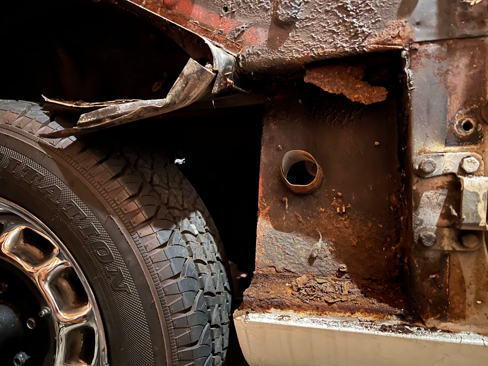

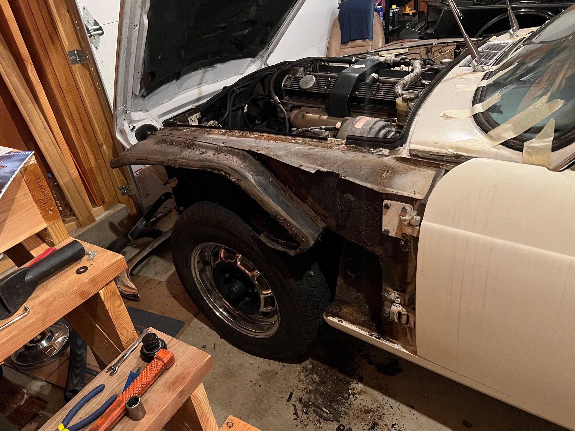

Both front fenders are now removed, and I've found the one and only rust spot that needs serious work. The floor pans, trunk floor, and around both windshields are solid, at worst some rust converter and repainting. But there's a spot behind the right fender that does have some holes. Any tips for fixing this? I assume it'll require some welding.
Fender off. I peeled the wheel well liner back and found the rust spot.
Had to remove a mouse nest from this area before getting those two hidden fender bolts.

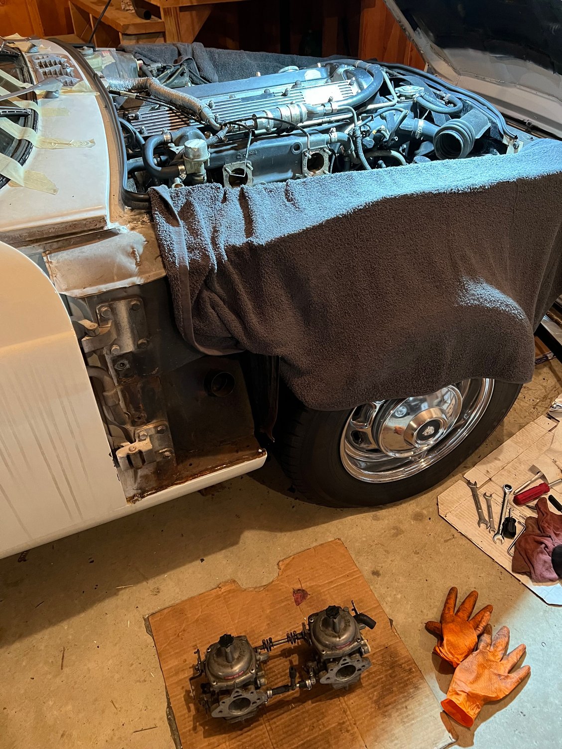

I can’t save both fenders. The right one is fine for this year or until I source another one- it had prior rust repair, and then was spot-welded and Bondoed to the sill. The left fender is bad; the Jaguar badge was attached with bolts, and thanks to another thread here, I think that’s the cause of the one rust spot that needs welding.
The carbs are removed for rebuild. The front one seems to be not right; the throttle disc is very loose. The fuel line into the carbs was the one fuel leak I knew about when I bought the car. The line ripped apart when I tried to remove it. The fuel lines in the trunk were rusty and leaky. I have no idea how this car didn’t burn.

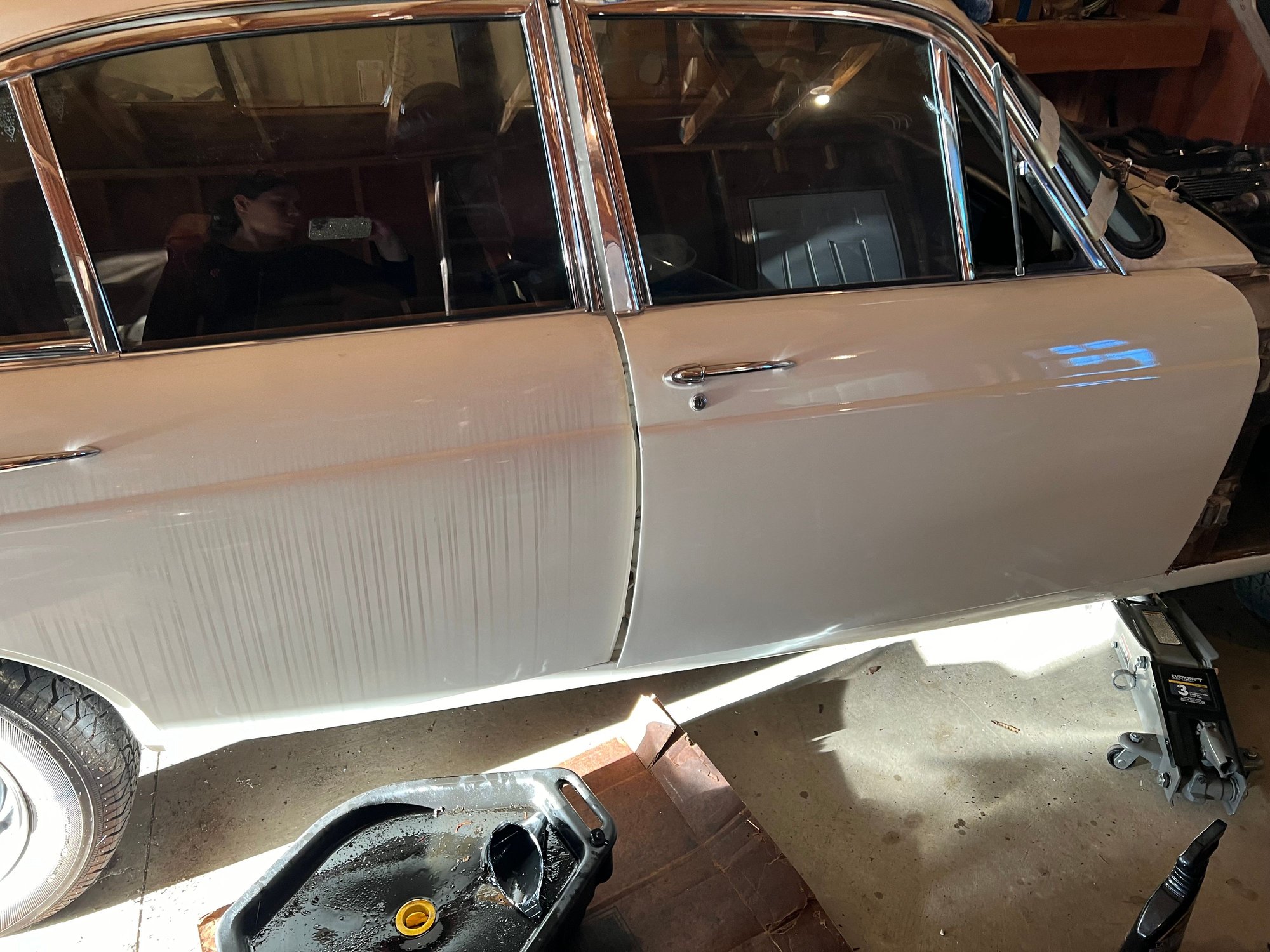

Turns out, the paint is pretty good! I cleaned up a small spot with quick-detailer after some wire-brushing, and then another spot, and whoa. I can put off a repaint for a while- that paint job is good quality, just old. There’s one dent with some awful touch-up, but I have good scratch and PDR people.

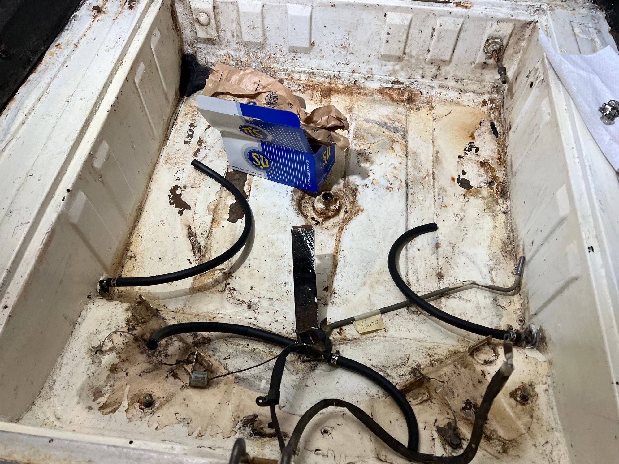

Latest task: re-plumbing in the trunk, rebuild carbs. SU in England had the best prices for new fuel pumps, even with shipping to the US.

You might want to just rebuild your present SU pumps with a points kit. It's rare that the actual pump goes bad.

Back in the garage, what with better weather and show season coming up fast.
I have new fenders. If anyone needs series 1 parts, there’s a 1973 in Middleboro Auto Salvage in Massachusetts that I pulled fenders from. Interior is trash, but there are some usable exterior parts. For this year, I don’t mind Pale Primrose fenders on an Old English White car. Getting them painted can be for this winter.
Carbs are rebuilt. I cleaned so much ethanol goop and mummified old gaskets and o-rings out of them. They’ve clearly been rebuilt before based on the stripped screws, but I’m thinking it was a while ago, and ethanol gas plus age was why they weren’t doing well.

That trunk could be brought back to looking much nicer pretty easily and for under $40.00.
Clean it thoroughly, give the paint a good "sanding" with a 3M or Scotch Brite sanding pad and then spray with the factory color. I have a body supply store locally that can custom mix the factory paint and load it into an aerosol spray can. While not as nice as a bare metal respray, it would probably be a lot nice than what you describe.

You did good to find those front fenders! Might want to check the front of that left rocker panel for rust, kind of looks suspect. That's gonna be a nice ser1, they're so cool, deceptively small compared to todays behemoths and oozing with class, not to mention that red interior!

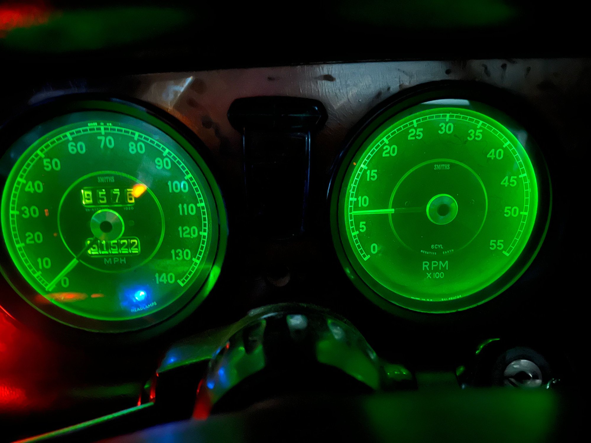

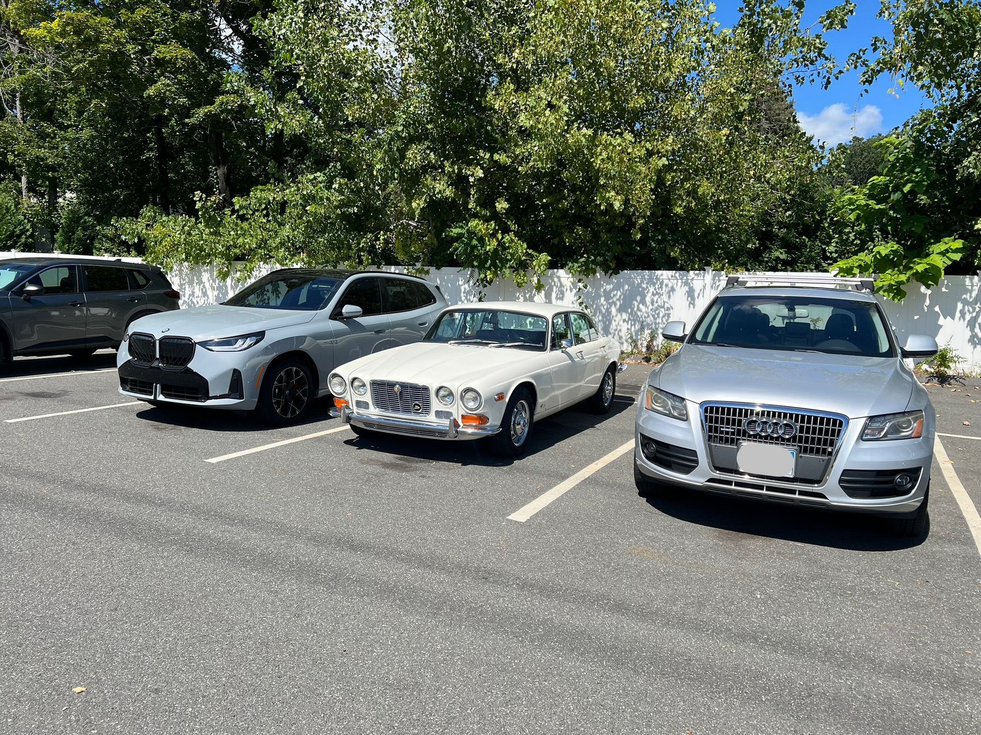

We’re happily back on the road. I’ve put 600 miles on this summer, and this car drives so well. Today I had to stop by work for a few hours and brought the XJ6.
The main headlights don’t work despite rewiring, but the high-beams work great. I discovered this when I was out late one night. The dashboard lighting is so cool!
After a summer of driving, I have a long list of winter projects. The choke mechanism needs work; it doesn’t release smoothly and won’t stay in position unless I have a hand on it. Carbs still need some tuning. The headliner is failing and occasionally spits old foam at me while driving. I’d like to get the air conditioning running again, and I’d like a working radio. I definitely didn’t insulate the front footwells very well, and they’re quite warm. I need to get the other fuel tank working because 12 mpg is not fun when you only have one 12-gallon fuel tank. A cupholder would be very convenient. And the side vent window seals need replacing.
If anyone in the northeast US is going to British Invasion in September, or Lime Rock tomorrow, come say hi!

I am continually amazed at photos of our Series 1-3 cars when parked beside the current crop of behemoths.
This is my previous daily driver - a full size five passenger saloon with a V12 - parked next to a Mini!

The photos with the BMW and Audi are amazing! Did I tell you I have the Middleborough car and want the fenders back!!? Headed to FL soon to add to my other Series 1 projects!
