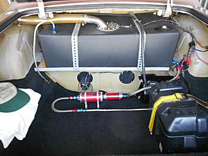

Probably not at all what you have in mind, but we elected to replace both troubled tanks with a spare tire boot custom single aluminum tank. This application has in-tank high pressure pump for EFI, fuel level sender, etc. but carb set up could work the same way. Now only need one fill cap; the other one was repurposed as a battery cutoff switch.
See full writeup at EFI fuel system - XJ6 Restomod

Again, this is for an EFI setup that requires a high pressure in-tank pump.
Aluminum custom designed 22 gallon tank with filler, EFI pump, fuel level sensor, fuel return, vent, and clean outs.

No spare. This aluminum tank holds 22 gallons and weighs about 8 lbs less than the steel twin tanks. Also, from a center-of-gravity viewpoint, it is much improved since it is lower and completely centered on the chassis. A cover over the tank makes the trunk space fully usable. Four vibration isolation mounts on the right and left sides with a drain plug on the bottom placed directly over the old spare tire screw-in holder (this was drilled out and a rubber cap fitted).

As a driver.... No spare?...what do you in case of a flat tire?
This makes the trunk much less usable with all the plumbing and wiring sticking up above the floor surface. no?
So you save 8 LBS. Meaningless when you're walking along the side of a highway or waiting for a tow. What good is a resto-mod if driving it can put you and your passengers in a bad situation? Fuel isnt as heavy as other liquids like water so the amount of "center of gravity" change for this type of mod is insignificant and arguably slightly worse if you consider you moved the CoG forward albeit, slightly.

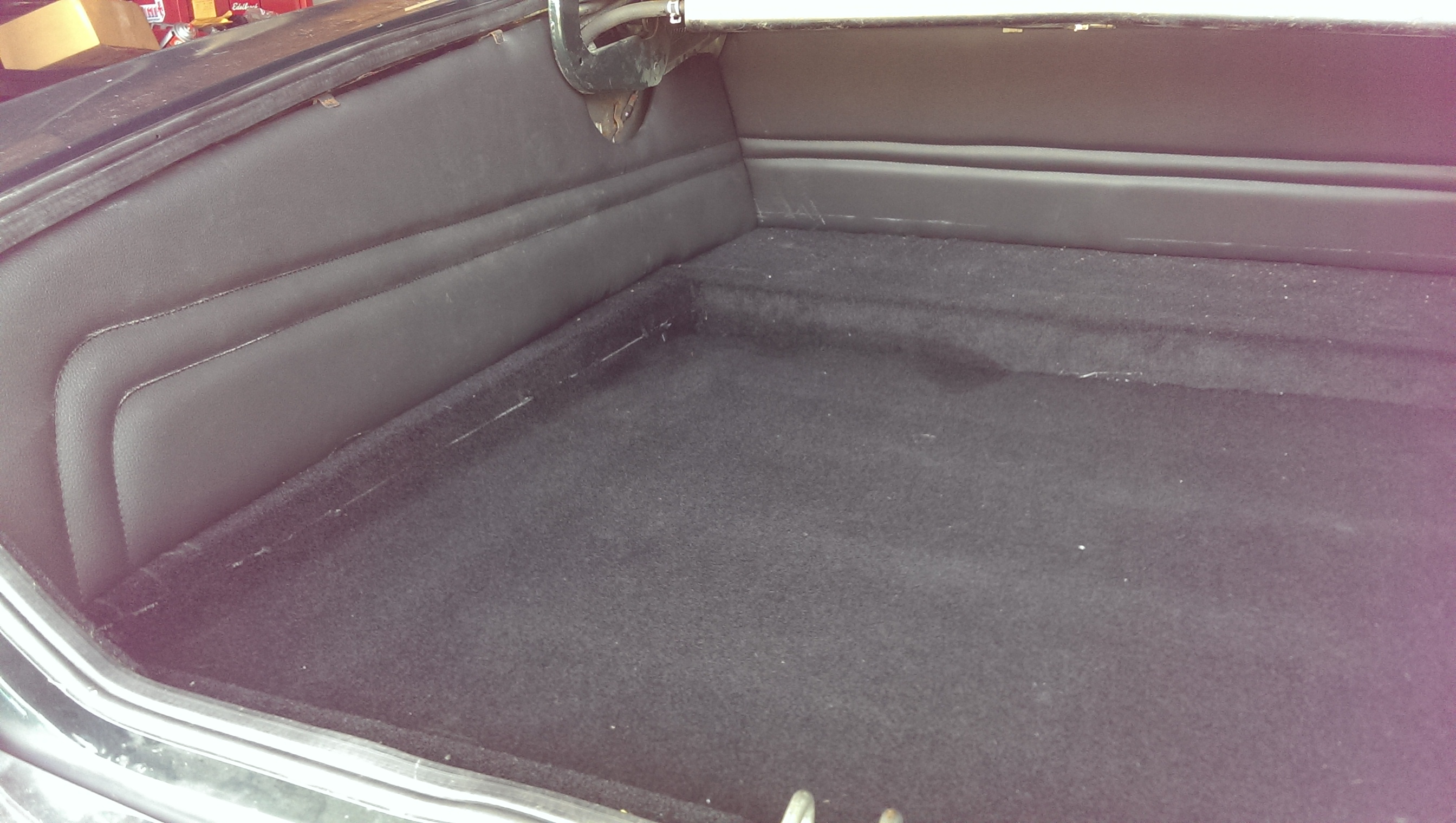

I came real close to using that Summitt tank, but opted for just replacing the tanks with Spectra replacements (again). I use the Pollak 6 port valve to switch between tanks and return the fuel (fuel injected) to the same tank I am driving on. The whole upper trunk area would not be useful if I had gone that route. The system is totally reliable and has been in there for thousands of miles now.
Still have a full size spare under the new floor material as it will help with a tire problem. I did use the compact spare tire insert to hold the needed tools for changing a tire plus lug nuts for the stock wheel since the XJ 40 wheels are too wide to fit under the floor cover. Plus I have full fuel capacity the car came with for fuel..I switch tanks at 175 miles if on the highway or 150 if mostly city driving... want a little reserve in each tank!
