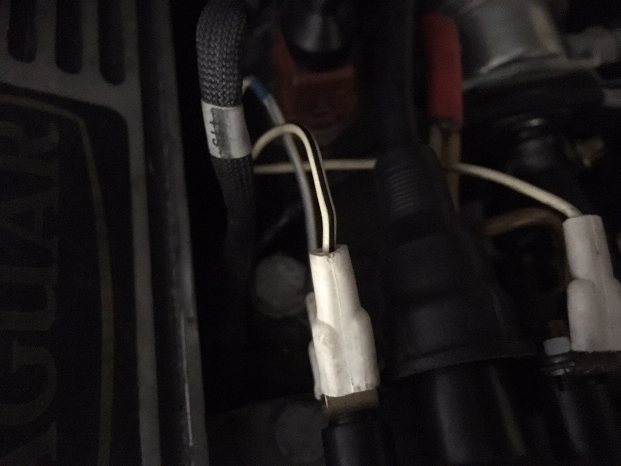

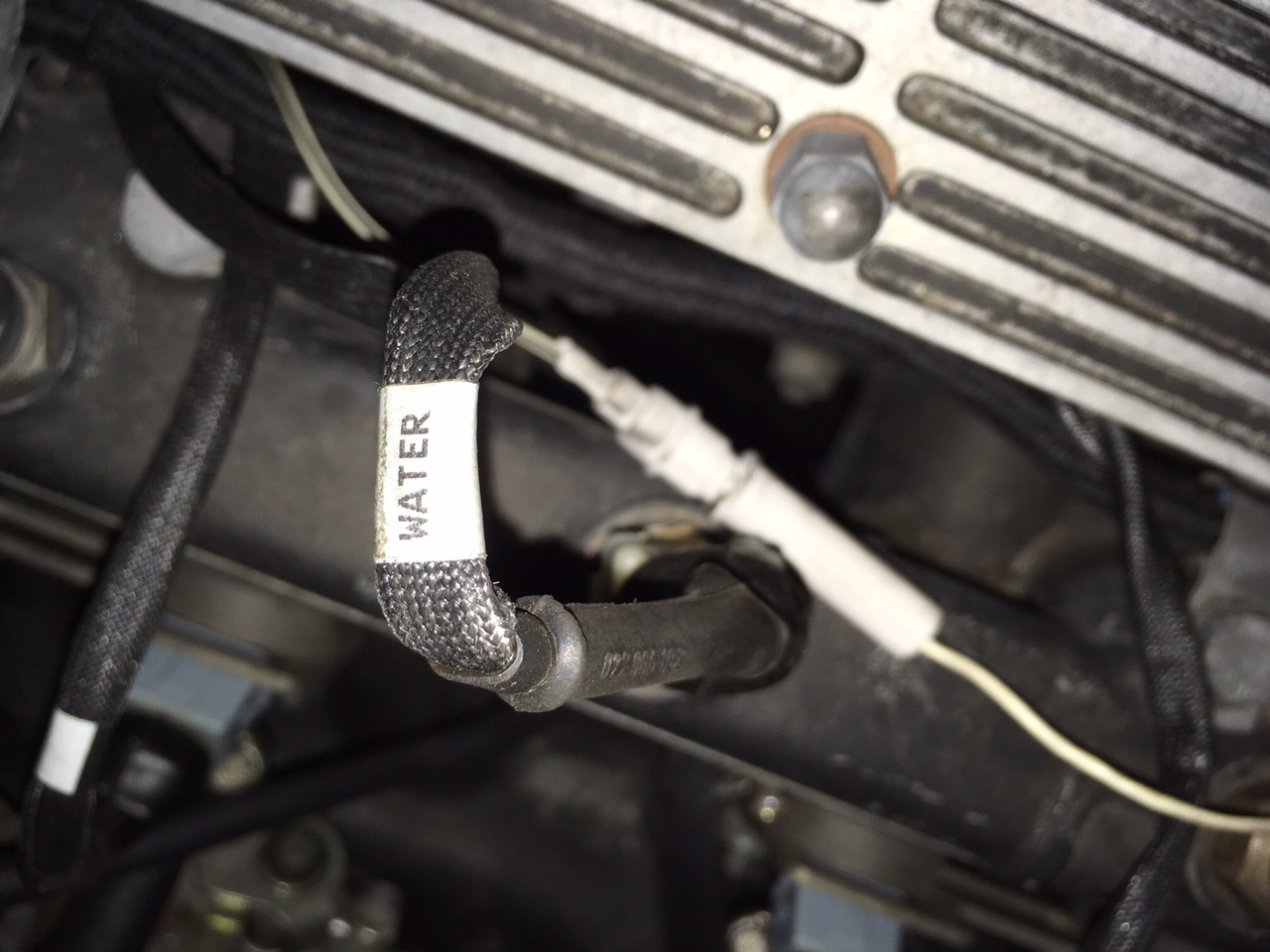

I need Engine Harnesses and Radio for my 1985 XJ6. I have noticed all the harnesses in my engine are week and am afraid to drive it.
Do you have Harness in GOOD condition to sell to me?
Could you also recommend where i can have the harnesses to buy?
Engine Compartment attach to show Harnesses.

Hi Mike,
I replaced my engine harness last year with a new one from David Manners in UK.
They are made to order so a 70 day lead in, but very happy with the result.
Cheers,
Nigel

You will probably need
Injector Harness XJ6311 and
Engine Harness XJ6313
Just looking at your engine bay photo's, there is a lot of weathering (surface rust and oxidation).
I dare say that earth straps and earthing points will need a decent clean as well.
Cheers,
Nigel
