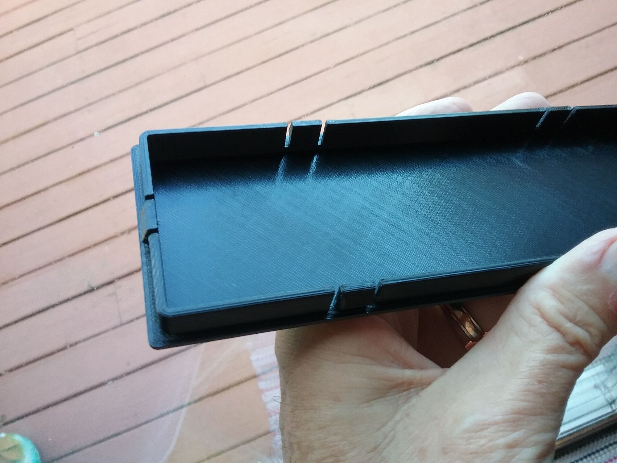

Great news! According to Yellow series3, they fit. He'll be posting pictures shortly. I sent him two versions, mainly to test out different clip heights. One is really tight (good for preventing rattles) and the other is just tight enough. I'll redesign the clip length to be at the mid point of the two.

Yes, they arrived today and it popped right in. Extremely high quality and very sturdy. Would be perfect for toggle switches, a clock, etc. I highly recommend it.
Our good friend David at everydayxj.com posted a write-up regarding how to remove the trip computer panel. Here is the link. I am replacing all my woodwork and following his instructions worked like a charm. The one thing I would add is put a towel over your ski slope and your radio so you don't scratch them. The panel is made out of sheet metal and has sharp edges.
Here are the photos.

Also, the inside vertical dimension is 1-7/8" so if your going to mount a clock you don't want one with the back part of the clock greater than that.

Hi Neinz, are you going to post the file for the blank? I can't wait to try it out.

Hey there Muttony, my apologies. I've been away and busy for a while. I'll post the files when I get home today from work.
Old Jul 18, 2019 | 02:21 AM
  #39
neinz's Avatar
Joined: May 2017
Posts: 40
Likes: 13
From: Campbell, California
Here you go.
