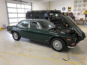

Hello all!
Im thinking of converting my XJ SWB to chevy v-8 power. The V12 has given up the ghost and is seized beyond repair.
Does anyone know a good conversion shop other than Johns Cars in Dallas?
I live in Wash. DC.
Thanks!
Happy Jagging!
John W.

Wow! Is that your Garage!? Fantastic!
Rusty
Rusty
My thoughts exactly, I forgot your original question about the dead V12 and focused on that work space in the picture.
