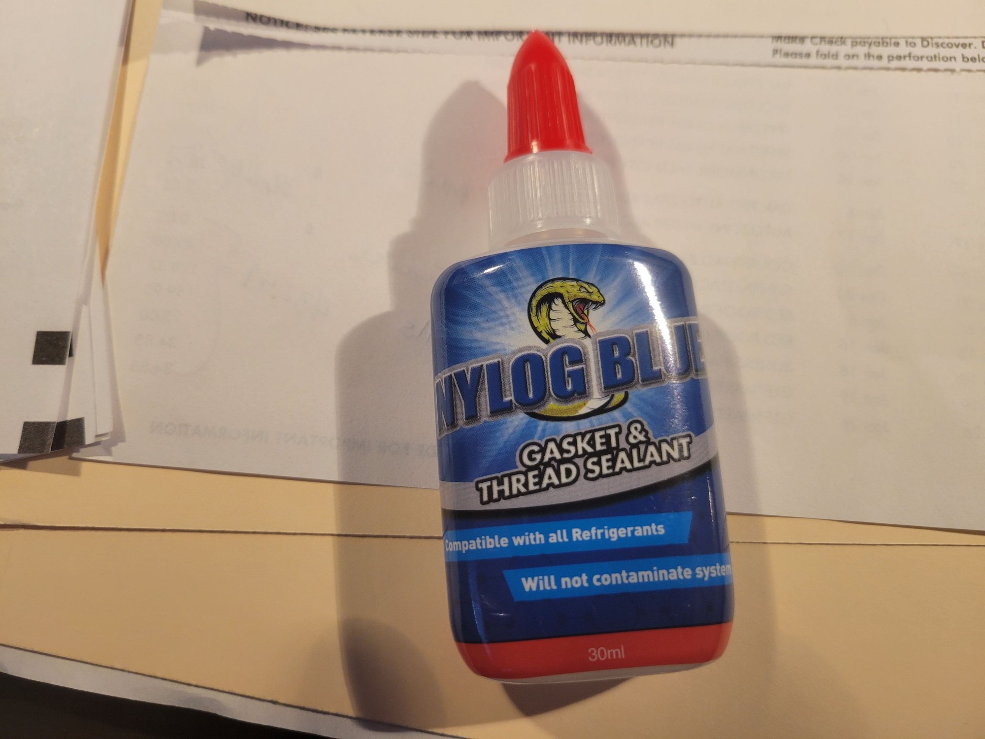

I have used NYLOG BLUE on ALL my Nitrile O-Rings on my A/C for years. It's a clear gooey, sticky, very viscous liquid that seals really well. And it doesn't harden. Pic attached.

Thank you gents,
Assortment of green O-Rings, and NYLOG BLUE ordered.
