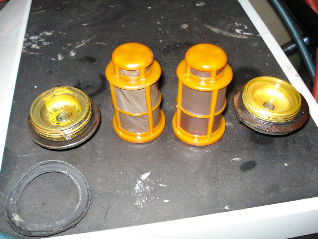

What is it with you guys from the US! and draining the fuel tank's? You scared the heck out of me with all that rust in the tank's, is the petrol quality that poor?
I drain both my tanks this weekend and they was in excellent condition, and no sign of rust inside, just a litte surface rust on the outside.
The rust-in-fuel problem thing isn't really a fuel quality issue, nor a Jaguar-specific issue. Usually, it's a storage issue.
In the majority of cases the rusty fuel problem occcurs when the car sits unused for long periods.....thus the age-old recomendation to keep the tanks full so condensation in the tanks is less likely to be a problem.
