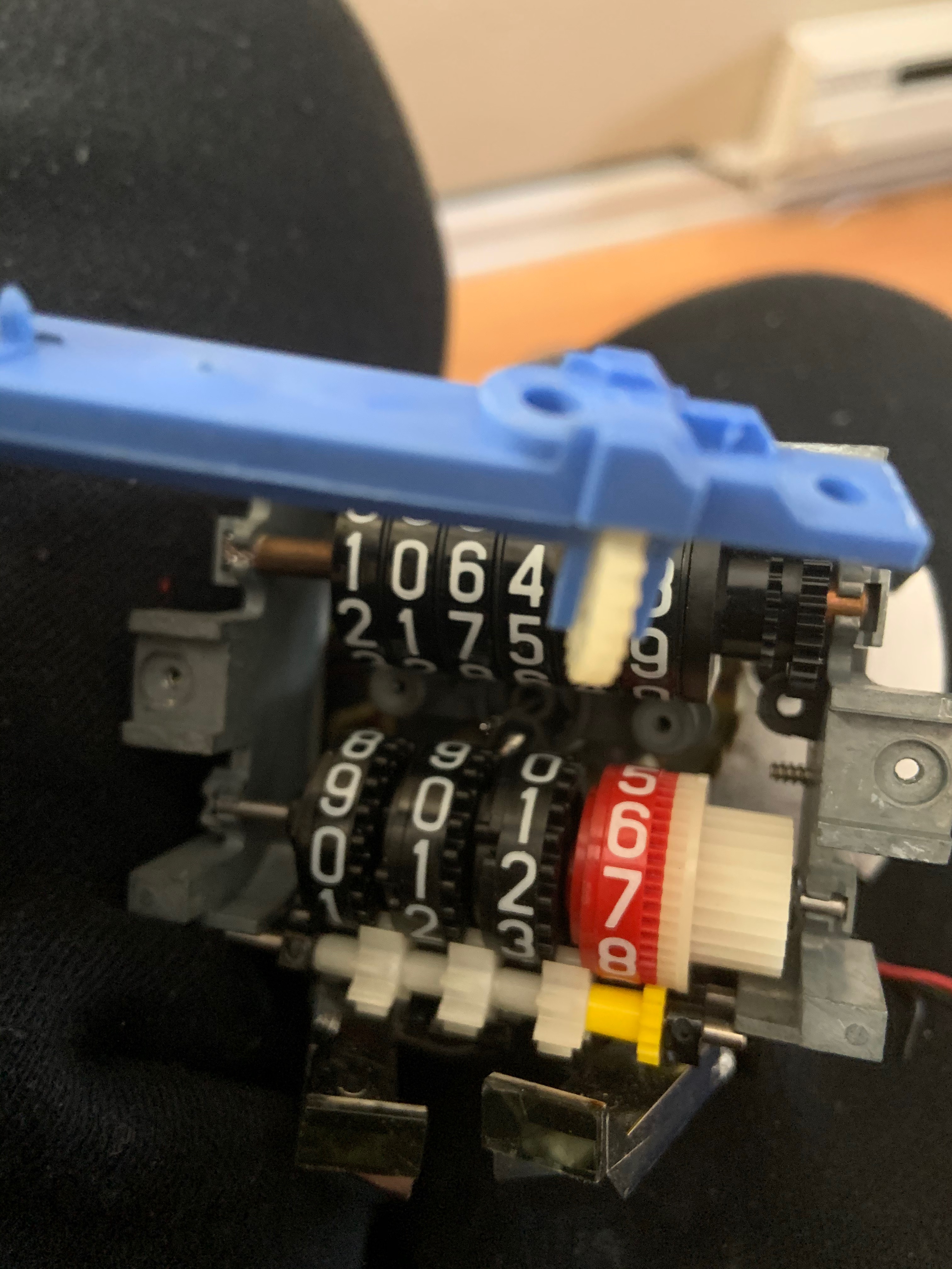

Originally Posted by MFOX
My 85 XJ6 has been sitting for about two years, just got it out yesterday and cleaned it up, everything seems to be working fine but when i took it around the block a couple times, i noticed the odo and trip odo wern't working, but the speedometer was working the whole time. Does anyone have an idea of whats goin on and how I should fix it?
I thoroughly cleaned all the grounding connection's in the circuit, installed a dedicated grounding strap for the alternator. Then, installed a brand new, name brand, voltage regulator($14 online)without removing the alternator from the car. 14.4 volts full time. After performing "surgery" on some spare speedometer's, which I purchased on EBAY, I found that there was too much "DRAG" on the worm gear attached to the step motor in the speedo. unit. The gear was responsible for turning no less than "8" gears in order to operate the odometer and the trip-meter. So, on my unit, I pushed IN the reset stick at the bottom of the dial, applied a couple of drops of superglue, which held the stick in that fully depressed position. This action effectively decreased the drag on the step motor worm gear from "8" gears to "2" gears. Pressing the reset stick retracts the gear rail which disconnects the odometer gears from the trip-meter gears. Drove for 2 days, works, so far, flawlessly. I have not, as of yet, discovered the need for an operational trip-meter in 2020.
[img]219663[/img]
I believe, "resistance" is the more appropriate word to describe the action against the step motor, not "drag". Good luck.
Attached Thumbnails 85 XJ6, odometer not working, speedo does, help-conikgearrem.jpeg
Last edited by Tonytonem; May 15, 2020 at 07:10 PM. Reason: add pic./edit wording.

My above post contains a picture of a volunteer “donor” speedometer. On the YouTube channel LIVING WITH A LEGEND, the gentleman video’s the disassembly of a gauge on a SERIES II. He removes the bezel by aligning the tabs with slots located in the case. On my 1984, there are no slots to align, only tabs that must be bent outward. Looks terrible after re-assembly. The black plastic case attached to the back of the unit is attached by 4 screws which are only accessed from the inside of the case after removing the bezel. Go figure! I tried drilling out the screws from the rear, but the plastic is soft, and the screws are hard. Probably needed a drill press. Sooooo, as
mentioned, I just pressed the reset stick, which allowed the “white gear” to spin,’but not engage the red gear. Unit broke at about 88,677 or so. Now...
