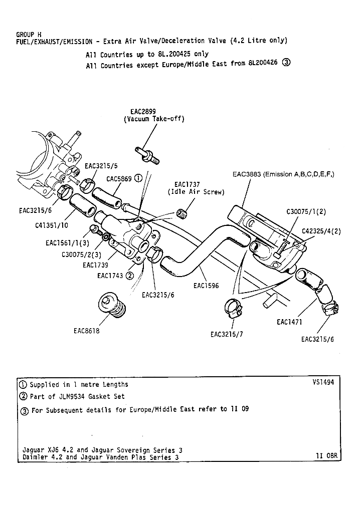

The AAV is bolted to the underside of the water rail. It's an odd looking thing. Part number EAC3883 in this illustration
The purpose of the AAV is to let more air into the engine to give a higher idle speed when cold. Often they are inoperative.
Warm idle speed is adjusted by turning the Idle Air Screw, part number EAC1737 in the illustration. Awkward to reach; you'll need an Allen key but I can't remember what size at the moment. Idle adjustment can't be adjusted for "in drive only".
