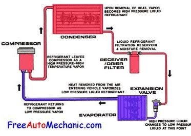

You say the engine is in and running, so what radiator/condenser/receiver-drier tank are being used, the stock Jaguar or Chevy units? Here is a general diagram showing parts and plumbing for an A/C system. I don't remember where the compressor mounts on an older gen1 SBC, I think it's up high on brackets similar to an alternator. Notice in another picture that the LT1 compressor mounts low/left viewed from front.

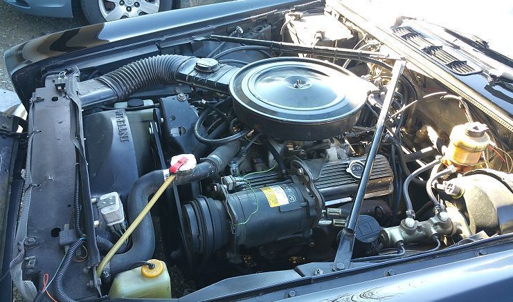

Hello,
I'm another of the "Heathens" in here with a 350 power plant (which I *Love*) installed in 1985 or so.
All the AC stuff is connected and works very well. I'll get some proper pictures up a little later as I find them, or take better ones.
For now though, this might help you:
That's the ancient compressor compatible with the car's other components. Huge by today's standards, but they didn't know how to make them small in those days I guess.
Later today I'll get more pictures of mounts, dryer, hose routing and stuff.
Welcome to the adventure from ElinorB!

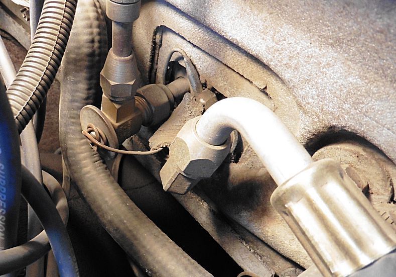

EDIT; More pictures as promised:
Back of the compressor. Showing here is the Low side charging port.

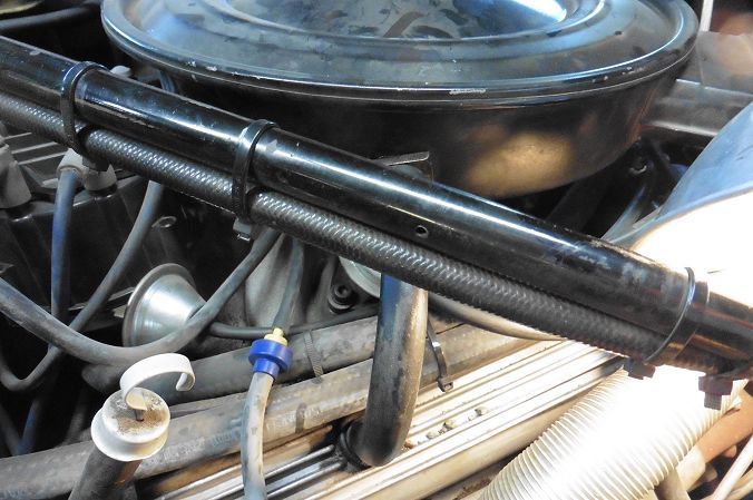

Hose snaking around under stuff to the condenser.

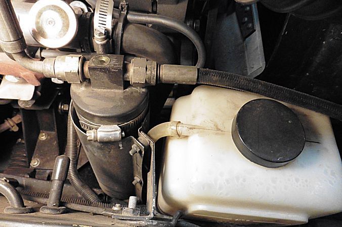

From the condenser to the dryer.
Real HiTech, Zip tied to the brace from the dryer. Was like that when I got the car.

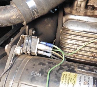

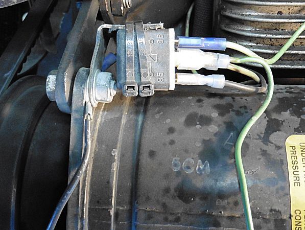

Relay was tacked onto the nose of the compressor almost as an afterthought. Works quite well though.

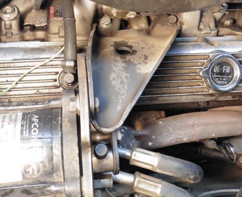

Here are the mounts for the compressor.
Huge, Massive things, Grossly overbuilt. They weigh about 6 pounds each!
The rear mount, as you can see, bolts to the intake manifold.
Just under the rad hose you can see the back of the front mount.
Front compressor mount.

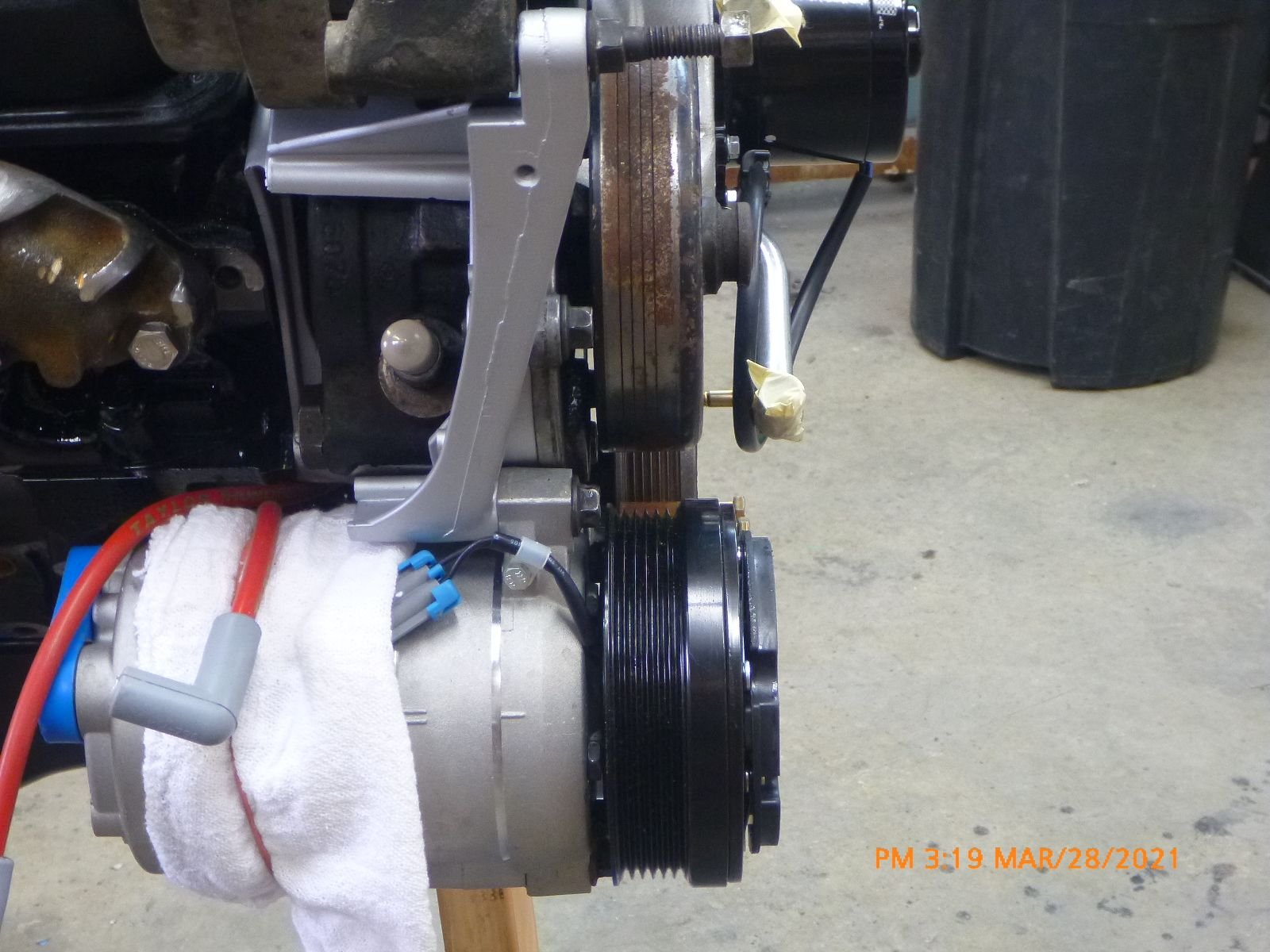

Sound like an older V-belt conversion so you'll need and A6 compressor and the brackets from 71 to 81 Chevy V8. I'd use 78 Chevrolet Camaro as a Y/M/M. Parts for for this V8 application will be highly available. Make sure you have a empty grove on your crank pulley. You MAY or may not have a crank pulley for an A/C car. If not, then order a crank pull for a 78 Camaro v8 with A/C.
As for the compressor.... 4 seasons makes an all new Aluminum A6 that is sweet. See below. I installed one on my GMC motor home this year and it performs flawlessly. Makes good cold air even with R134a, operates very quietly and the compressor clutch cuts in/out with a gentile click. It also weights far less than the original iron unit. .
