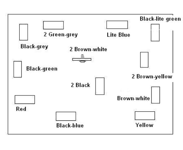

3) check the wires in the Blowers Relay are secure, especially the wire with a screw located in the center of the relay. See diagram of Relay wiring.

Attached Thumbnails ac question for the pros-xj-ac-2.jpg   ac question for the pros-blowers-relay-xj.jpg
