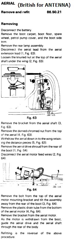

Thanks anjum I have tried that so I will be removing and checking. Just wanted to double check before removing the tail light so no surprises. I'll give it a go tomorrow , also found this on the web.

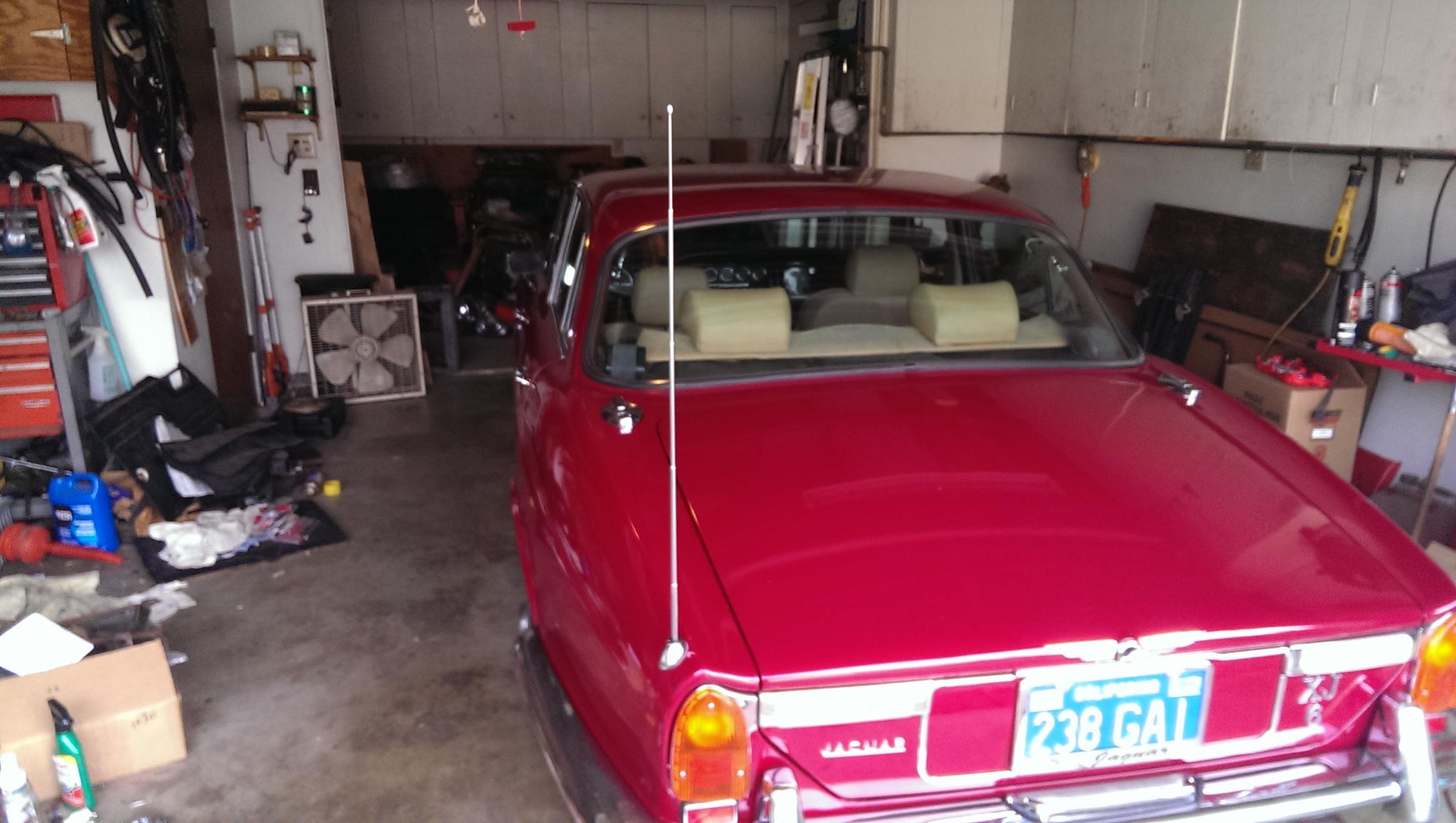

Default '72 Jaguar has power antenna with a toggle switch
After finding a power antenna that would fit in the rear behind the tank, not in the lower trunk area, it was desired to control the antenna mast movement.
Not wanting to wear out the antenna by going up/down each time the key is turned on/off, I mounted a toggle switch under the dash... it
will remain in the same position - until the switch is used.
Attached Thumbnails Aerial stuck.......removal-installed-but-switch-not-mounted-yet.jpg

Well I removed the tail light and the mast is easily accessible through the gap. I then took the rear panel off from the boot(trunk),between the spare wheel and the bumper and the motor is also easily accessible this way.My problem is I don't know which end of the black cable joining the motor and mast is detachable as this cable is fed through the body panel .......Don't want to force anything!
Has anyone done this on a s2 before? are s1 the same?
When I pull this apart I'll put up some pics as there doesn't seem to be much info on this setup.It does look factory fitted nicely between the fuel filters etc for the 2 tanks.

OK,finally found a similar one where the ends appear to have screws....I'll double check. Tomorrow .
