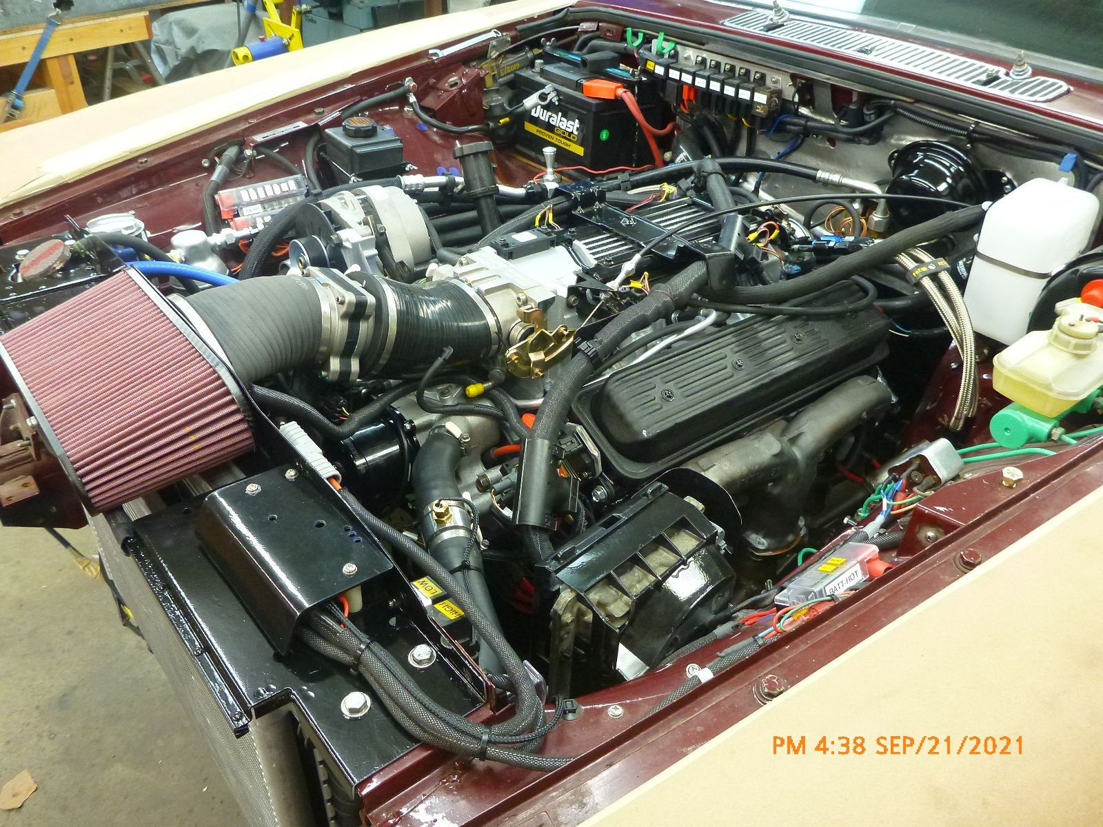

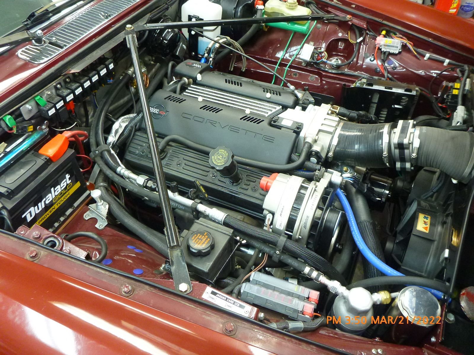

Hey Dave, sorry to resurrect a thread after so much time but quick question. I have an '85 XJ6 with an LT1 and I'm hoping there is an easier fix for the throttle than me designing and 3d printing brackets... How'd you do your throttle from the stock pedal to the LT1 motor? Do you happen to have a picture or two?
Reply 0
May 3, 2026 | 12:52 PM
  #228
Quote: Hey Dave, sorry to resurrect a thread after so much time but quick question. I have an '85 XJ6 with an LT1 and I'm hoping there is an easier fix for the throttle than me designing and 3d printing brackets... How'd you do your throttle from the stock pedal to the LT1 motor? Do you happen to have a picture or two?
No problem, glad to hear it still gets read.
The bracket on the intake is stock and came with the engine. The bracket under the dash is stock. I started with a complete cable from Lokar Performance, but had to make a new end for the gas pedal end. I think I started with a small allen-head cap screw and rounded the under side of the head with it chucked in my drill press. This part is a little tedious, but I live for the tedious. I drilled a hole through it and soldered the new end on the cable. On the throttle body end I used the small barrel nut they included with the cable, I had to drill out the pin hole in the throttle arm a little, but it turned out fine. Lokar shows a replacement inner cable with a ball end, but the ball is too big for the socket in the throttle arm and trying to drill out the arm proved too costly in drill bits. It's hardened steel. Here's a couple pictures and links to Lokar. I didn't take any specific pictures of either end of the cable.
https://lokar.com/tc-1000tp.html
https://lokar.com/wca-104.html
Dave
