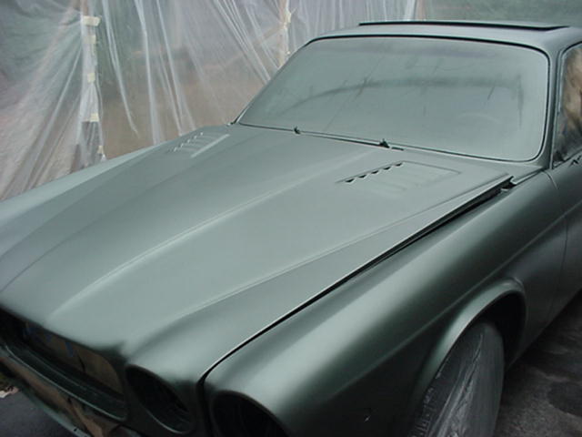

JagCad and LnrB
Both of these problems (efficient engine cooling and low engine speed e fan operation) were anticipated on my XJ6 when I added the V8 and the additional "cooling items" requirements, trans cooler, condenser. rad, e fans.
The Delco CS130 alt starts charging at low rpm and the louvers I installed, solves the engine compartment high heat temps at low vehicle speed (traffic jams on hot days) now there is a way for the trapped engine compartment heat to exit under those conditions.

LnrB, Thanks for vote of confidence Re: louvers-I think they add a bit of panache, as well as added functionality.
The louvers themselves are from a 1979 - 81 Camaro z28. DId a lot of searching and finally found these ,..knew they were just right fo this app. They are GM factory units with retaining brackets.
Yes I took advantage of the fact I was doing a bare metal respray and had the car down to metal ... all over.(wish I had deleted the side running lights and put something smaller in their place with LED lighting at the same time)
Louvers are functional as I tested them by attaching a bunch of wool tuffs to the hood behind the louver opening and going for a short drive.
Gives the car a bit of personality not too garrish and blend in -do not catch the eye and you only notice them after looking at the car for awhile.
