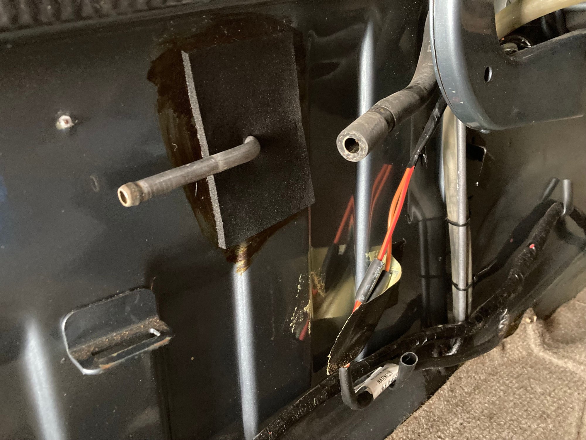

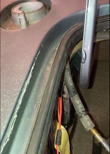

It was warm in NC today, so I decided to dig into it a little bit.
The vent from the tank is a fitting in the boot, on both sides... In this photo it's facing backwards, but it connects to the hose going towards the front of the car. That hose is the one that directly vents the tank, and goes to the fuel separator.
Blowing air into the tank, I could hear it coming out the filler cap. So I knew the line inside the tank was venting.
Blowing air into the hose going to the fuel separator made it blow out the filler cap. So I knew the fuel separator on that side wasn't clogged.
So, I disconnected the hose that goes from the separator, to the hard vent line... Blowing into the separator showed me that the line was clear from the feed and exit sides of the separator, so I knew the separator wasn't clogged.
So next was blowing air into the line that goes to the carbon canister. That revealed the the line itself is clogged or crushed somewhere...
I did repeat this on the RHS tank, with the same results. So the clogged or crushed line is probably forward of the place where those lines connect... Which would be somewhere in this area: (stock photo)
I did follow the lines from the rear of the car to the front, and nothing felt out of place... It is the smaller of the two lines under the car, on the RHS..
There are some connector hoses, so I could remove those to track it down further. But, not having a lift, and being a little short on time, I went for a temporary fix...
I'm sure this isn't recommended, but to keep me on the road for a little while, and to keep from imploding another tank, this is what I did:
I reconnected the hoses from the separator to the vent hoses towards the front. Then I capped the hose from the tank vent going to the separator. Doing that, the entire vent system is isolated from the tanks.
Finally I just ran a short hose from each of the pipes that vent the tanks, out the underside of the car.
I'm losing the ability to return any of the vaporized gas back to the tank... how much could it possibly be anyway? And I'm also venting directly to the atmosphere. I wouldn't want to do that as a permanent fix for sure.
But honestly, I'm planning to do away with the air pump and air rail on the engine. It just cleans up the engine bay a little... So the function of that brief recirculation of the fumes is something that will inevitably be lost.. And that would mean that I'm just losing the function of the charcoal canister by doing it this way.
This poor ole girl is gonna need a lot.. And the IRS will have to come out eventually.. Which will give me full access to all of those vapour lines..
So this isn't a recommended fix, but a bandaide that will keep it on the road and keep me from imploding another tank, while I knockout some of the other things going on with it...

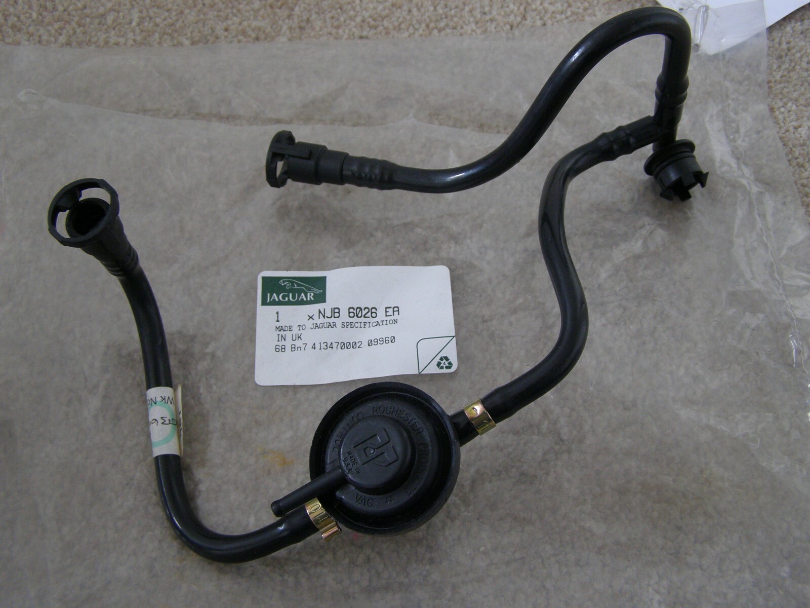

There will be a rochester valve in the system, or even two, and these get stuck. Worth finding it and fixing it.

can you find a picture of that rochester valve ??
Old Nov 6, 2023 | 08:07 AM
Greg in France's Avatar
Posts: 14,611
Likes: 10,809
From: France
How it works (not necessarily your location though):
https://jaguarvp.blogspot.com/2013/0...ief-valve.html
Basically, itallows fumes out once a tiny bit of pressure is in the tank, and when vac is applied (ie engine is running) allows air back into the tank.
A vac source connects to the spigot, on the XJS a take-off from the ECU vac line.
I am pretty sure there is one near or in the charcoal canister tubing. These two links show two different XJS setups, one more complicated than the other; but for sure yours will be pretty similar, if not identical. In the more complex system, there are all sorts of other valving as well. If you are allowed to, best to get rid of the entire lashup!

ok now I know what it is. Thanks. In my '84 XJ-6 it is located under the intake manifold, just hanging there by vacuum hoses.
