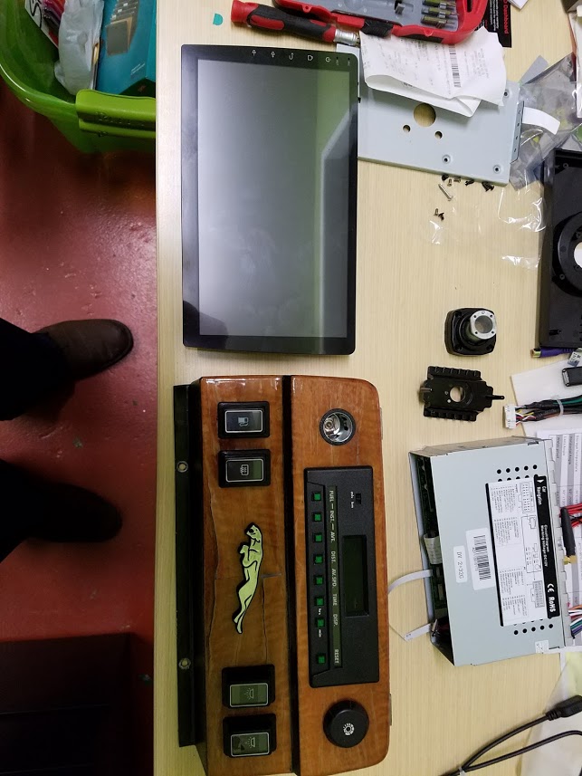

Starting to dry fit the new nav and audio unit. Android based Chinese e-bay special (I've fitted similar, double din units to two previous Porches and been very happy)
I need to make a custom bezel to replace the upper veneered part of the center console. I can't decide if I want to try and match the existing veneer, black plastic or brushed Aluminium.
The switch gear will be replaced by toggle switches in front of the radio head unit.

Excellent idea! Which unit is that?

Its a hizpo 10.1" display single DIN. I won't fit as shipped but disassembling gives a separate single DIN body with long enough leads to route up to the display.
Mounts for the screen will have to be custom but should be straight forward.
