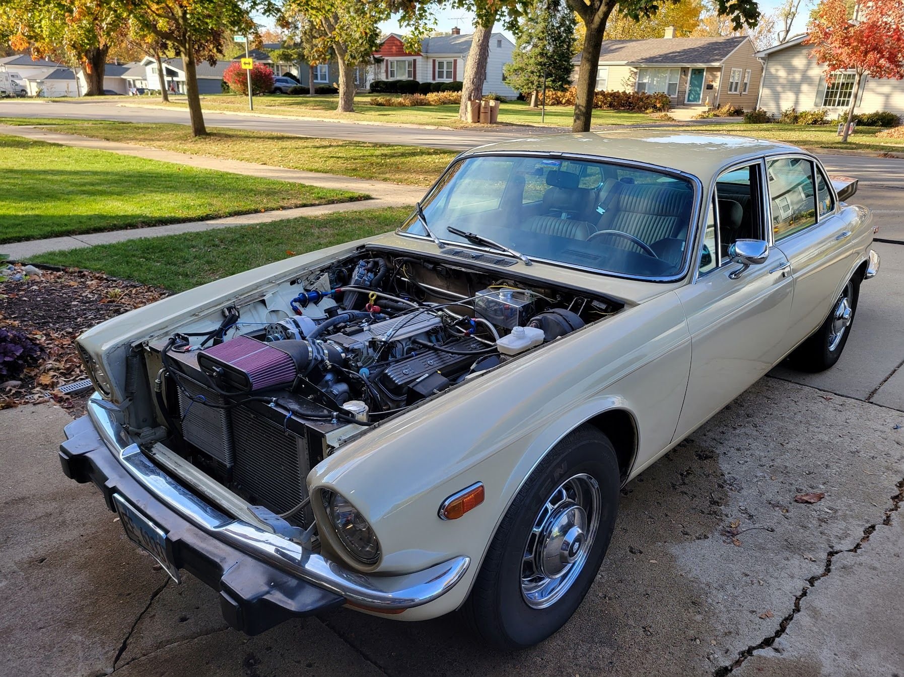

Last weekend I listed the Jaguar on eBay for what I thought was a fair price. I wasn't expecting the reserve to be met and when the auction ended today and she didn't sell - I was actually pretty relieved.
So this afternoon I pulled the hood off so I can start on my Winter 2024/2025 list. There are a few tweaks I want to make like going to a coil-on-plug ignition system and a better exhaust system. I also want to pull the spacers out of the front springs to level the front down. And some other surprises along the way.

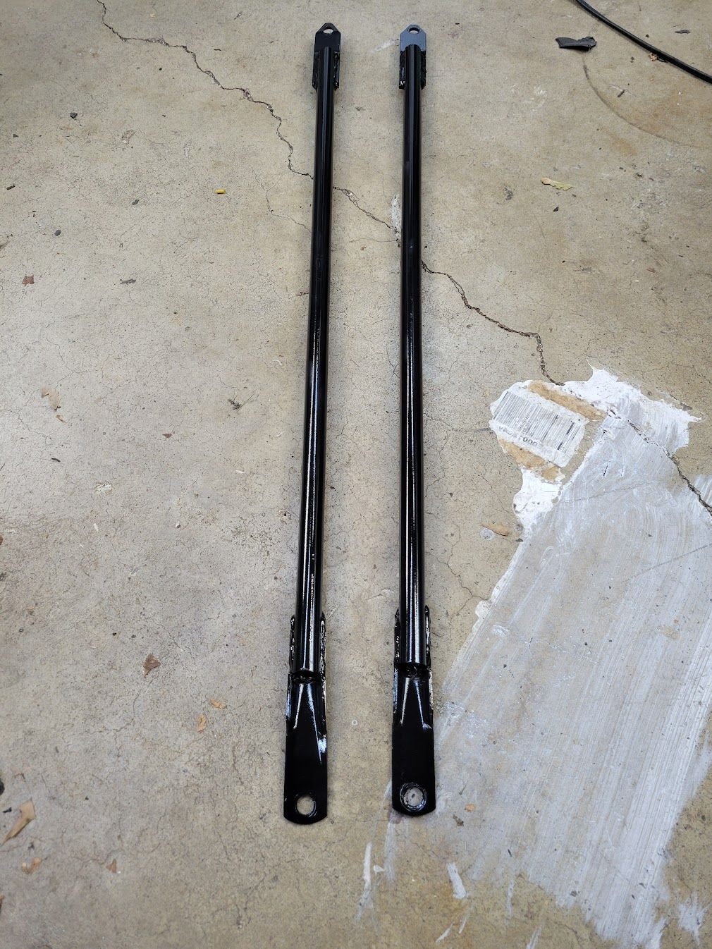

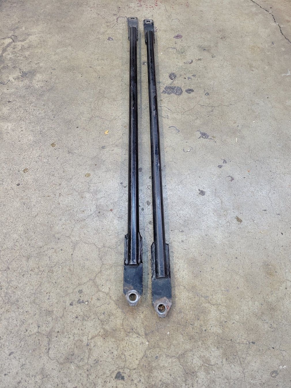

Time to start digging in. I pulled the fender braces off last night - they're the first thing that comes off. They looked a little ratty.
After a trip through the sand blaster and some 2k chassis paint, they looked much better.

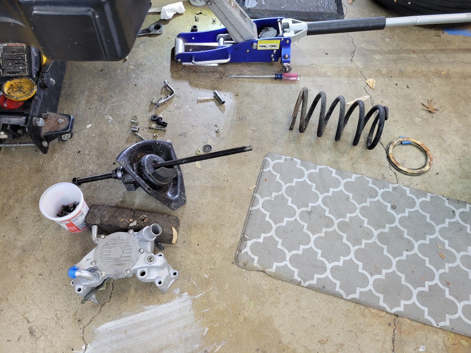

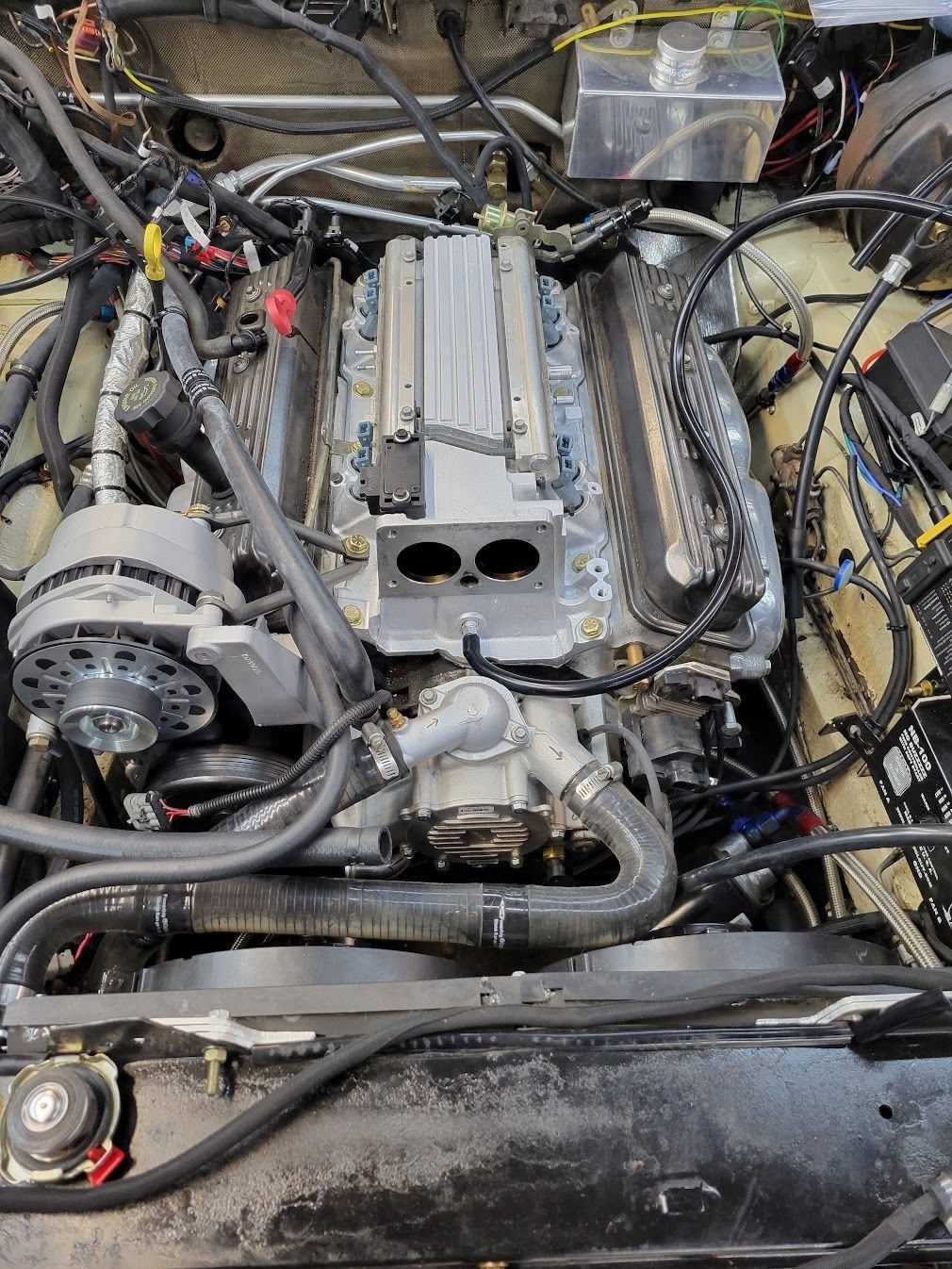

I started working through the Winter 2024-2025 list this week. First up was removing the intake manifold so I could re-seal it to address the oil weeping at the back of the block. While I had the manifold off I took advantage of the opportunity to clean it up and replace all the PCV hoses that might have been original to 1996.

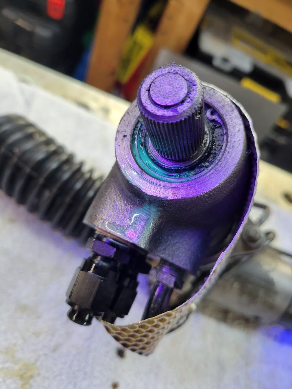

I've been patiently dealing with an oil drop from the steering rack all summer. The UV dye tells no lies, the input shaft seal was a leaker. I'm going to spend some time with the McMaster Carr catalog and see if I can find something that works better.

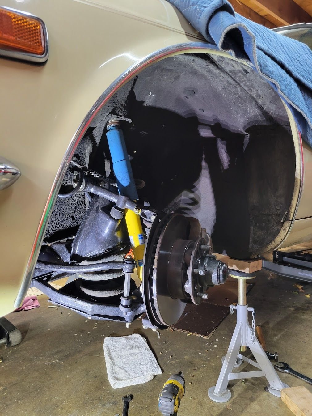

Next up was correcting the slighty-too-high ride height in the front. Once you've done it dropping the front springs are pretty easy. I'll be removing the packing shims in the front and seeing where things end up.

You will have NO problem with that shaft seal!
I changed mine, sweating blood all the time from all the Horror Stories about this little task, but with care and paying attention to the splines, all went well and nary a drop of steering blood has been lost since I did it.

First was the input shaft seal on the steering rack. I thought I could use a rotary shaft seal as a better solution than the Jaguar parts, but the 1.375" OD seal was too big and the the 1.25" OD seal was too small. I guess I'll order the correct kit and be done.
The win was getting the driver side spring, minus the packing shims, back in the car tonight. I had a great idea for a tool to make this even easier - more to come on that later.

Short night in the garage as I'm still waiting on parts to arrive and I broke my favorite wrench. I was able to remove the front right coil spring so I can pull the packing shims from that side.

Next up was putting the front passenger coil spring back in place.
This is my new secret weapon This is my new secret weapon
, a 10" long 9/16" socket. I use four pieces of Grade 5, 12" long, 3/8" all thread rod to hold the spring and pan in place, compress the spring with a floor jack until the car lifts off the jack stands, then use the 10" socket to easily finish compressing the spring. I think it took about 30 minutes from start to finish. The long socket was much easier to use than a ratcheting box end wrench.

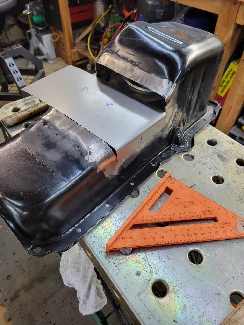

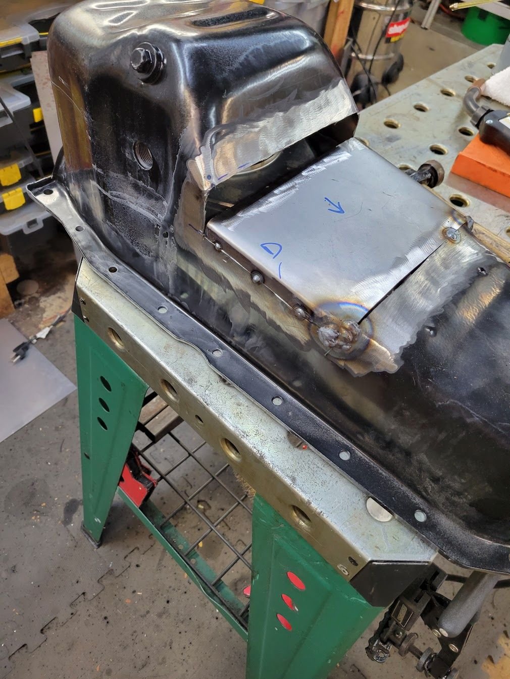

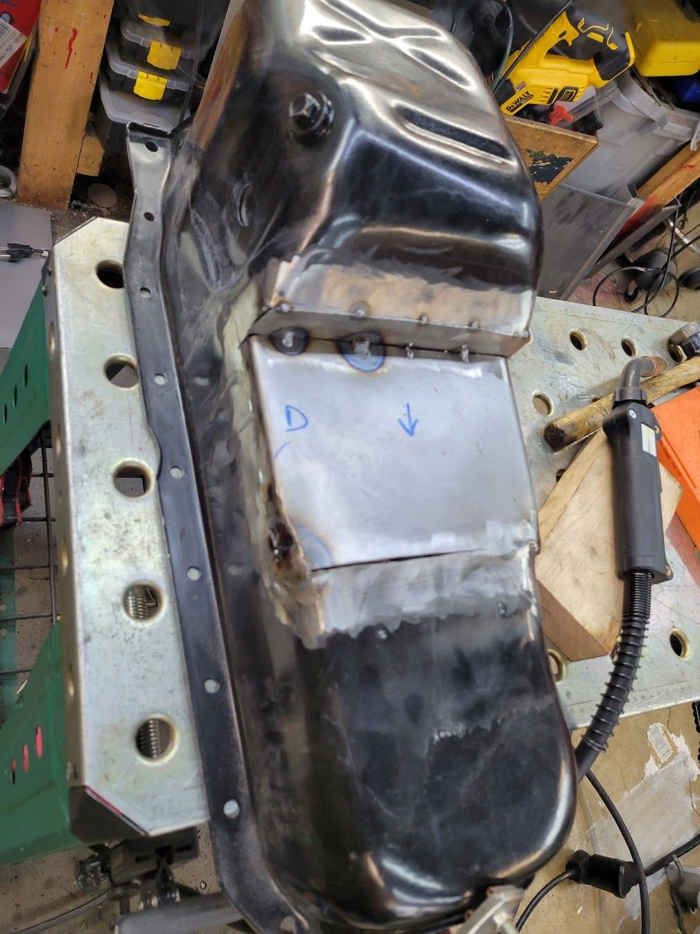

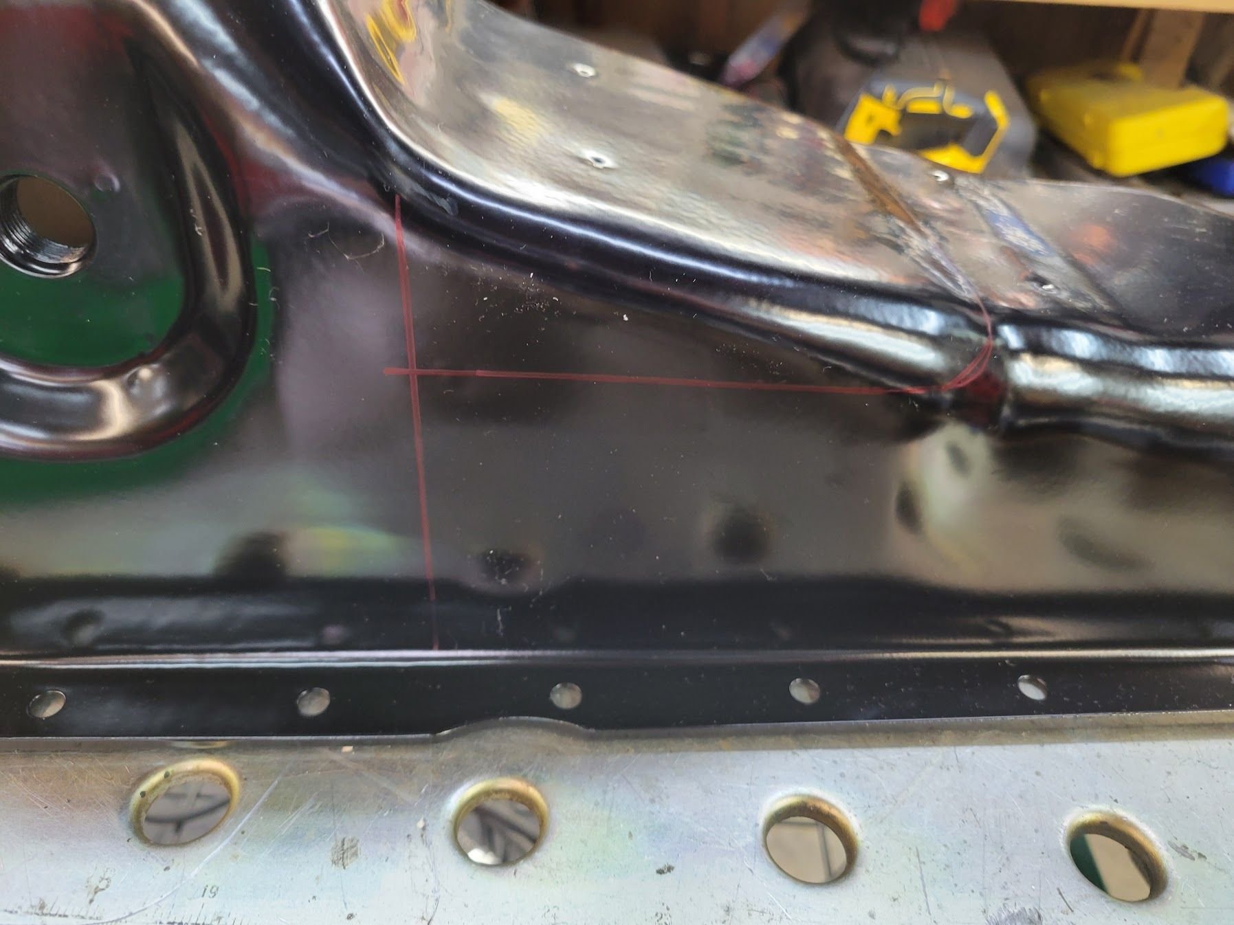

Next it was time for some good old fabrication. The Chevy oil pan is pretty close to the steering rack in the car, and once the motor mounts settled a bit the clearance went from passable to uncomfortable. The two weren't touching but I wanted to address it. The nice thing about having the ubiquitous Chevy engine is that parts are abundant and cheap, so I picked up a brand new oil pan.
After measuring where the steering rack fits in relation to the oil pan, I marked my cut lines.
After cutting the pan, I made a new patch using some sheet metal.
Tack welded in place.
Final piece cut and tacked.
There are no changes to the clearance to the rotating assembly.
I exhausted all the batteries for my grinder. Tomorrow I'll finish grinding, use a light to check for any pin holes, fix those, then fill it with water to see if it leaks.
