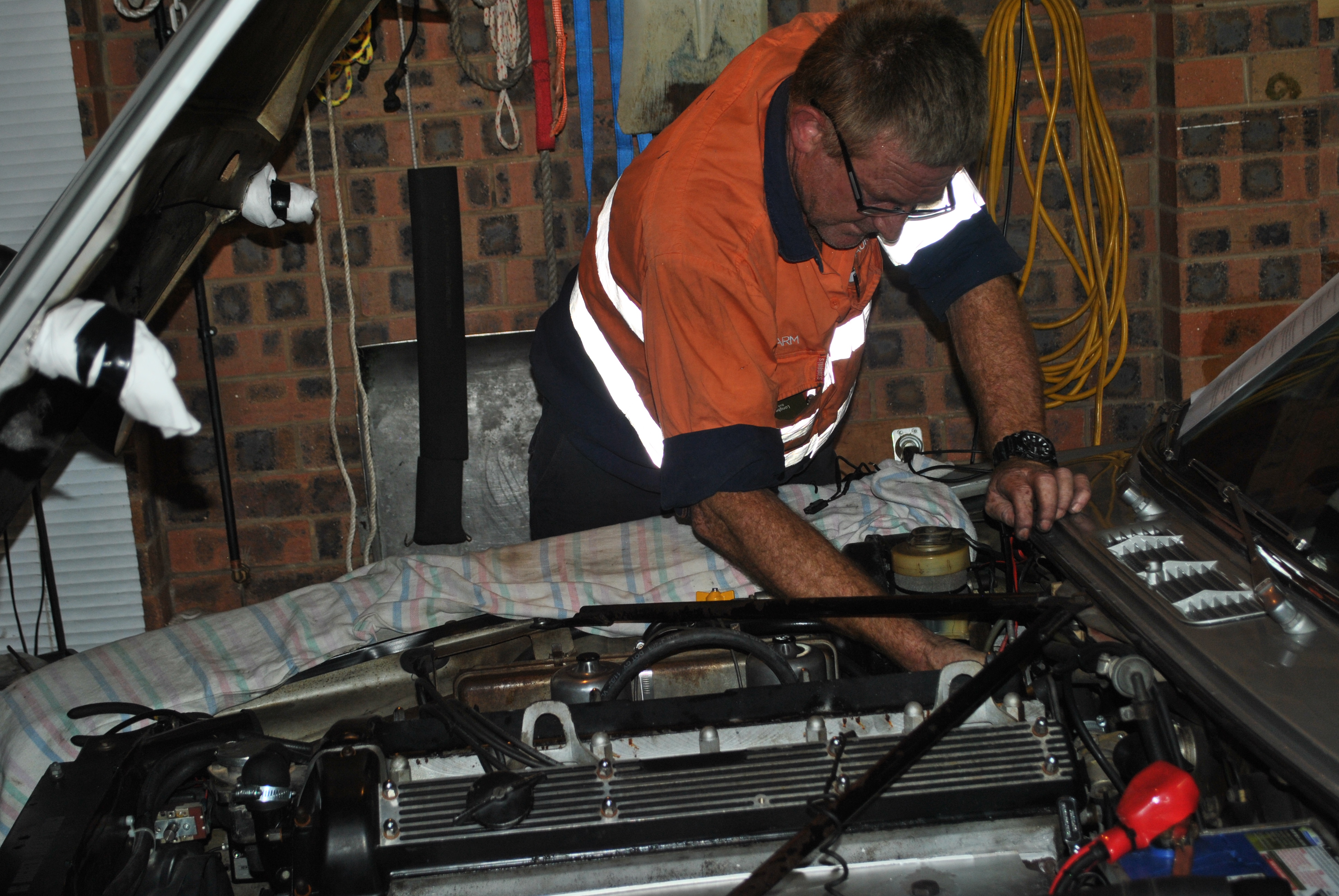

The good Dr Phill(my mechanic mate) had a day off today and new time was pressing for the forum run this weekend,decided he would come over today and sort fireball while I was at work.
But the parts didn't arrive, so he removed the old dizzy and drank some beer, then sorted wiring from Grant's word doc, then drank some more beer.
He also sorted a couple of niggling issues while here.
Hope the new dizzy arrives tomorrow. it was shipped Monday overnight? Christmas rush,they are blaming.
The official diagnosis was "this thing is shagged", but we new that.

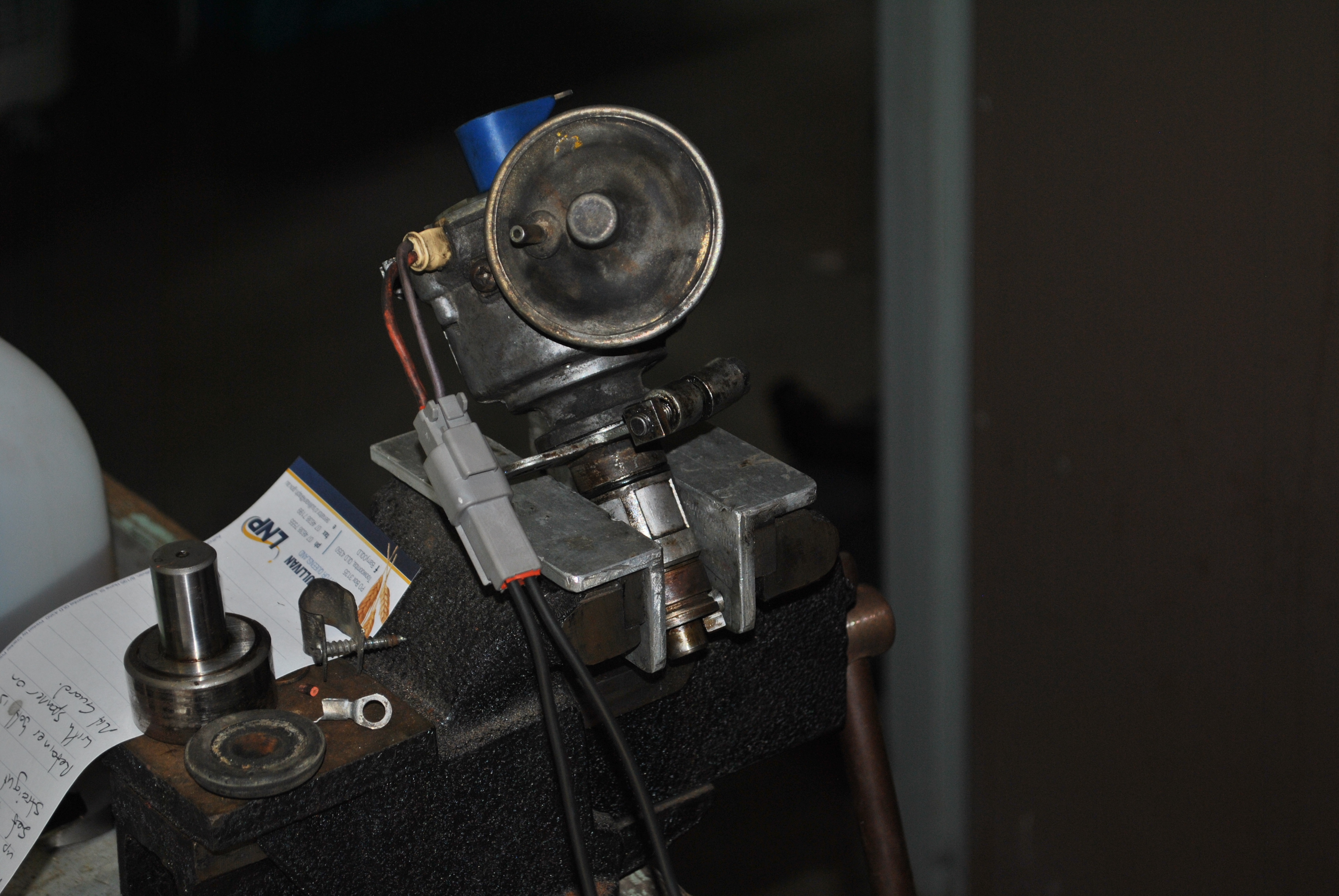

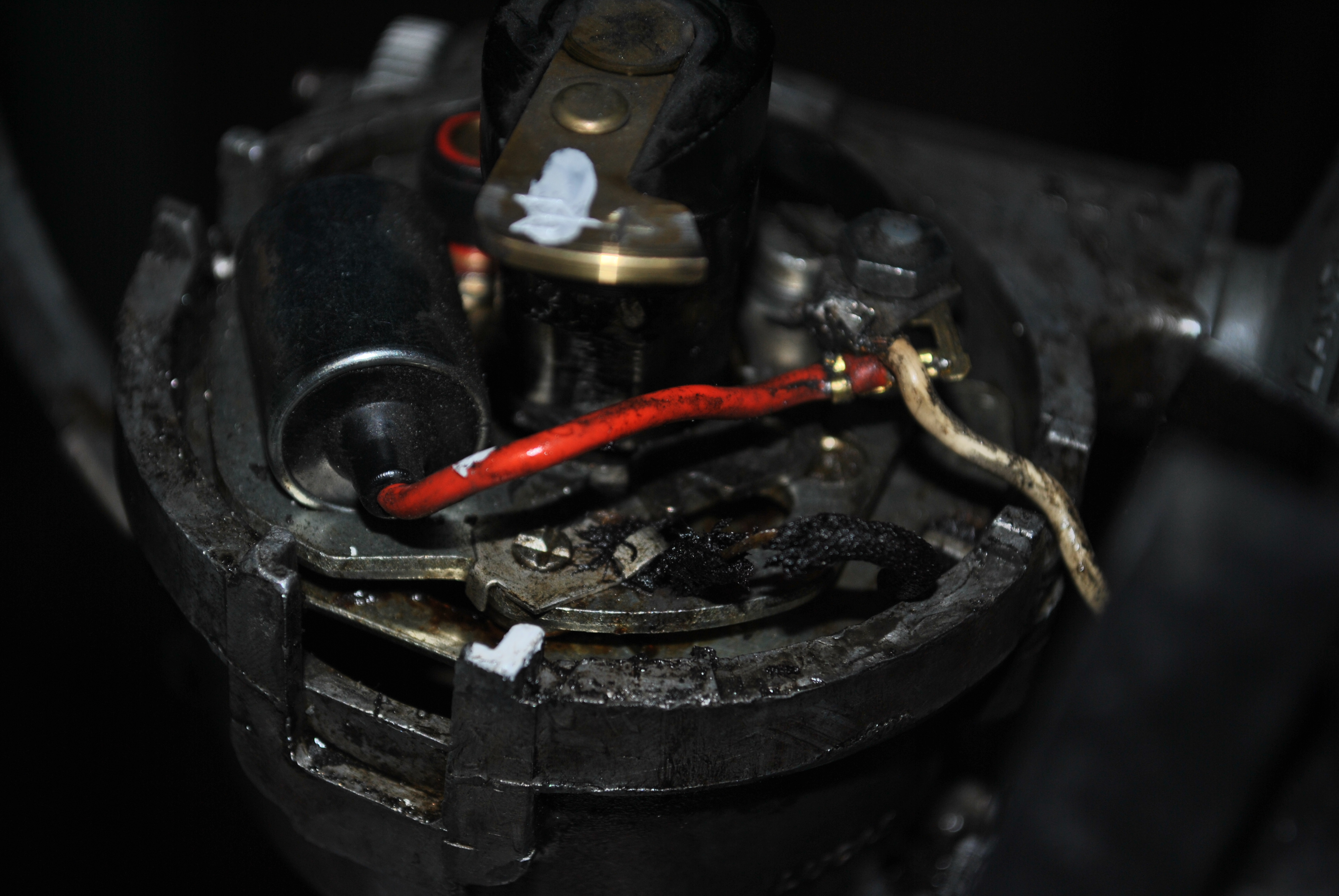

Backfiring through carby's.-dsc_4780.jpgBackfiring through carby's.-dsc_4781.jpgBackfiring through carby's.-dsc_4782.jpg

New dizzy arrived yesterday, all fitted up but no go!
Thanks for the phone calls last night Grant, we will go over everything again this arvo to make sure we haven't missed something.
Conversation is all clear now black box is open. Going to pick up a spare bent boomerang (as you call it) just in case we need it, can return if not required.

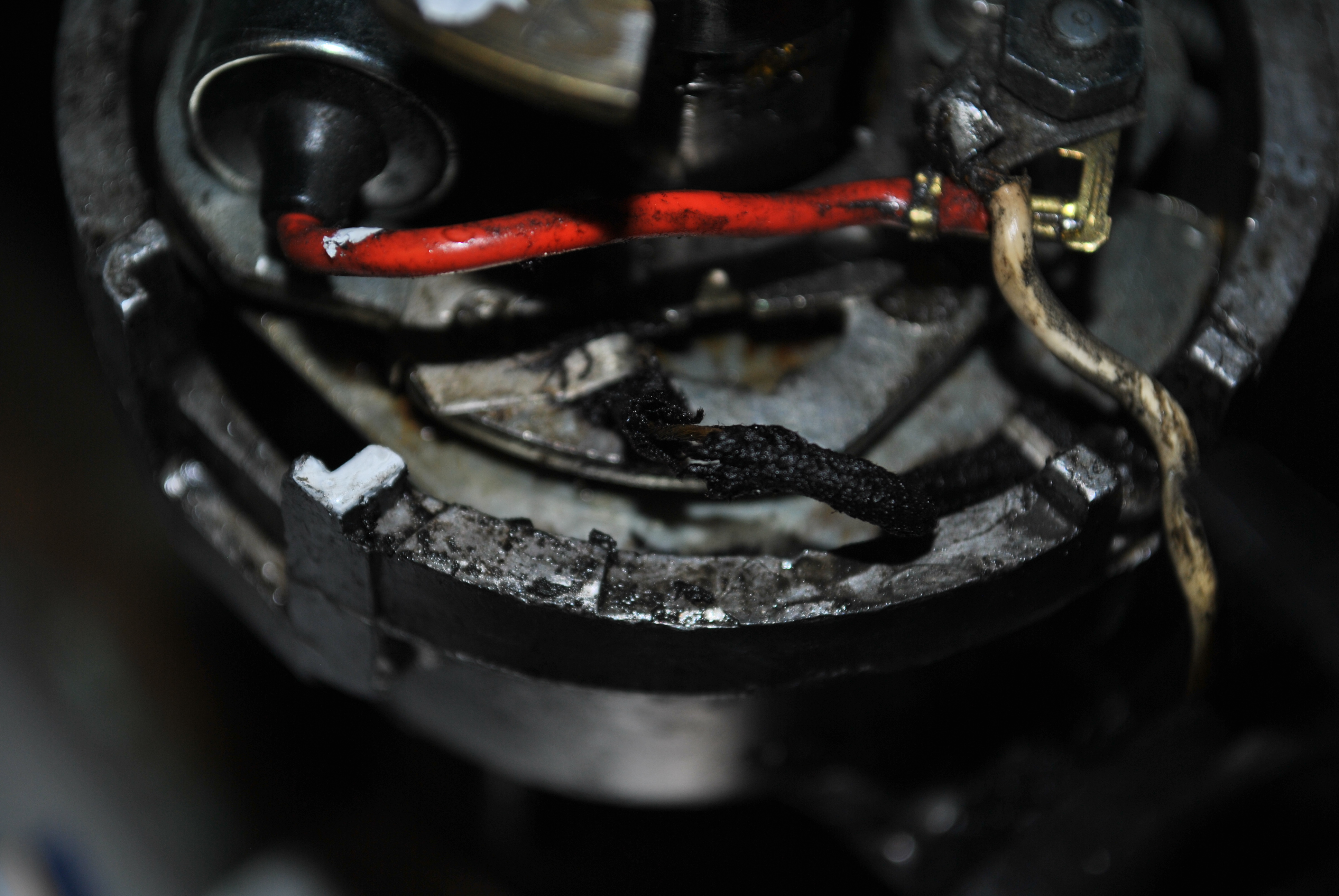

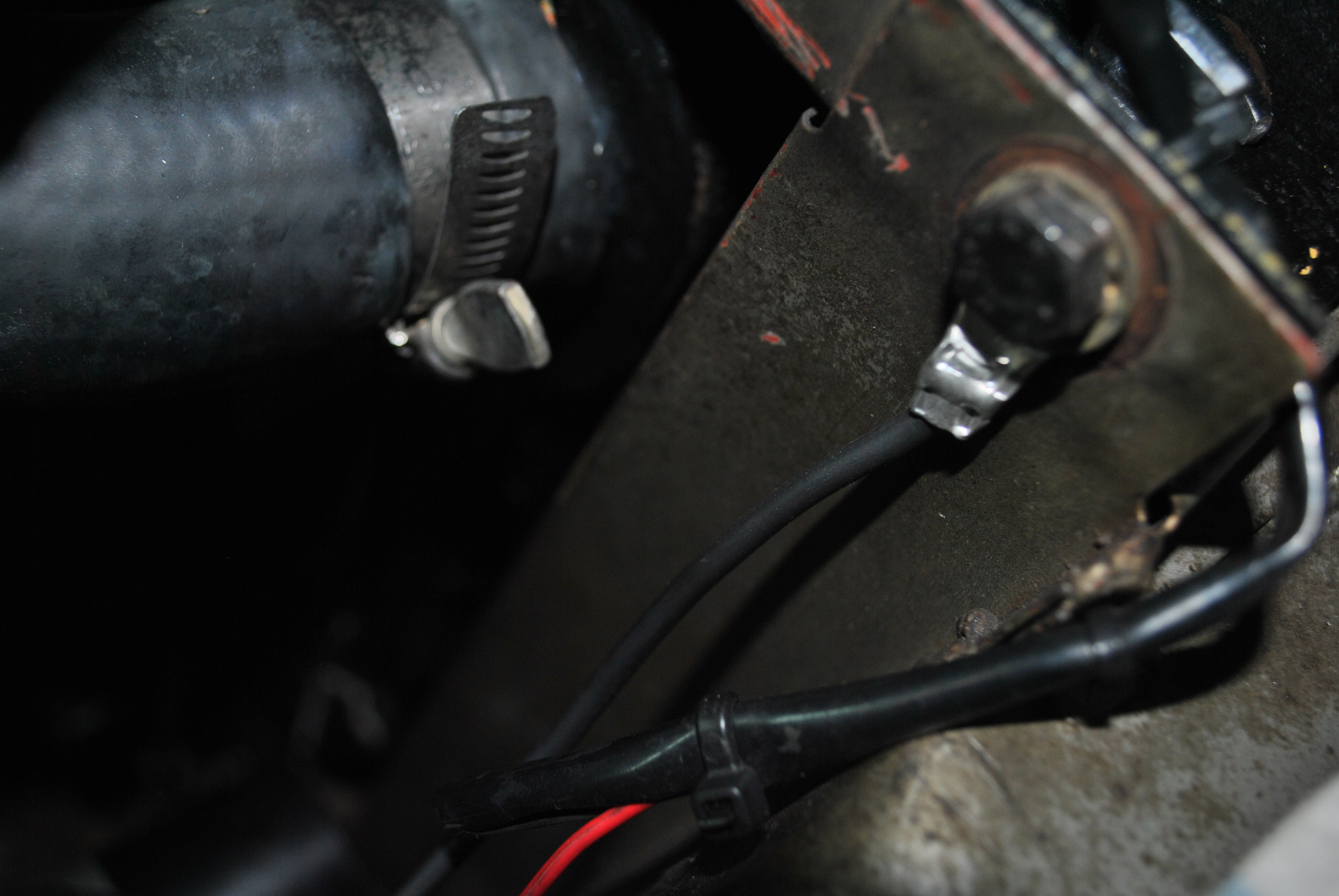

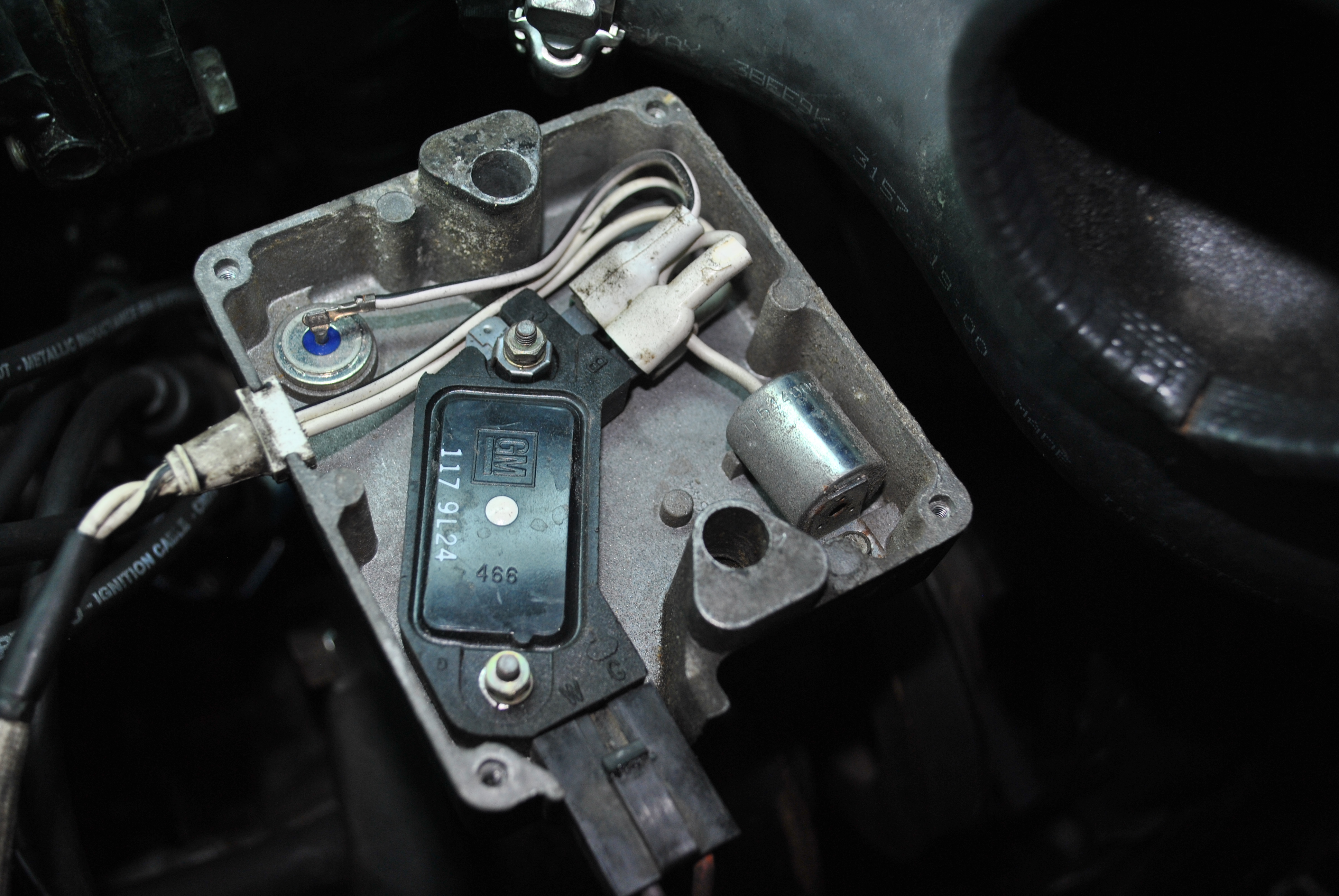

Backfiring through carby's.-dsc_4797.jpgBackfiring through carby's.-dsc_4798.jpgBackfiring through carby's.-dsc_4799.jpg

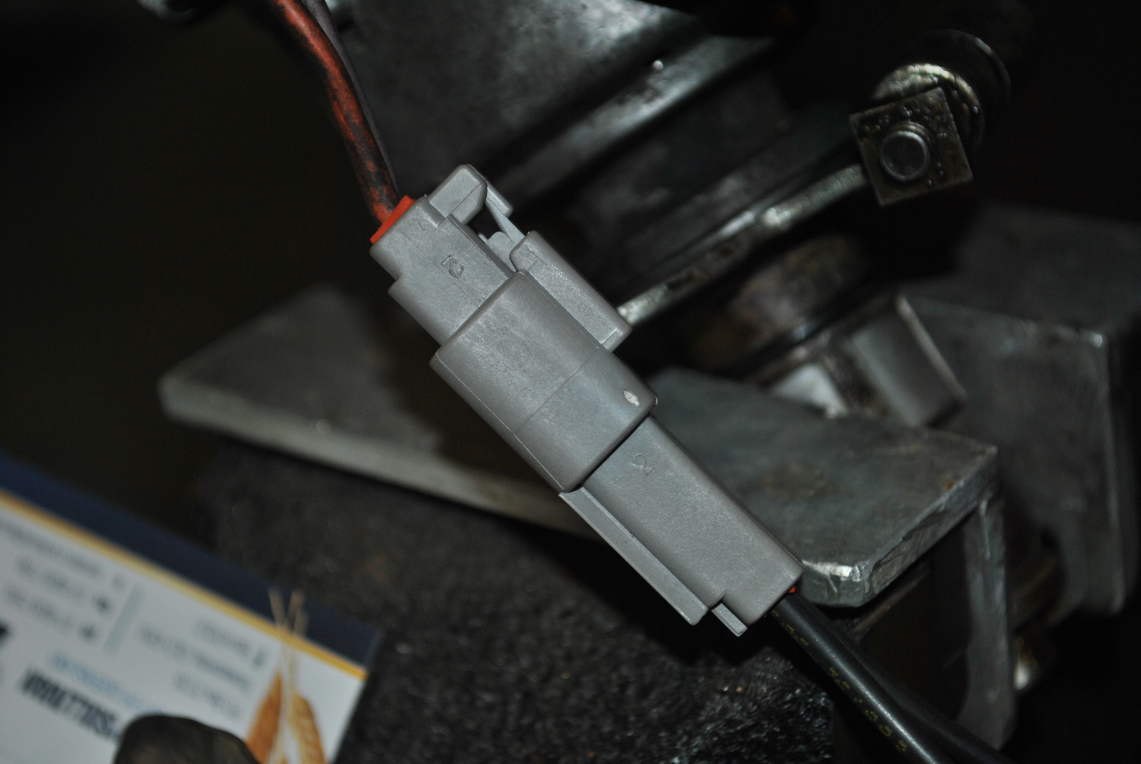

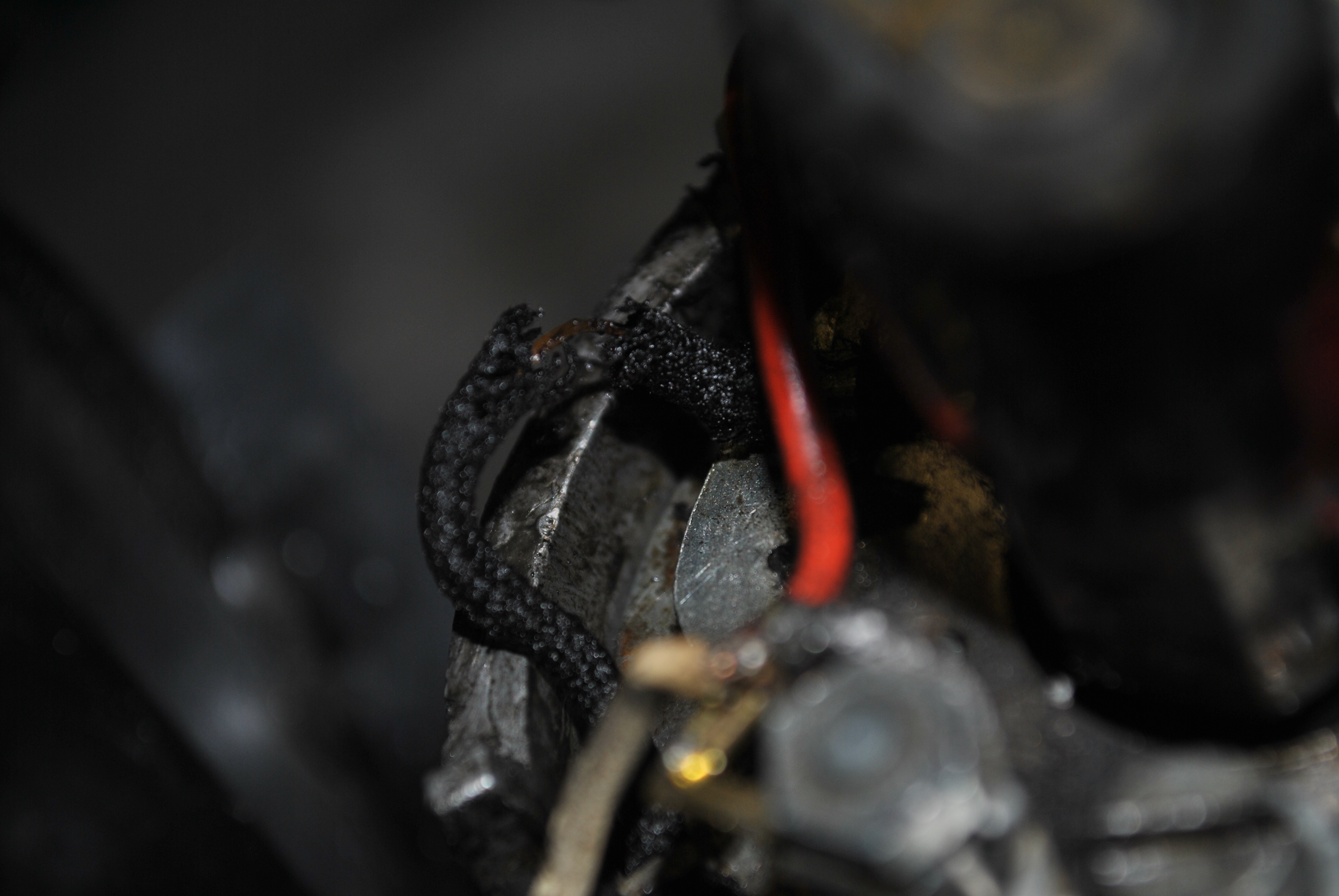

Default Sorted

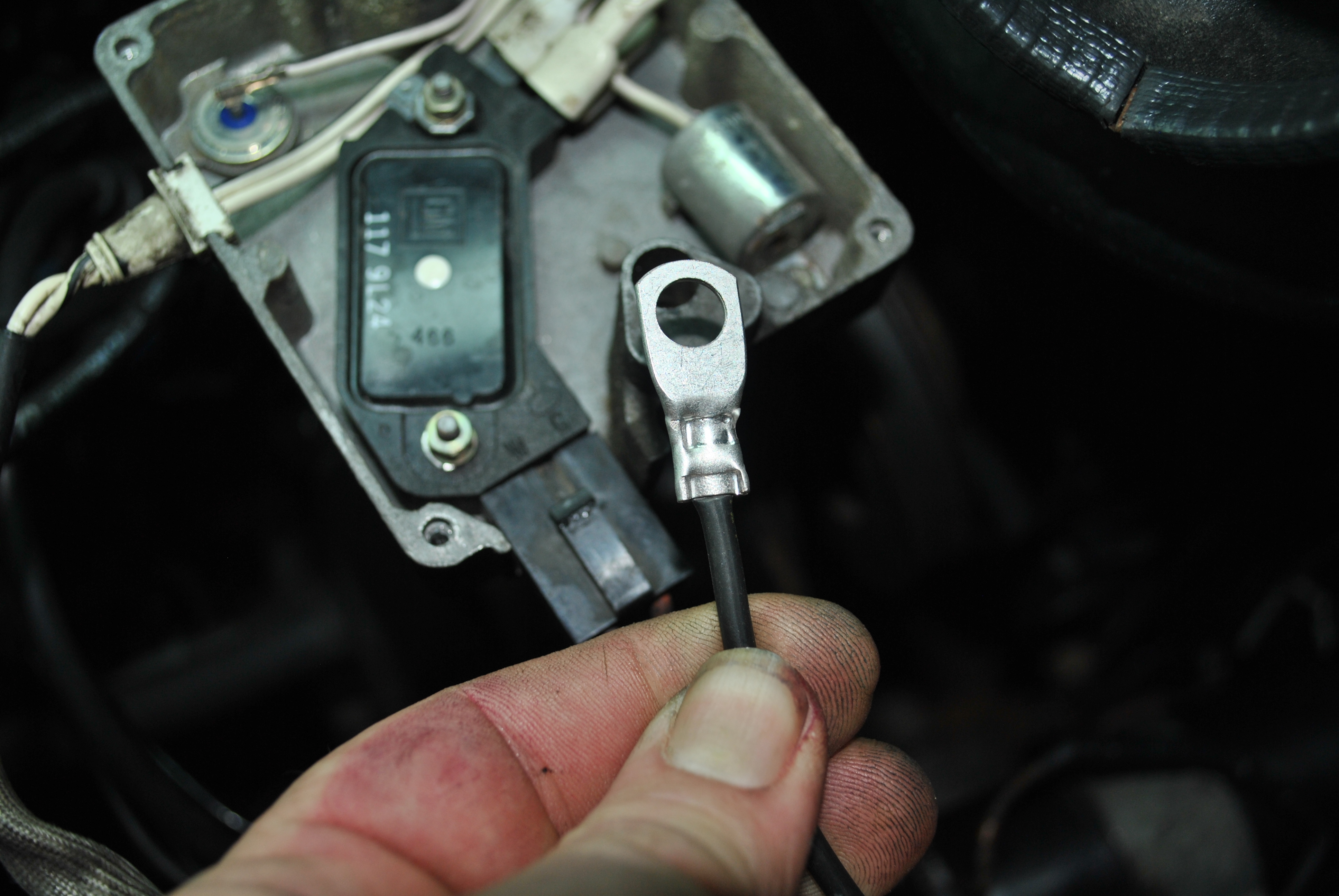

We found a wiring issue, from using my cheap connectors and crimping tool.
Phill made up a new harness with waterproof connectors from his kit and she fired up instantly with a near perfect idle.
