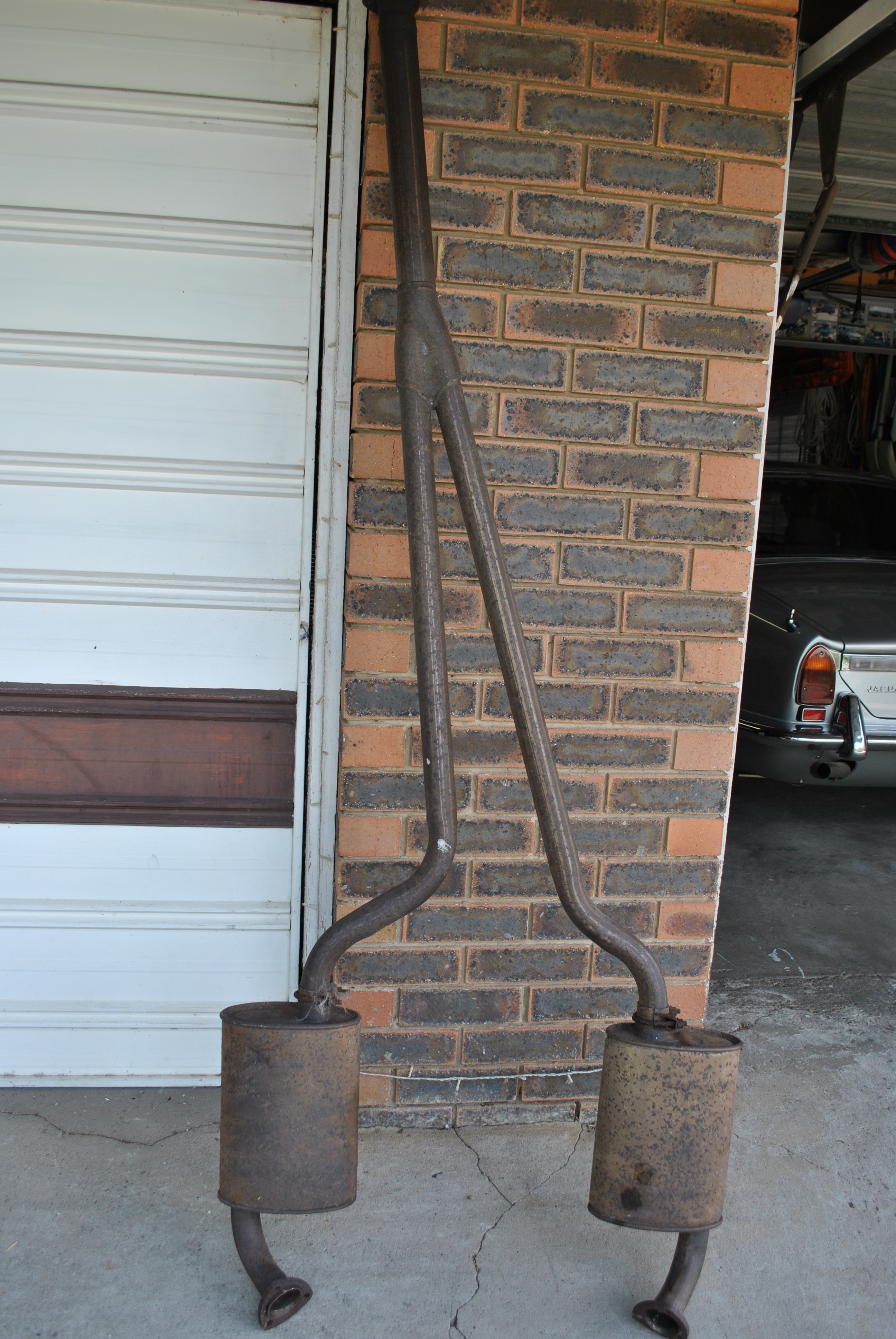

This saga just keeps going, since the back firing I have had a small exhaust leak I thought might be a loose joint. Further investigation today and I have split one of the front mufflers and unrolled the seem.
So off to the exhaust shop Thursday for a pair of stainless jobs. He is going to give it a slightly sportier tone without making it noisy. As he says,just a nice balanced sound.
turns out the XJ6 we got the free parts from has a stainless system begging for a second life so off to pick that up sometime this week if the work schedule allows.
Old Dec 13, 2015 | 06:55 PM
  #51
Daf11e's Avatar
Posts: 45,885
Likes: 4,706
Attachment 122824
How good is that!

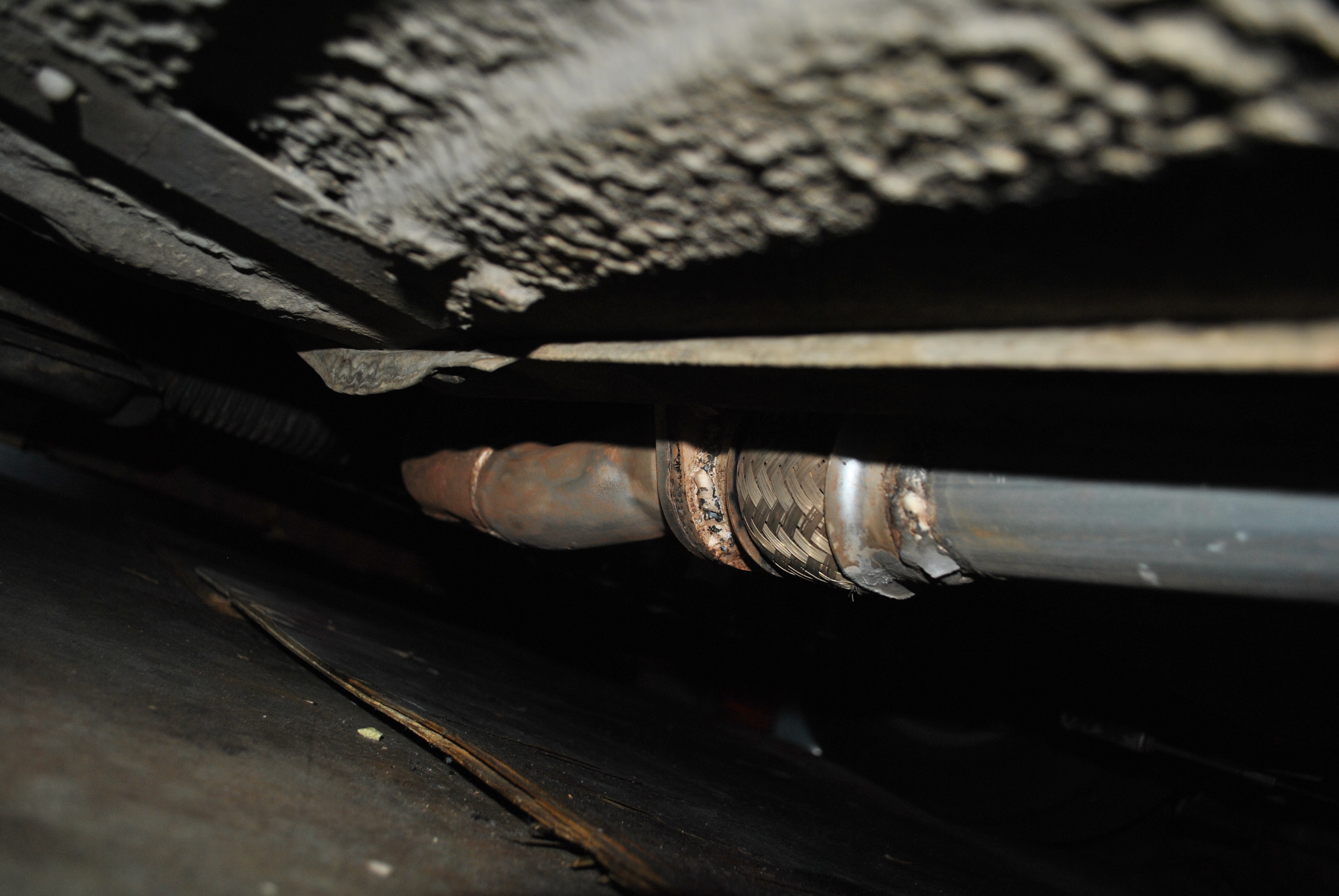

Finally got the new to me exhaust system fitted up today(scored the car back off the "P" plater for a day), my exhaust guy cut and welded to make one great system out of both. The over axle pipes now have 3 bolt flanges instead of slip on joints at both ends making removal a lot easier. Not Prtty but very functional.
The car is so quiet now her indoors didn't hear me come home and drive in and out the garage three times making sure it passed the scape test on my hill. Nearly there with the scraping problem, rear springs and the right profile tyres on the front should finish the job.
All for $205, which I know was cheap as the mechanics wife told me how much trouble he had to go to manipulating the pipes into shape and lift them as high as possible.(he knows my drive and makes sure is work suits it) Off to buy him a carton of Crown Lager first thing tomorrow for the service.
