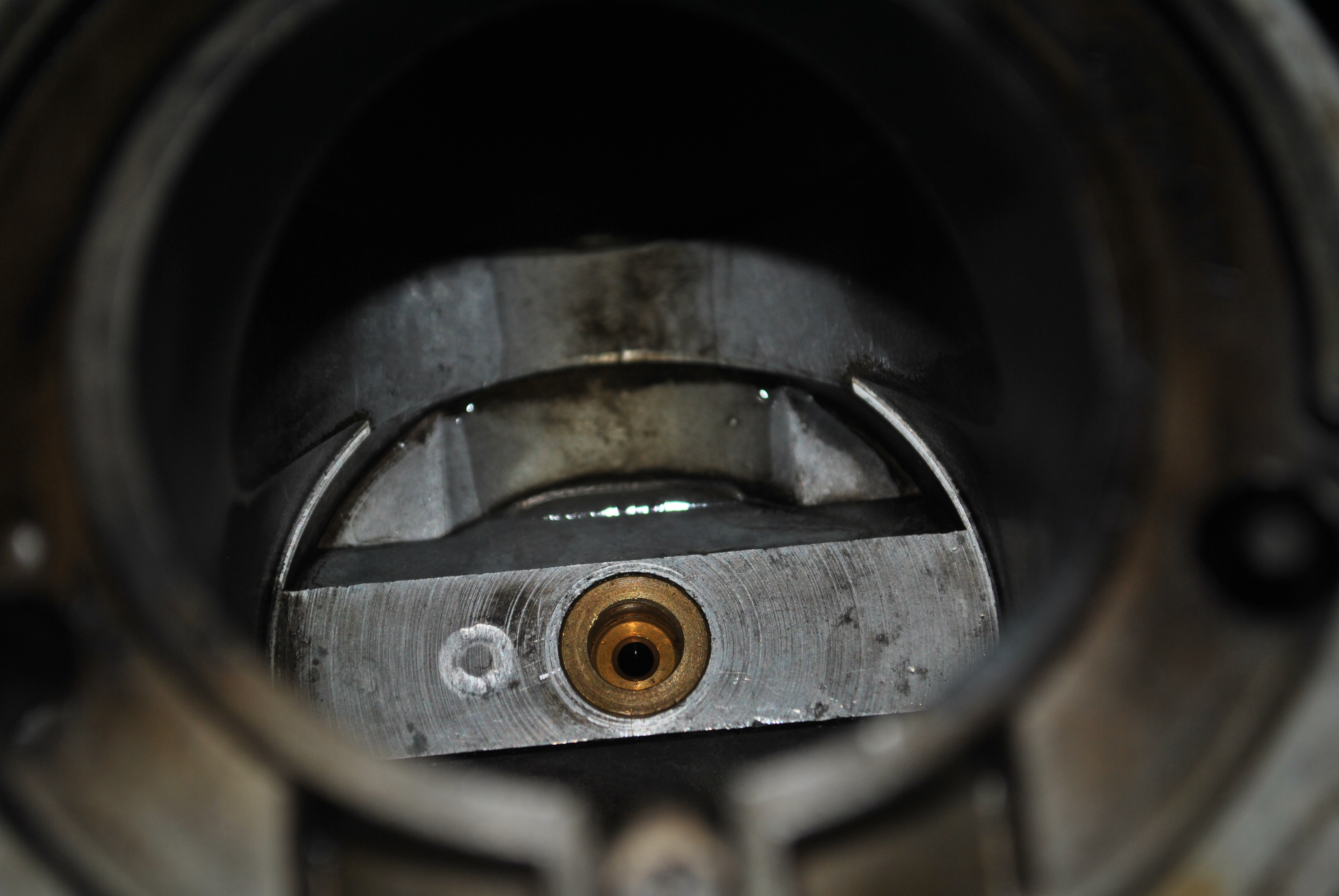

In surgery again.
Still got home and up the drive under her own steam!
When I left work this afternoon I detected a hint of a misfire at low revs but once driving all was good, same at the next two sets of lights.
On the freeway doing about 65 mph all seemed good until the last hill before my exit then it started breaking down and back firing then at the top of the hill the engine cut out, so I threw it in N and put on the hazard lights and coasted to my exit about 800 meters down the slope and pulled over on the grass on the of ramp.
Fired her up again and a bit of a cough and splutter and on my way again until the up hill on my street where the misfire and back fire returned,pulled up at my place and positioned the car in the middle of the road(as in across both direction lanes) and took a run up to get up the drive.
To me that is getting home still running so hasn't let me down yet!
First job was to pull the plugs.
3/2/1
6/5/4
Do 1/2/3 look lean?...that was my thought.
So I pulled the carby's down for a check and clean. Cleaned the plugs and put it all together.
Backfiring through carby's.-dsc_5246.jpgBackfiring through carby's.-dsc_5247.jpgBackfiring through carby's.-dsc_5248.jpgBackfiring through carby's.-dsc_5250.jpgBackfiring through carby's.-dsc_5251.jpgBackfiring through carby's.-dsc_5252.jpgBackfiring through carby's.-dsc_5254.jpg
Started up , still a hint of a misfire but no backfire. But roadtesting has to wait until sun up as it was after beer o'clock when I got home.
Off to cook chicken and bacon on the bbq now,in the rain. That's Qld for you. Fine all day then rains when you want to go outside.
Any thoughts from you? If it plays up road testing I will check mixture tomorrow.

Clarke, only one of your 6 plugs looks even close to normal, and that's #4. Even it looks leaner than I like, but the rest are Definitely too lean!
Just a thought, but those carbs look like SUs (original equipment on the Datsun SPL-311 I had). If they are, you could have worn throttle shafts that are allowing air into the manifold After the mixture is set by the metering rods (taper needle).
If this is the case, all the cleaning in the world won't fix the problem. You might have to richen up the fuel mix to overcome the air leak around the worn shafts.
Elinor, I knew the cleaning would do little to help. But richening the mixture today made big difference. Short road test today indicated good results but a trip to work on Wednesday will tell for sure.

I'm assuming you rebalanced the carbs at the same time as enrichening the mixture.
If the throttle spindle is leaking you may well get away with fitting new spindles. Worth a try, if not then you will have to rebush them. Replacement of Spindles and Spindle Bushes - SU Carburetters
Parts for AUD 279 for MG M.G.B 1798cc - SU Carburetters - SU Carburetters sell a spindle kit but don't say or show what it includes!!!

Yes they have been washed, probably more often now they get used on the jag than when I was living in a rented house with 5 guys in the 80's
Yes, rebalanced at the same time.
Drove to work last night, all seems to be sweet for now.
