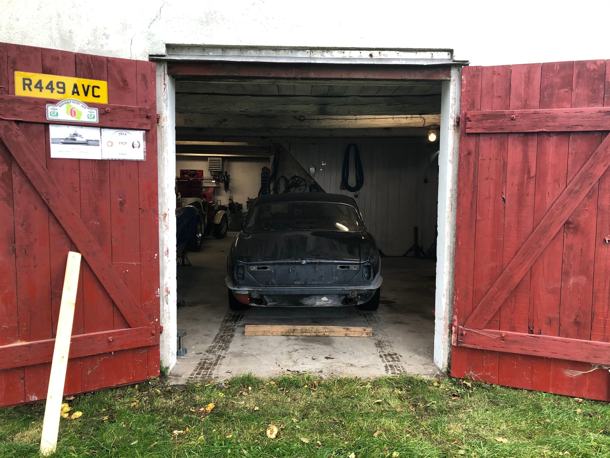

I went back to the island and saw it first. A 1977 Series 2 4.2L with engine work done like 20K kms ago. Color im not sure about : its says OPEL 168B on a respray sticker .

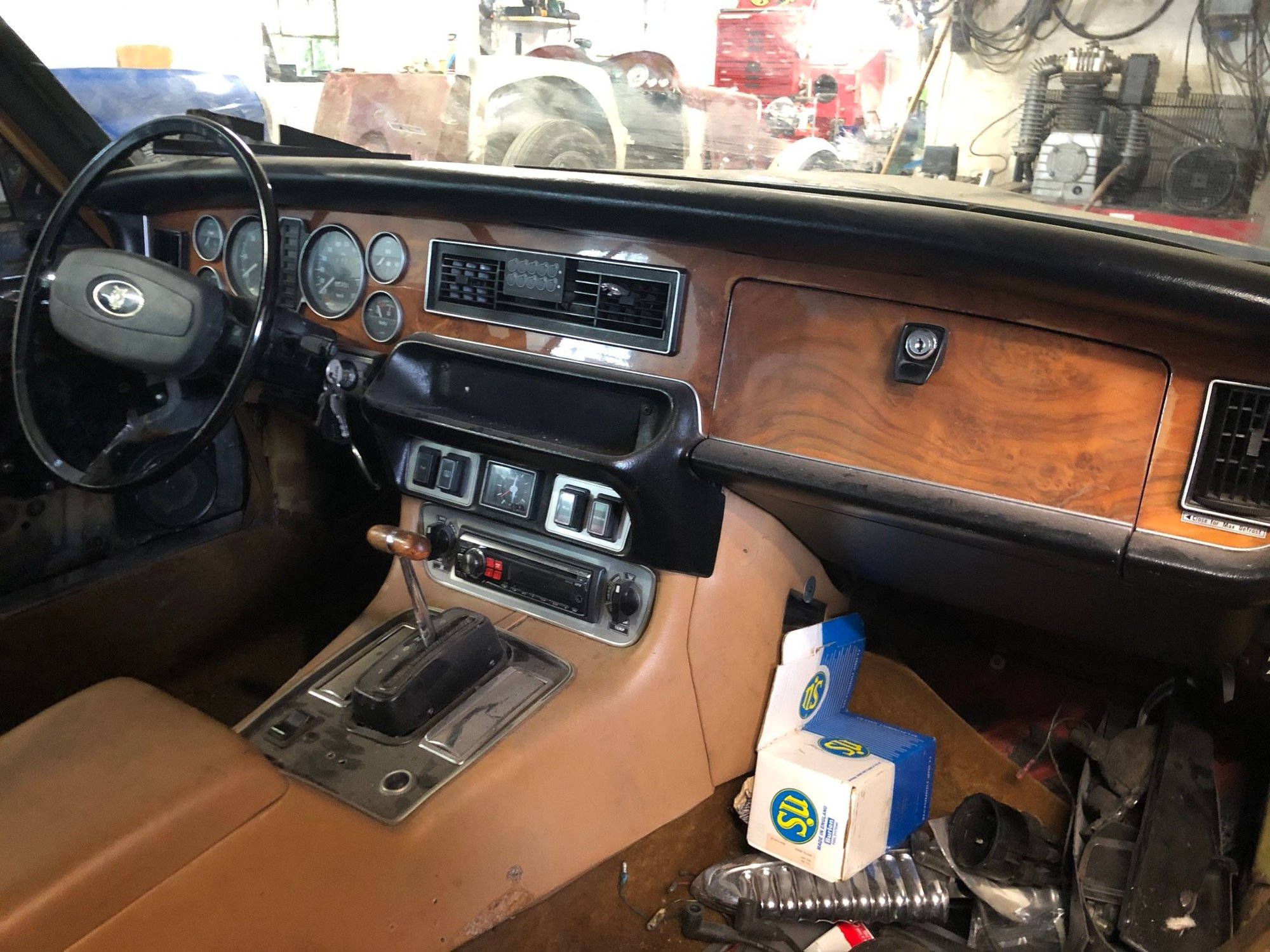

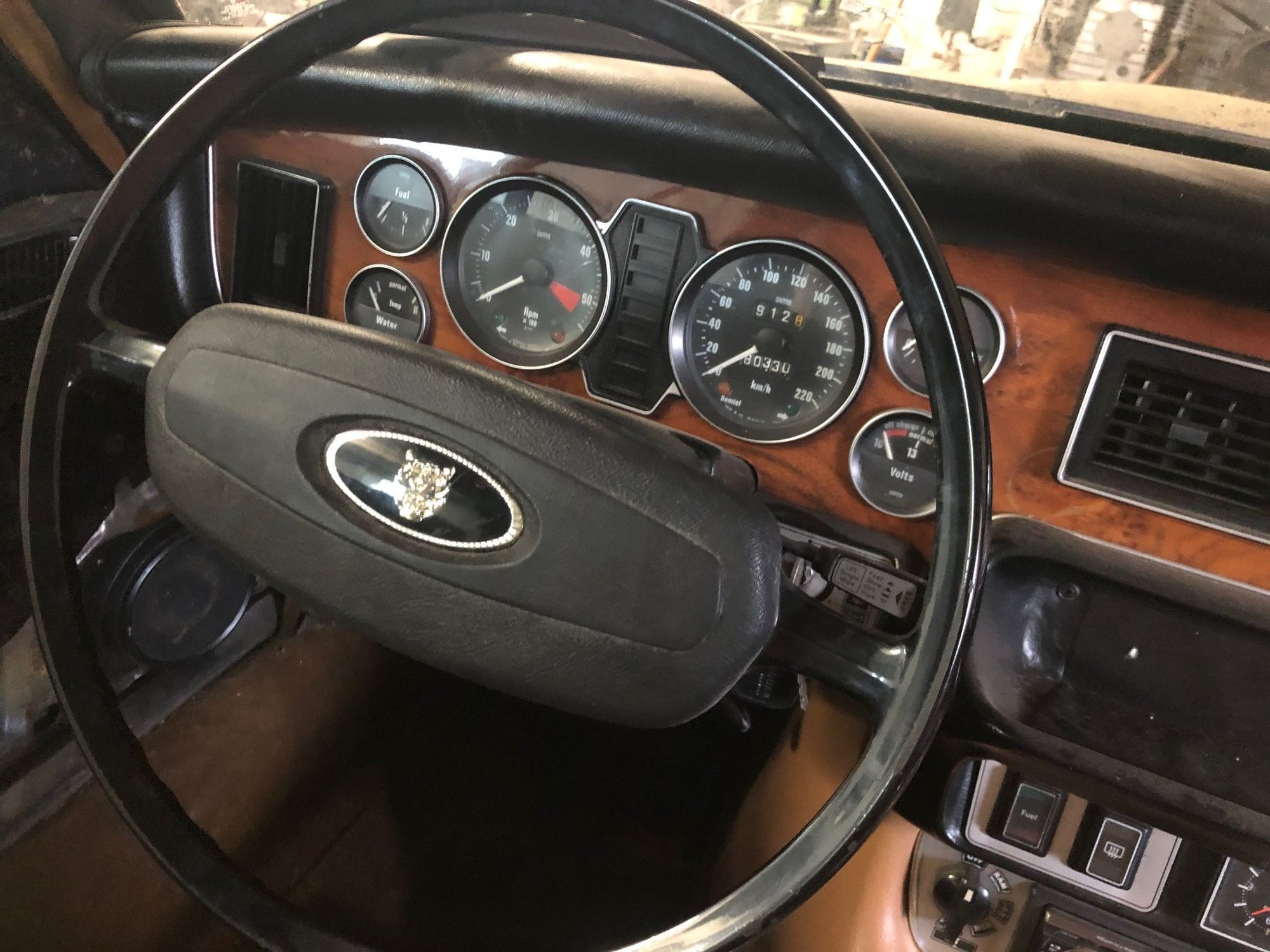

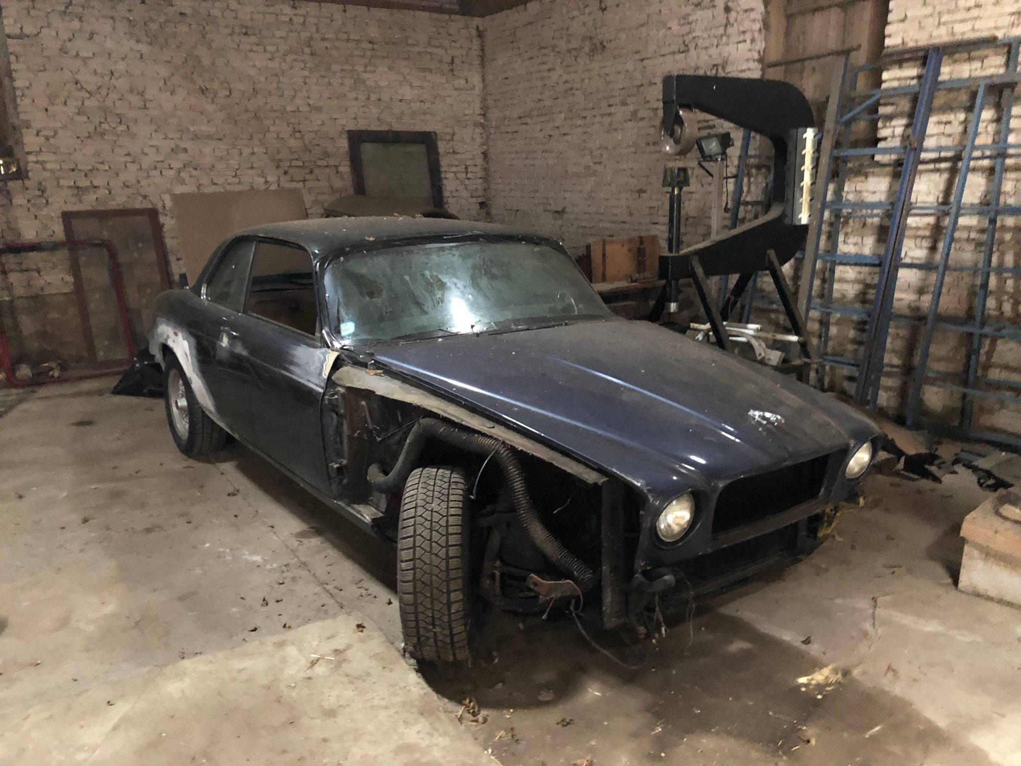

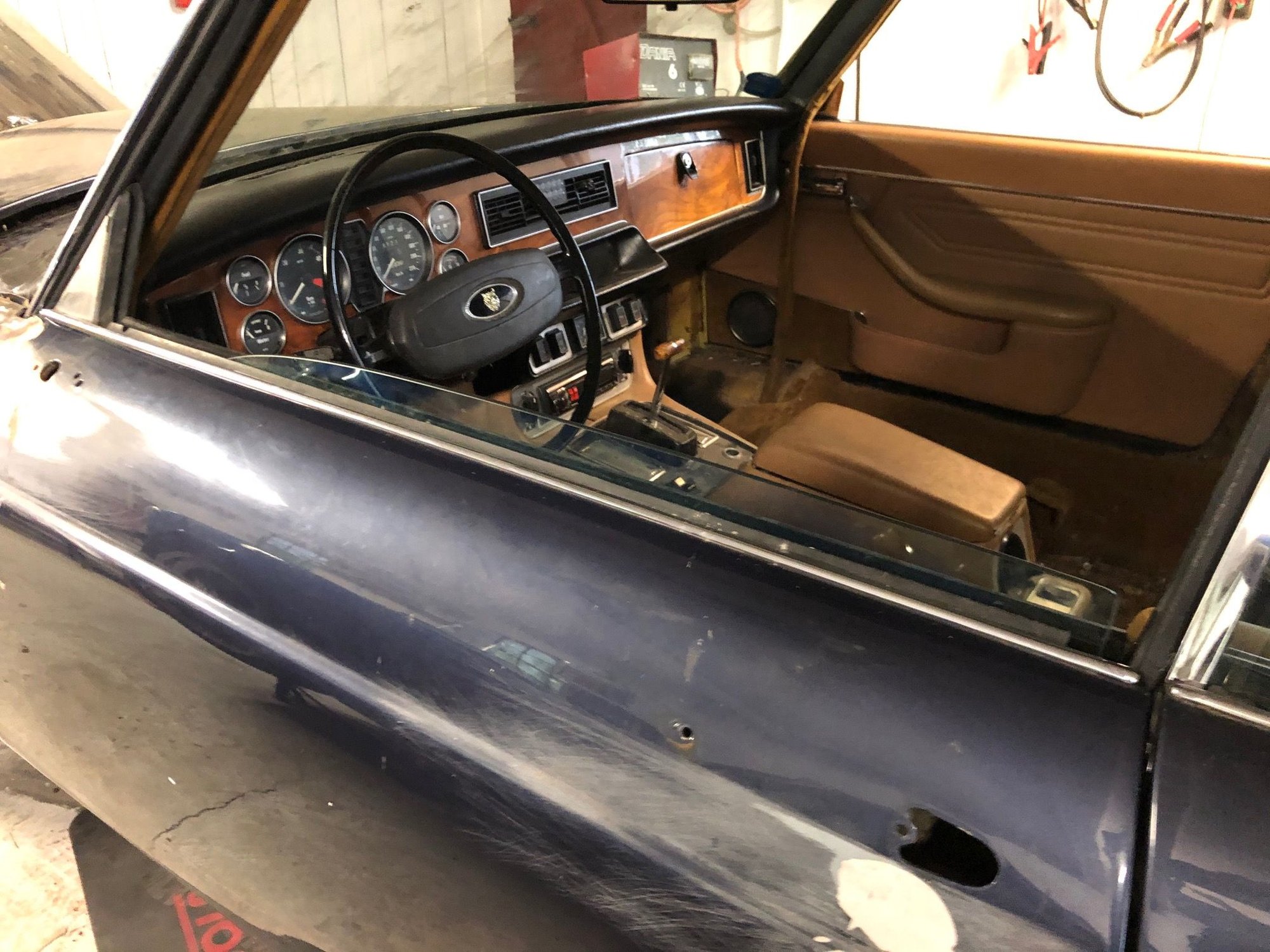

As the pictures shows its a " complete tear down, prep for painter, buy new seals etc , get painted and then total assembly "
So here's the intro story to the PO and the car.
Car used to belong to a Danish writer so well cared for back in the day. Still rusted though. ( winter use maybe?)
The Owner now worked with a Danish Jaguar garage for aprx 30 years both as a panelbeater and a mechanic. He's build and raced MGB with 3,5L Rover V8 Power plants etc so
he knows his stuff. First reason why i'd take this on at all.
So he's done the rust repairs and panels etc and kind of had it ready for paint. Got to sit for a decade but been turned over and started now and then
the distributor is upgraded to electronic , nice. there's a new in box automatic choke unit plus two new factory front fenders for it.
The leather seats are already at his upholsterer who's a retired pro so that gonna be nice
It needs new door seals, window lists etc as they are done but its small things compared to what could be.

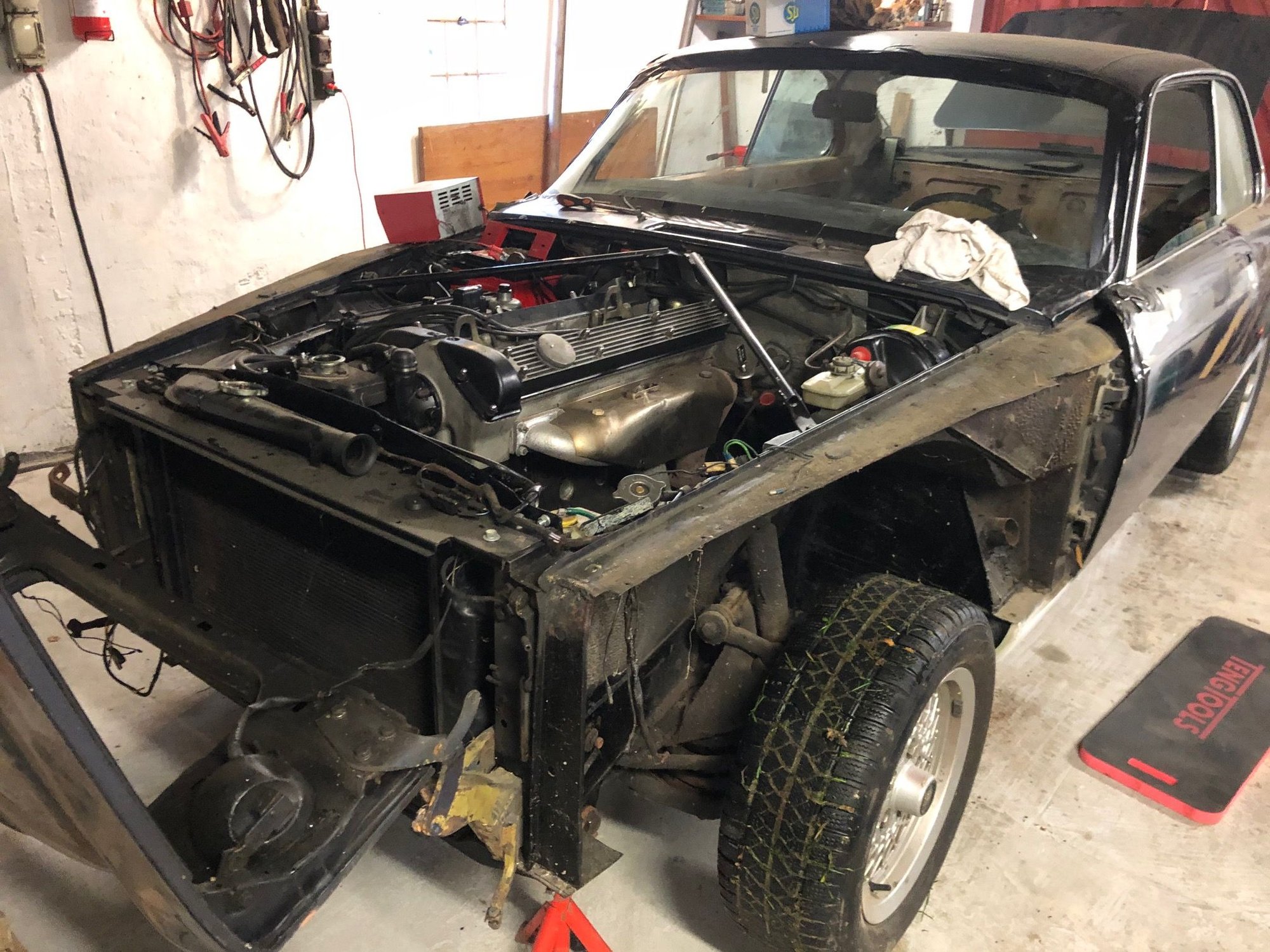

So back i went for a second time, spoke price and estimated the whole project. To help get it out the barn and up into his workshop. Pulled it , made a small ding (damn good he's a panel beater :lool, ) and then jacked it up and went through it.
Brakes had some new fluid , came right back up , still needs changing but now it stops :lol.
Installed the buttom plugs in the tanks , ran clean petrol thru and checked no dirt got into the carbs .. all looking good
Charged the battery over night and meanwhile installed the new choke unit, cleaned it up inside,
The next morning we turned the engine over but sounded off in the firing order so checked the cables up against the TDC .
so we knew we had oil pressure, petrol and so .. changed the cables to a 180 degree fit and tried again .. Bum - started right up (check video for the nice surprise, love it when it goes a little easy)

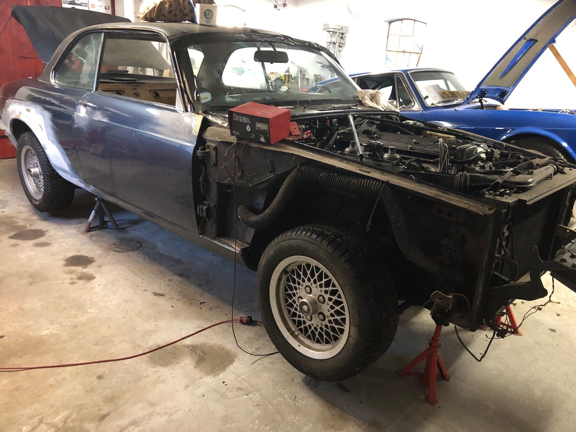

Plan now is simple , Its there on the island til we get the time schedule together: i need a few days to peel off the vinyl roof, remove the last handle and chrome lists, gather up all the loose parts and make sure its all there etc . then a little pre paint prep
and then its ready for the local car dealer to pick it up. He runs empty back to the main land to purchase cars so he can bring it to the painters. )))
Then straight into paint and then i have a few borrowed places on hand for reassembly )

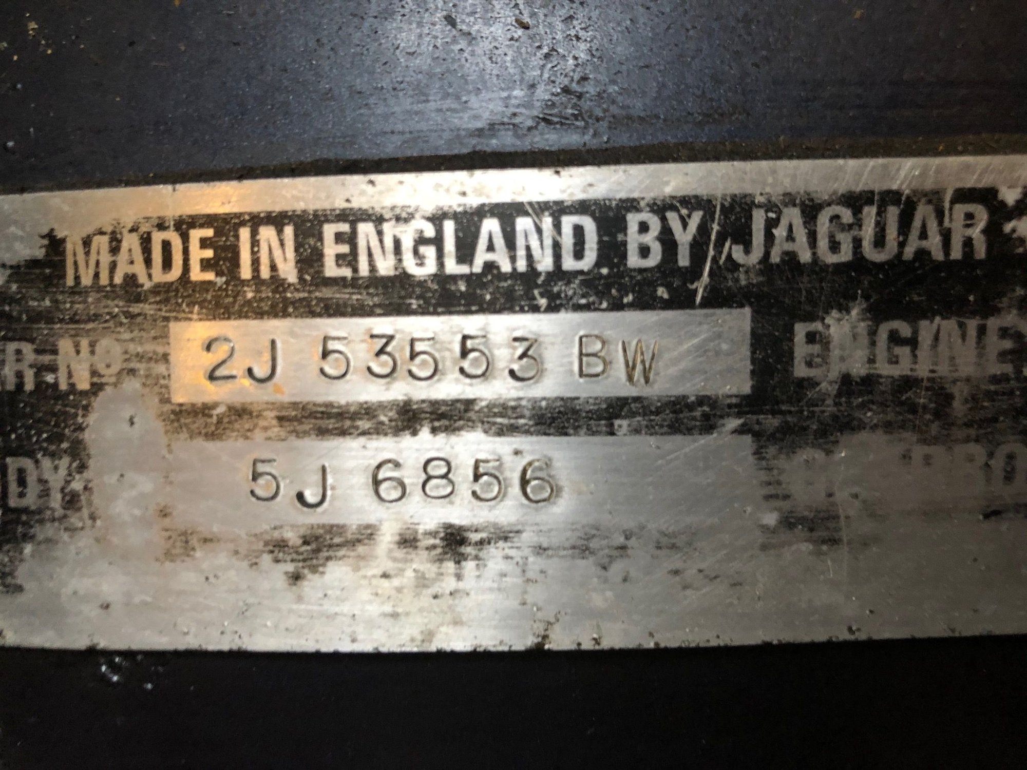

) and also the Vin plate. Anyone thats good at reading those, can help with a color and also feel free to comment and indulged in my project. Its fun to Share.
