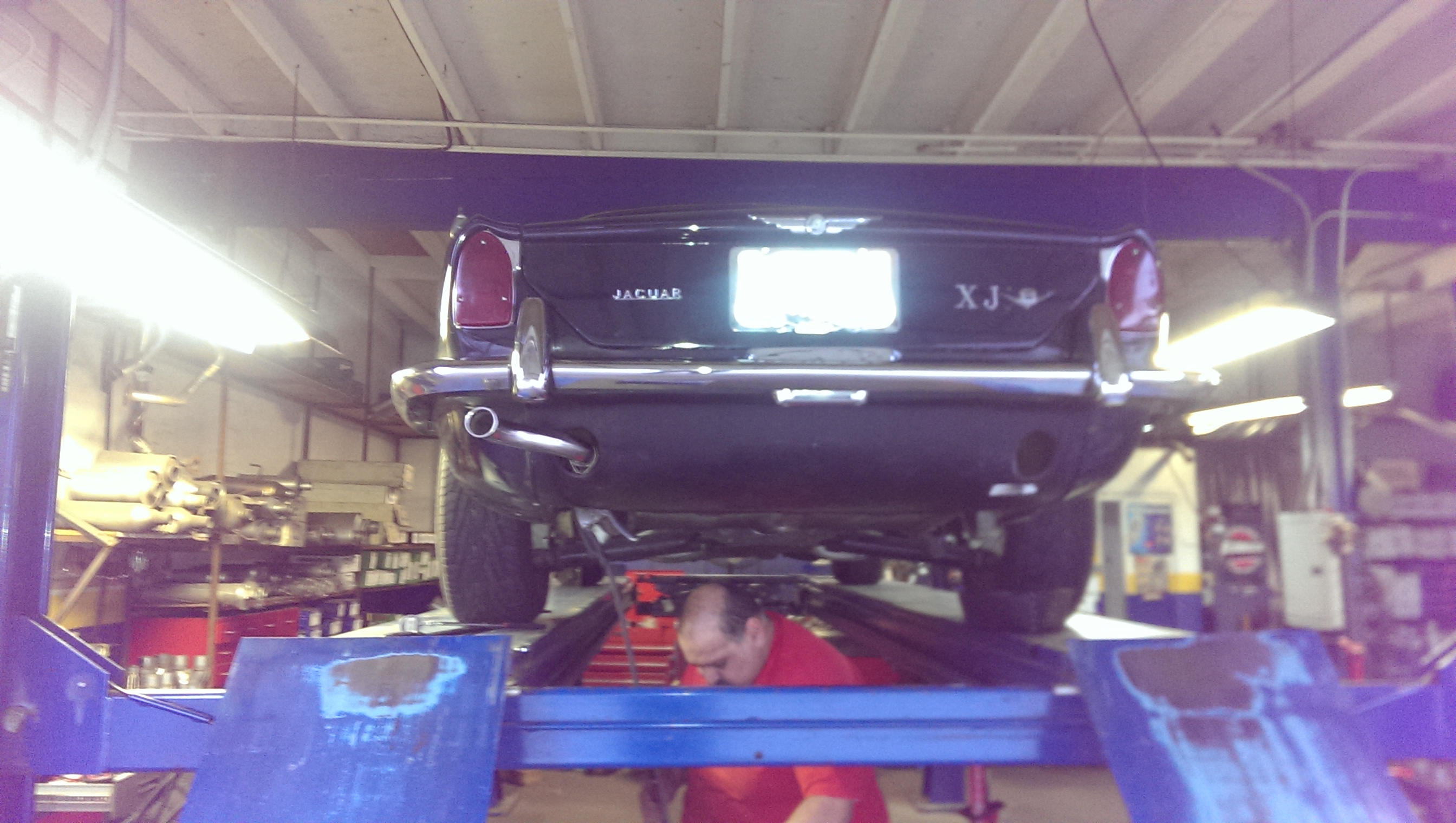

Default I just sized the exhaust to the Jaguar size
I too wanted to use the Jaguar tips.. they are very small but I just necked down the last exhaust pipe to fit... works fine.
