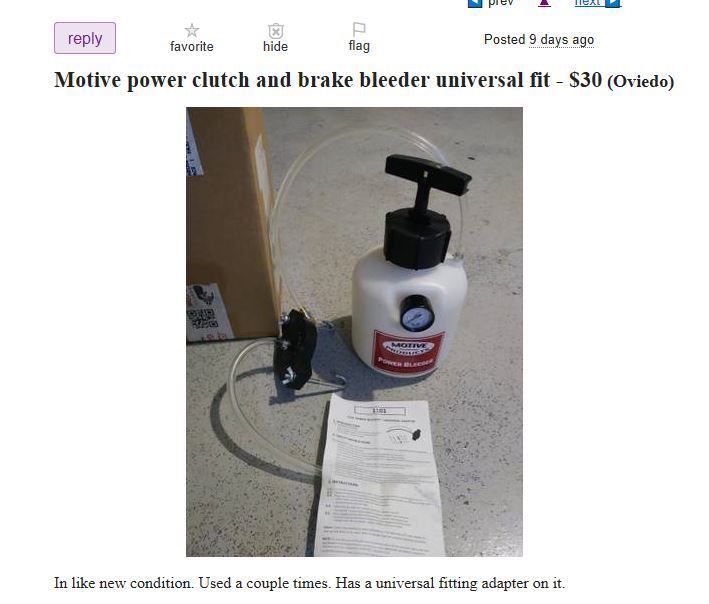

That's a brilliant answer Jose and one that I was entertaining until I saw this on Craigslist last night. The universal adapter it has WILL fit the 3" wide opening of the remote brake reservoir in the Series II. For $30 how could I go wrong!!

For $30 you can't go wrong.
I have a Motive bleeder and a couple vacuum bleeders
Keep some old towels under the master cylinder if using the 'universal' adapters. They often leak, in my experience.

I anticipate the universal adapter will be a PITA. For this time around I will be making a flat bar stock with two holes in it for under the reservoir and two long bolts to go through the top and into the bar underneath the reservoir, then tighten them so no leaks. But... I will keep my eyes open for a suitable cap to modify for the future as Jose suggested. Because I'm sure this won't be the last time I get to do this exciting job. Thanks for all the tips. I'll let you know how it goes.
