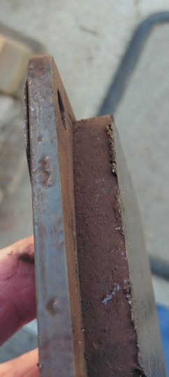

I didn't like the look of the old pads one bit! They were still thick enough alright, but all trailing edges showed melted slag! Hopefully you can see in these photos.
I've never seen that before and I don't think it's supposed to be like that.

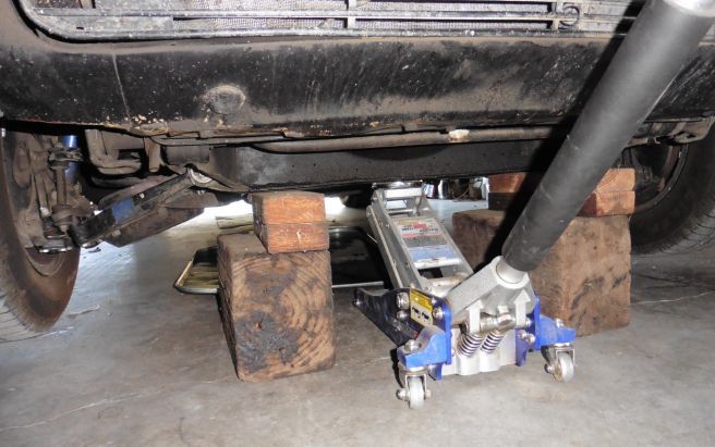

I didn't fool with jack stands this time, I don't have any low enough anyway, so I just put some timbers under the cross member. Worked fine as I didn't need to get Under the car.

Interesting about your brake pads and the melted slag. What this slag really is, and how this occurred deserves some thought. I'm thinking (first cuppa coffee disclosure applies here) that it's the glue from the pads. But why ?
Some very aggressive driving might have created enough heat to melt the glue, especially if the pads were brand-x. Or if there was a problem with the brakes dragging a lot of heat could build up. This could cause the fluid to boil, especially if the fluid was older or degraded in any way, and give you you soft pedal.

I am inclined to go with Doug/ Brand x pads. Soft. quite. Not long lived and almost certainly not up to LNRB type sirited driving,
The fade in my experince relates to glazed pads. too slick. Jst side, not grip. i swapped out the pads in my XJ/ No slag. but glazed.
