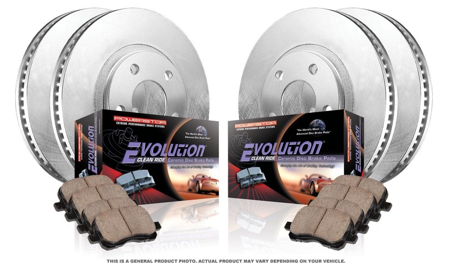

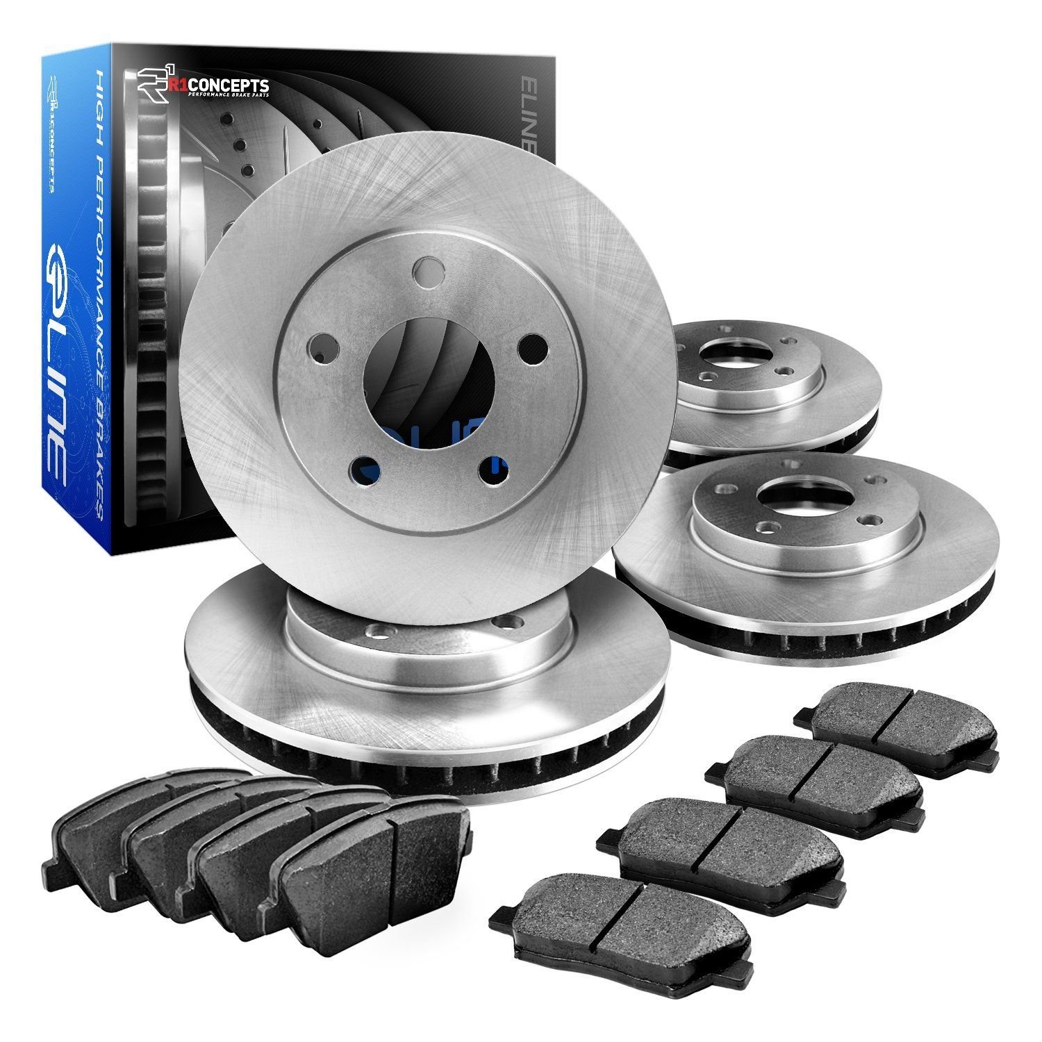

The brakes on my 2000 S Type work fine. However, they are noisy stopping on a down ramp after driving. It is a loud moan. Yesterday, when turning left and braking the right front break moaned but I could not duplicate it so it may have been water. With 48000 miles and 15 years, I am thinking that just replacing them will make the car new again. Here are two choices: Both are the same price. Are the discs with drilled holes noisy? The solid look fine to me to. I would like the quietest set. Any experiences you can relay?

Expect drilled/slotted to be noisier. I'd avoid them.

Thanks Jag. I'll order the plain ones.
