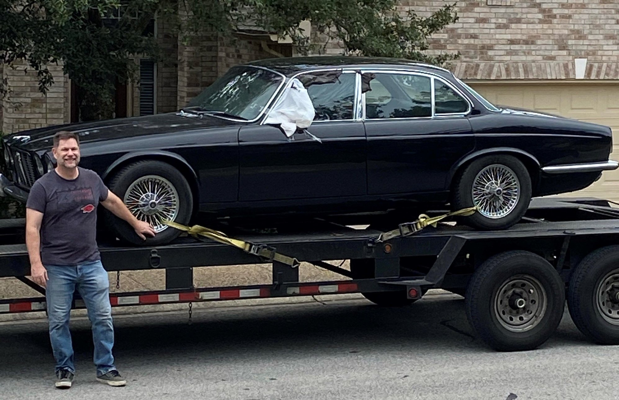

Hello everyone,
New user here so sorry if I'm starting a thread that's been posted here many times. I just re-acquired (for 2x what I sold it for) the 1969 XJ that I restored in 1995, drove in my wedding in 1999 and then had to sell in 2002 (needed money for our first house).
The owner warned me that the rear brakes were out but the entire braking system looks pretty old and corroded to me. I'm not poor but I'm not rich either so I'm looking for an economical way to upgrade the brakes. I won't be driving it like a teenager but I also want it to be able to stop quickly and reliably. Can I easily upgrade to Series III brakes or is there a better option out there? I'm fine wrenching on a car but am not prepared to do any machine work. Thank for any help y'all can provide.
Mike
P.S. the window leaks - thus the plastic bag.

Nice looking car, right color. What happened to the door handles?
83+ Series 3 Sedans or late XJS front is your best bet. You will need the whole spindle though. They'll have newer style neoprene wheel seals too.
Mission creep...If I were you... I'd just get a front IFS from the latest car you can find. The geometry changed starting with Series 2 and the steering got a bit less assist starting with the Series 3 and Later XJS.
Also get an IRS from the latest car you can find too...some of the series 1 brake parts are getting hard to find especially about the back.

re: door handles, it was a "thing" in the late 80's/early 90s to shave door handles for a sleeker look (though not usually done on a Jaguar). I'd put them back on if I could (and might still do). It looks sleek but it's totally impractical - thus the open vent window since the door poppers don't work anymore.
I see. I reckon you're gonna have a hard time getting the original shapes for the door handles back in the sheet metal. I suppose it's all welded shut at the moment?
