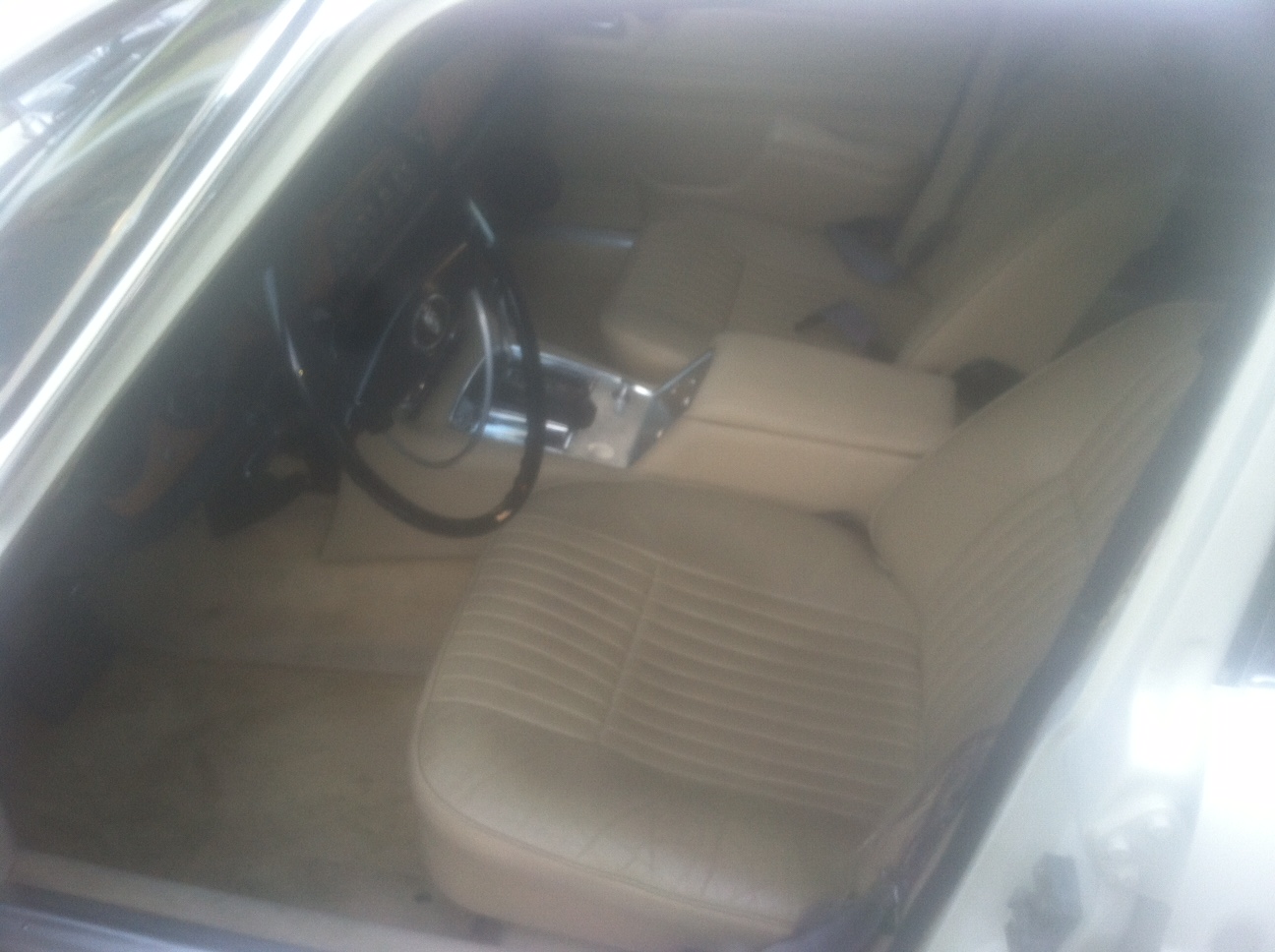

Well, a '71 XJ6 followed me home last weekend. I've always admired these cars but never really considered owning one until this car showed up locally. It's a very original car, originally from New Mexico. It appears to have been repainted once a long time ago but otherwise it seems complete and original down to the tool kit. It came with a huge box of NOS spare parts, some used bits, a stack of books including a factory service manual, the owners manual and an incomplete stack of service records. Being from New Mexico, the car has very little evidence of any corrosion although I am well aware that the tin worm is a mischevious and well hidden little bugger.
The car runs but it has a little miss. On the way home from purchasing it, I stopped for gas. When I turned off the ignition, the car idled on (dieseled some would say). When it quit running after about two seconds of this run-on, it let out a big old hissing sound, and after that it didn't quite run the same. I'm thinking vacuum leak somewhere??? Other ideas?
Plans for the car? Get it to reliably run around the neighborhood then decide about whether to have it properly repainted. The interior is very nice and complete and other than some sun damage on the top of the rear seat and a sagging rear parcel shelf, it needs nothing to be restored in the interior. As for the paint: How can I confirm its original paint code/color?
