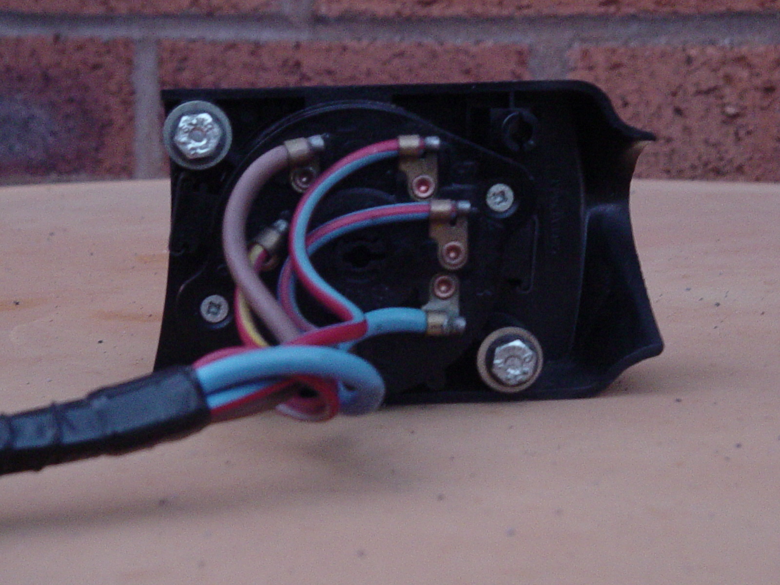

Doug, same switch, no pull-push, talking about the Headlights switch, not the Ignition Switch, David already cleared that one.
first picture is a nos headlight switch for a Saloon and XK-E
second and first pics are a Series 3 XJ headlights switch.
the only difference is that the Saloon/XKE switch has no pull-push, but otherwise it performs the same way and mounts the same way as the older switch. OFF-PARKING-HEADLIGHTS-FOG

Doug, they are the same switch in that you could install either switch in either Jaguar in the same manner as the "original" switch, AND obtain similar results, i.e., turn the parking, headlights, or fogs On and Off.
in fact, I already DID, I replaced a friend's headlight switch in his 1966 S type with a Series 3 XJ headlights switch, all I had to do was remove the switch from the XJ's bezel plastic and metal mountings, mount it to the S type, and connect the wires. Similar results.
