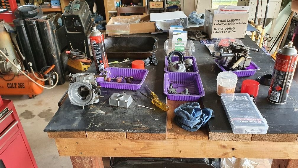

a. took the carburettors apart, and rebuilt them with SU/Stromberg kit. Several problems identified:
i. temperature and vaccum bypass valves full of soot, rebuilt these and reset to the factory tolerances;
ii. needle settings in various states of adjustment, but varying significantly;
iii. float valves dirty, float bowl had a sand like substance in them;
iv. Fuel inlet gauze filter blocked with what looked like silt.

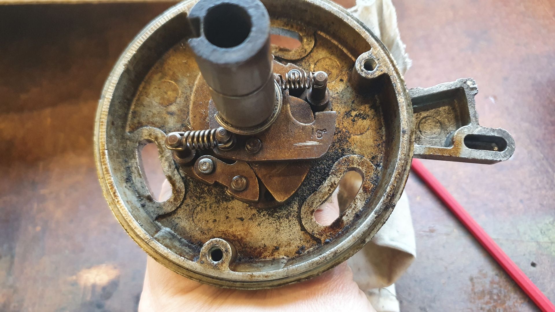

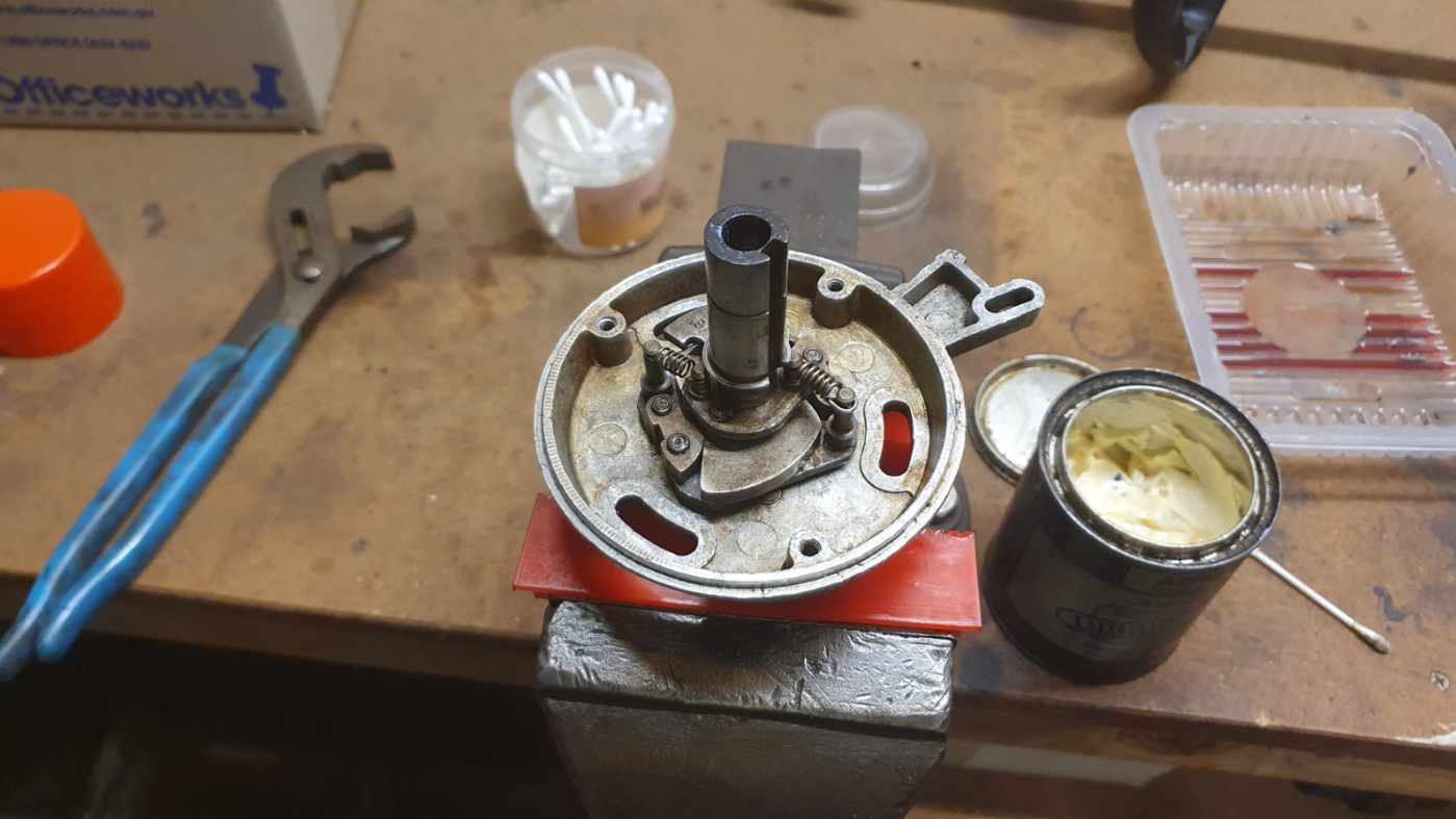

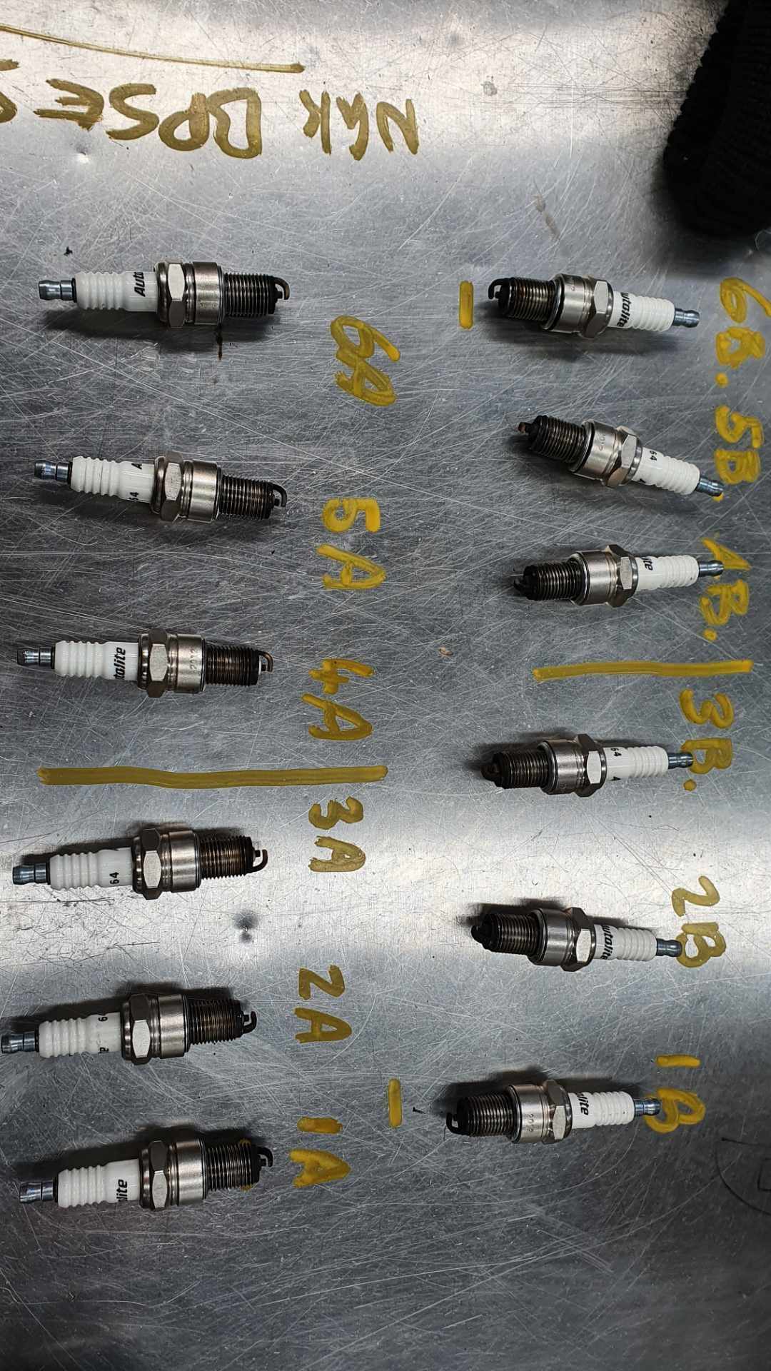

d. Stripped down distributor, looking for damage of siezed mecanical advance etc. Removed all spark plugs, and examined colour/condition.
i. Spark plugs were significantly different in colour, however found that they conformed to a diametrically opposed pattern i.e. the sooty ones were opposite to each other on the distrbutor sequence, whilst the sandy good burn ones were also opposite each other on the distributor sequence;
ii. After closer examination it appears that the bushes in the distributor were worn, and the rotor arm was taking a slightly eliptical path inside the distributor cap, making good contact with some parts of the dsitributor and hardly any/intermittently with others;

iv. Replaced the plugs with NGK (do not use any other plugs in your V12, they are not equivalents);
