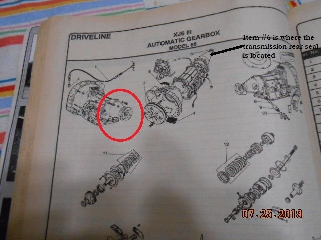

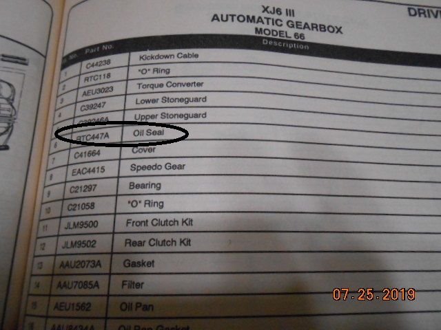

The rear transmission oil seal is the mechanical seal between the rear of the transmission and the driveshaft yoke.
You stated in your post that you had a leak at the "rear seal". Unless you are talking about something else.
If that is really the case, you will have to drop the driveshaft to replace the rear seal.
Look at Item # 6 in the photos attached. This is a Series 3 66 transmission. Yours should be similar.
That is where the driveshaft yoke slides into the transmission.
this is where the rear seal is located
#6 rear seal
Old Jul 25, 2019 | 05:24 PM
sanchez's Avatar
Joined: Jun 2015
Posts: 1,514
Likes: 687
If the rear of your transmission looks like the part circled in red below, you will have to remove the four bolts at the flange and see if the driveshaft will drop out of the way so you can change the seal. Either way, that is where the rear seal is located.

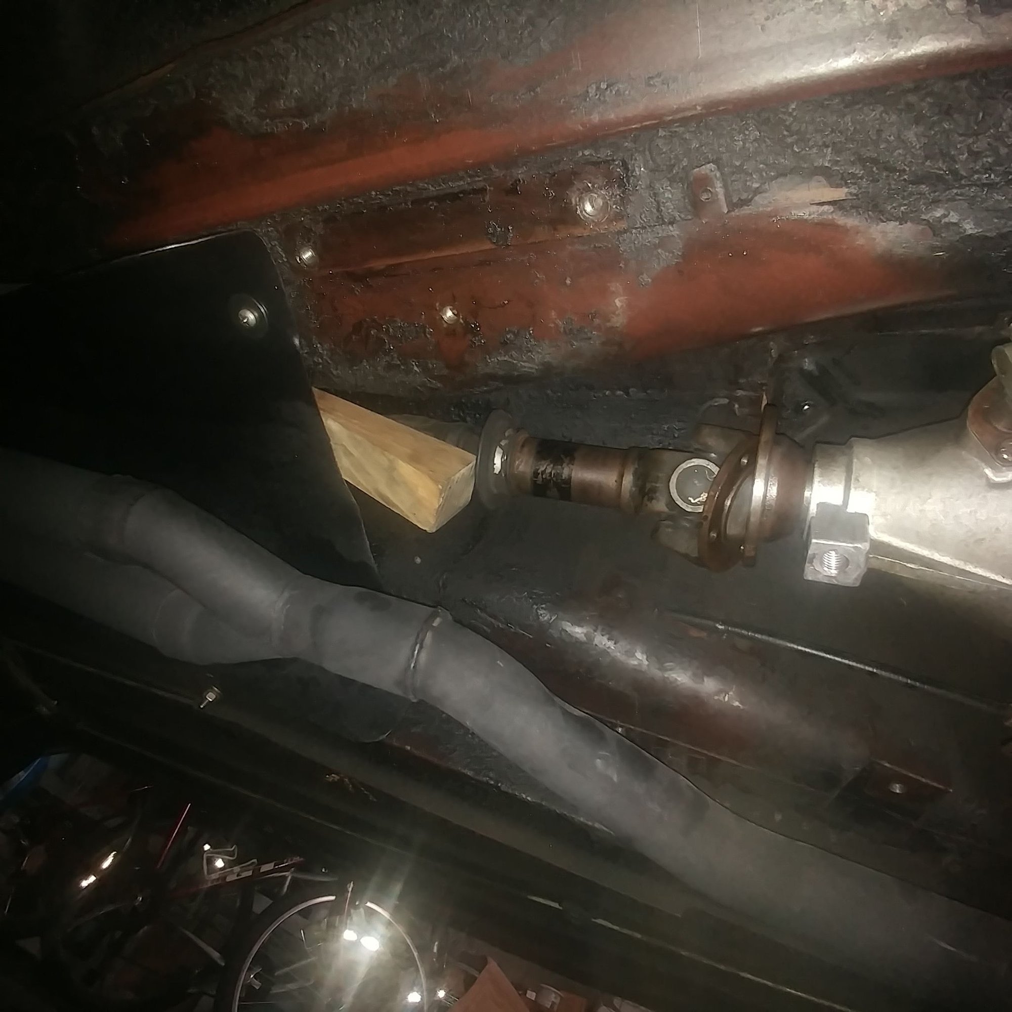

Old Jul 25, 2019 | 06:01 PM
yachtmanbuttson's Avatar
Joined: Jun 2016
Posts: 1,413
Likes: 627
From: Palm City, Florida

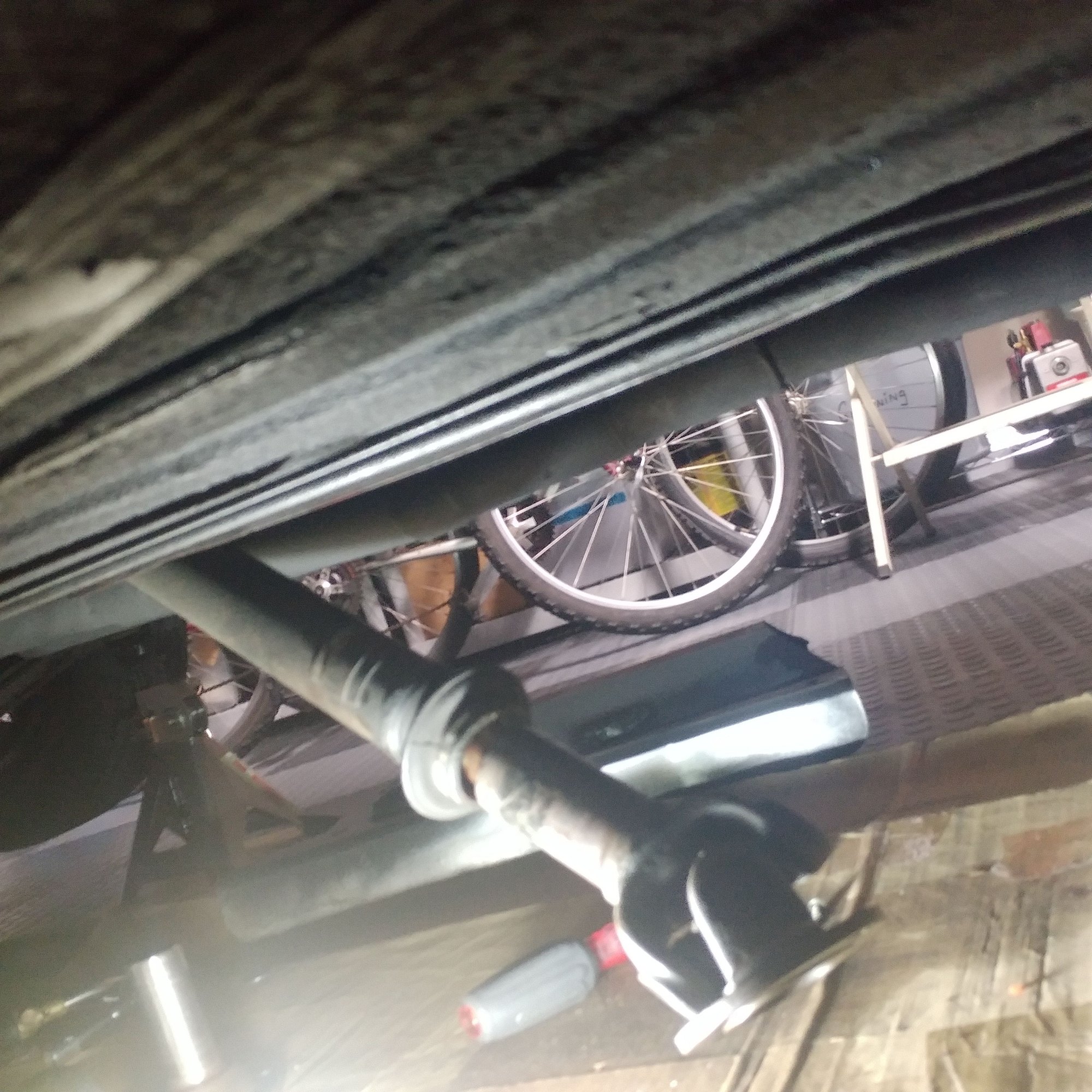

Yes to all of the above. It's close but I figure if I remove the pan to the left in the picure, the drive shaft will drop low enough to be out of the way. Yes? No?
Block of wood is only to hold the driveshaft up

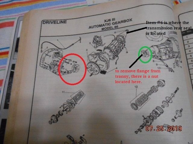

Old Jul 25, 2019 | 07:41 PM
sanchez's Avatar
Joined: Jun 2015
Posts: 1,514
Likes: 687
Probably. The driveshaft still has to move back some to clear the flange of the driveshaft from the yoke flange that is going into the transmission. The yoke flange on the transmission is held in place by a nut which you will have to remove to get the yoke out to access the seal. See image with green circle.
The front part of the driveshaft with the u-joint and the rubber boot (where you have the piece of wood) is splined. You should be able to slide that piece into the main driveshaft to shorten it.

If removing the shield does not work, mark and lower the center bearing. That will cause the driveshaft to bow moving the front backwards.There is a u-joint at the center bearing.

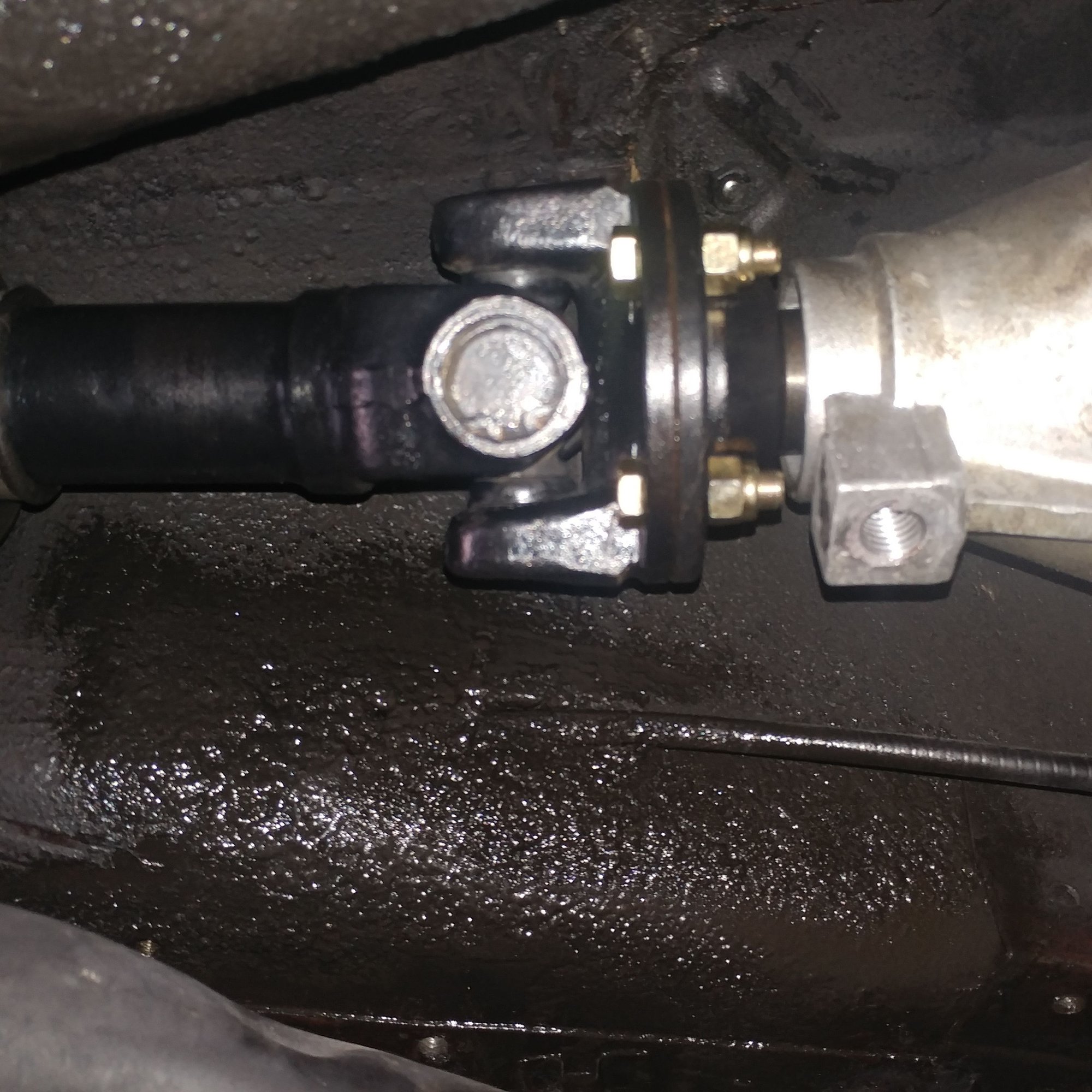

Old Jul 28, 2019 | 09:14 AM
Joined: Jun 2016
Posts: 1,413
Likes: 627
Removing shield allowed this... Second pic, job done. No big deal.
