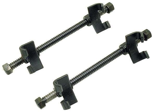

Hi , I have spent the day in every tool shop and parts place in Brisbane trying to locate a JD. 6.D with JD. 6.D-1 adapter. No one seems to have a clue what to look for as an alternative. Every spring compressor I could find looks nothing like it.
Is there an equivilant coil spring compressor on the market,or a generic one that would remove the front springs. A brand or part number would be really helpful.
Even a cheat way to do the job,got to replace lower wishbone bushes before I get a wheel alignment done.
I'm just going to attack the job anyway and see how it goes, I have the normal type of coil spring compressors but they look like they won't do the job.
The used one in the pic is 60 pounds plus postage from the UK. If any of you Australian members have one you want to sell let me know as I know a lot of you have later model Jaguars now and maybe don't use these tools any longer.

STOP: don't tackle front spring removal with standard coil spring compressors. This is potentially extremely hazardous.
There are workarounds to using the approved Churchill Spring Compressor.

Thanks for the warning Graham. Going on more of a hunt tomorrow for the right tool. But the only place who has one I can find won't even give advice on where to find one,they just want the car dropped off next Thursday so the job can be done properly. But I will not pay a mechanic until I have at least had a go.

Pleased to hear you stopped in time and still have both arms and a head!
Because of the curve when the springs are in position, they could fly out as the spring pan is removed unless suitably compressed.
The two workarounds members have used are:
1. replicate the Churchill Tool using threaded bar and flat plate
2. replace each of the pan setscrews with lengths of threaded bar and gradually wind off the tension
I've always managed to borrow the genuine tool when I've done front springs but both the above workaround approaches have been used frequently by members.

Thanks Graham, threaded bar sounds like the best method...just got to see if I can get the right threaded bar as most things around here are metric.

Hi I have just made up a replica tool to the jaguar one. The idea is to get a length of threaded high tensile rod, 20 mm. The type of thread is not relevant. Also get a 1 and 1/4 inch long by 1/4 inch diameter hardened steel dowel. Some high tensile nuts. See don B links, in the xj40 section under my post "spring compressor". Mick
