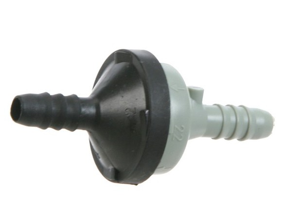

in USA LHD cars, this check valve is located hanging near the battery, close to the firewall/bulkhead, between the vacuum hose from the engine, and the vacuum hose to the Servo in the interior.
seems like it sticks in the closed position, I've put mine in a pan with warm water until it unsticks and starts working again.

Cool thanks guys i located the valve..would it be true to say the opposite would happen if i flipped the one way valve in the opposite direction, i gave this a go and the flap stayed shut ...if it was the valve i would assume i would get the same results
i will hunt try hunting around for a vacuum leak thanks for the guidance will keep you posted when i check it out tomorrow

all you need to do is remove and blow through the check valve in the direction of the arrow, if air goes through one way, but not the other, the valve is fine.
