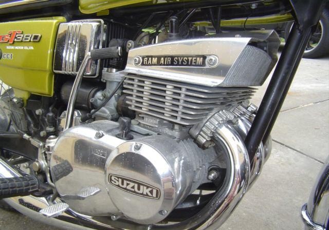

I don't know the ram air system. But to me it looks like it will cool the cilinderheads, rather than the ingoing air.
your air intake is further back, so I don't see how the ram air will guide the air to the intake. Seems like an option to increase cooling for these aircooled engines. But nothing to do with CAI.

Originally Posted by o1xjr
So those Ram Air Suzuki's I shelled out for in my youth just made me feel good and fed Michio Suzuki's offspring and executives.
I certainly felt like I was getting value for money.
Attachment 119058
Elinor, if it feels better it must be better. When I head to higher colder parts of NSW my car runs and feels so much better.
I always put it down to the altitude and colder air.
I know that Wilfred, just thought I would stir the pot a bit with something that didn't actually make any difference to the average user.
I believe CIA does make a difference, or I thought it did on my old Jeep. It was one of the few mods I made that did make an improvement compared to evreything else that was just convenient or cosmetic.
