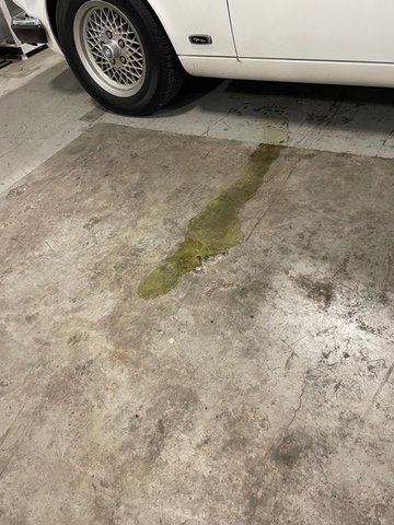

Default Continued comeuppance/coolant leak
In the past I've gloated about how reliable my Jag has been as as daily driver. Again the fates are punishing me. . I'm wondering how long this will continue.
The car has been performing very well but seems to have ...um....sprung a leak. I have not investigated the cause yet.
One upside is that it happened not 10 feet from my workshop door !
Hoping for an easy fix, of course. Radiator, water pump, hoses are all about 5 years old.
DD

Old Jun 26, 2021 | 02:50 PM
JagCad's Avatar
Posts: 6,796
Likes: 2,403
Luckiest.
1. AC condensate.
2. Gaiter disposal from the cowl
3. Heater hose at the valve.

Old Jun 26, 2021 | 10:24 PM
Posts: 28,811
Likes: 11,280
I am with Carl.
Middle of the car area, nit much there.
Heater tap springs up to me.
Your atmospheric tank would be up front from memory.
Water tubes seals on the top of the head, mmm, maybe.
Memory is you no got AAV, so maybe the blanking plate is leaking.

Old Jun 27, 2021 | 05:37 PM
Doug's Avatar
Posts: 25,529
Likes: 11,724
From: Pacific Northwest USA
Water pump.
Or at least the water pump gasket !
The location of the trail under the car was a red herring. The floor simply has a slight slope in that area.

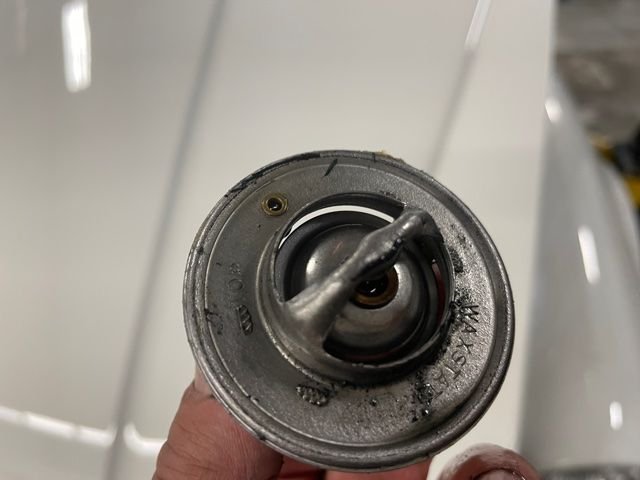

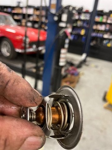

Originally Posted by Doug
Thanks, Jeff.
My first clue came over the winter when I needed the heater. I'd have to drive the car 20 minutes before I got any real heat...with the temp needle moving upwards very slowly. So, in my case, I think I'm on the right track with thermostats. We'll know in a week or so.
Both thermostats are not fully closing. The two pics show the thermostats at room temperature (about 75ºF in this case) and is plain to see they are partially open!
DD

Old Jul 5, 2021 | 02:40 AM
Posts: 28,811
Likes: 11,280
Those stats are NOT what you wanted to find, but a GOOD find all the same.
Why is a no answer I suppose.
I also have a few do that, and never really tried to work it, just fitted 2 new and moved one.
The X300 was the worst for that, I reckon I did 3 in the 5 years I had it, NO heat was the clue there also.
