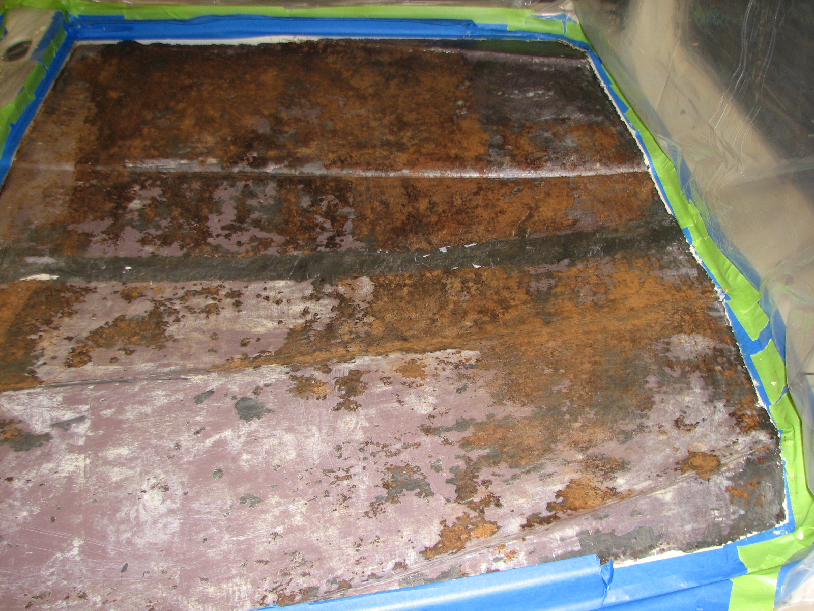

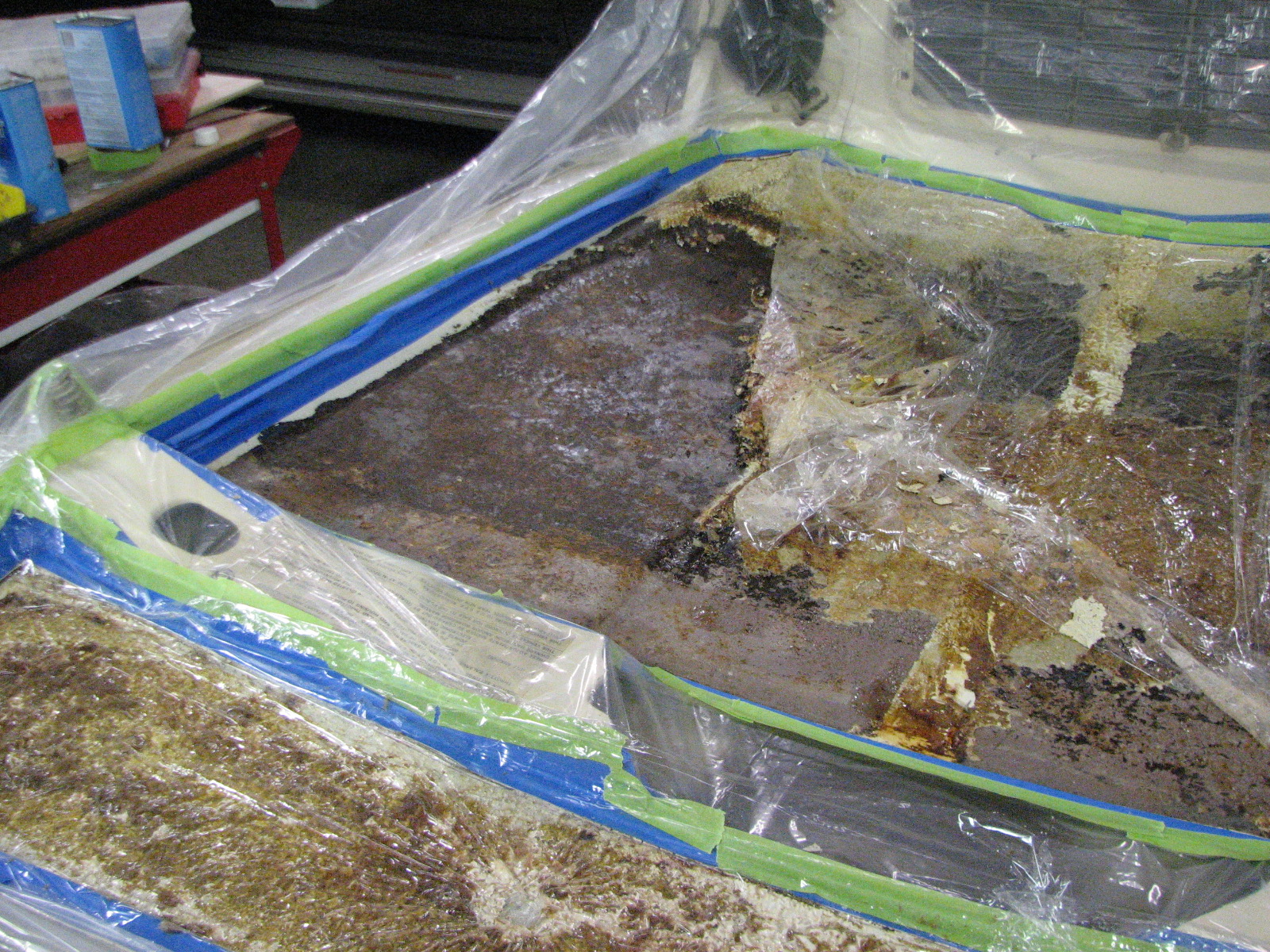

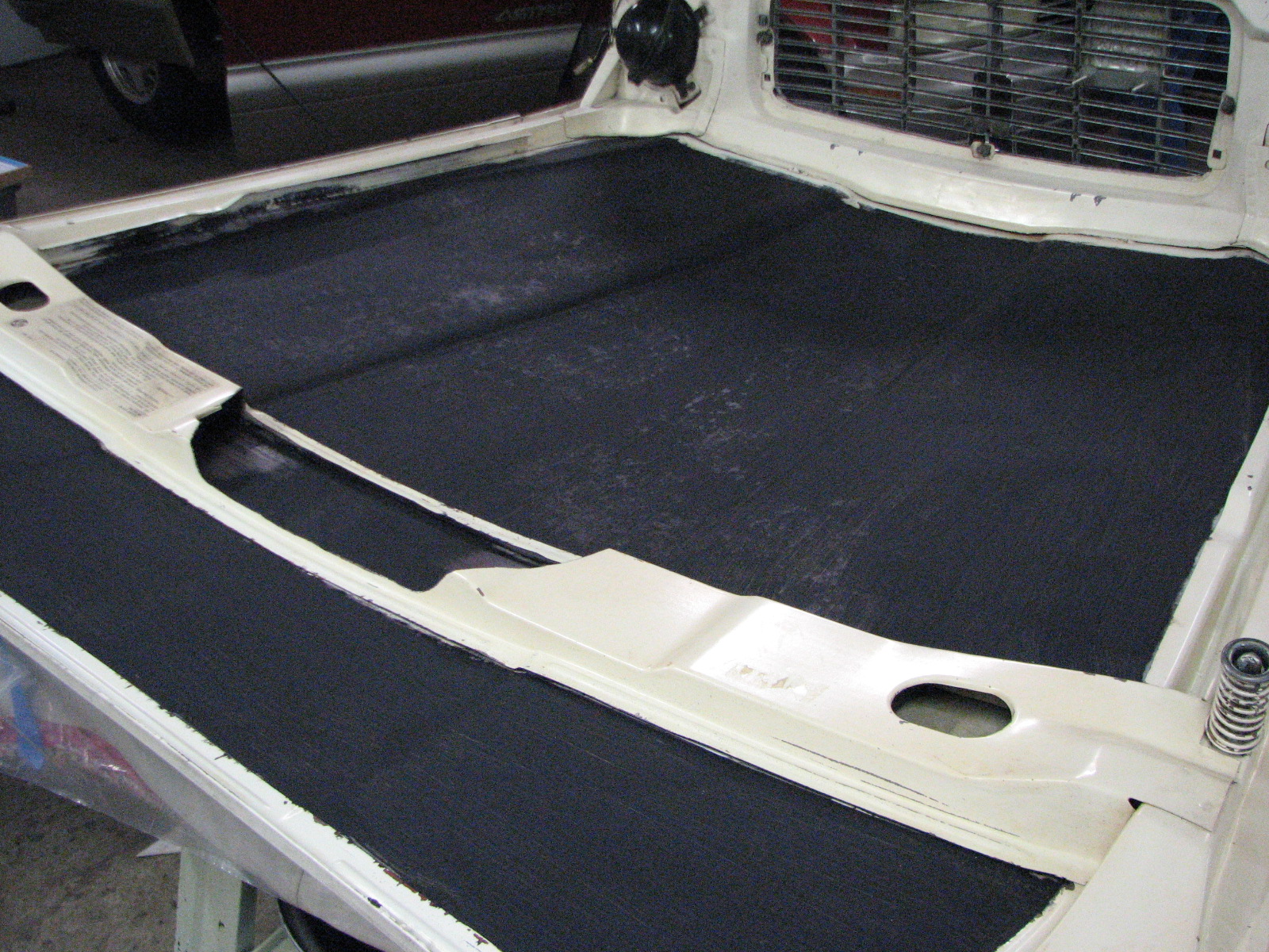

I have a '77 XJ12L with a BBC. Hood is always cool or only warm to touch. Lizard Skin Ceramic Insulation cured my heat issues.
Spray-On Insulation - Automotive Insulation Coatings | LizardSkin
The "bituminous" separates from the metal, holds moisture, and rusts the bonnet from the inside out.
My prep included: 1)air craft stripper, covered with saran for an hour, removes easily with a plastic body putty applicator; 2) sanding; 3)Eastwood Rust Convertor; 4)Eastwood Rust Encapsulator; 5)Lizard Skin Ceramic Insulation.
For the purist, then you could add the factory style blanket insulation.
