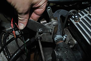

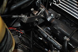

There is one "gotcha".
On a S3, the back of the head, in the area where the cover meets the head, there are no holes drilled and tapped to accept the throttle cable bracket the S1 uses.
With the advent of injection, the bracket was no longer used, and the holes no longer drilled and tapped. This has to be done while the engine's out, as there's no room with engine installed. I had to fab up an ugly bracket off a head stud when I found out, after installing an engine.
