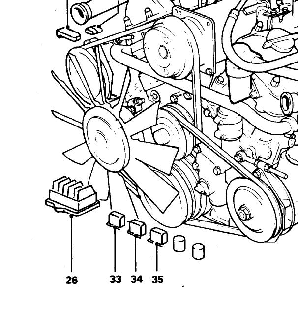

As for the ign. amp? You mention the distributor. I guess that by "ign.amp" you mean the unit with cooling fins on the radiator (as in the pict.) or have I misunderstood?
Is there an answer to post #1 question 3?
Old Jul 24, 2016 | 10:24 PM
Posts: 28,842
Likes: 11,293
If the "legend" for that drawing states Opus Amp, then that is it. The original Opus amp was installed in the V, just in front of the distributor, and aft of the a/c compressor.

The first relocation kits had a longer wiring loom, so the amp was relocated, and I think??? the sedans were refitted to the rad top panel, and the XJ-S to the rear of the engine bay wherever room allowed.

My V12's have the ignition amp, and other heat sensitive components, outside the engine bay totally.
