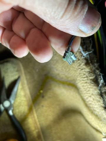

Just in time for winter I developed a problem with the climate control system. The defroster wouldn't work. When selecting 'defrost' there was no response or, more commonly, the entire system just....stopped. I was dreading a problem with the hard-to-replace micro-switches behind the mode control knob.
Long story short....
I made whatever checks and inspections I could with minimal disassembly. Some wiggle-testing of wires at the blower relay revealed the problem: a crusty connector on the black/blue wire. This wire grounds the relay(s) and goes to the "Lo" switch of the mode control. A new connector restored correct operation of the system. Years ago I had problems with a different wire at the blower relay pack.
Here's a pic of the culprit connector. It actually broke apart on removal.
The moral of the story: don't tear the car apart looking for a complex solution before checking for the very-easy-to-fix possibilities!

Absolutely. I did all the recommend tests and established that my starter had died. Had it most of the way out before I noticed the small wire from the relay had just dropped off. It was on top of the starter where I couldn't see it; if I had just reached up there I could have felt that it was off. Replaced the little spade terminal like you did, Doug and I was back in business.

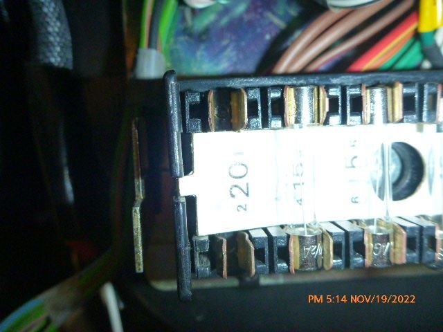

As some of you might remember, I complained about my HVAC not working this summer. I pictured an irritating project ahead during the winter, I was correct. Contrary to Doug's good fortune, I did have to dismantle a good deal of stuff. I found that the #6 fuse in the main panel had proper voltage in and out, but I didn't have any at the On/Off micro switch in the Mode selector. This circuit also feeds the wipers and they worked. I was not taking that area apart any further to find the open!
Now comes my bit of shared info. I decided to run another wire to the Mode selector, but I didn't want to trash the wiring by cutting and splicing at the fuse panel. After inspecting the back side of the fuse block, with the help of a mirror, flashlight, and a wooden wiring probe (called a spudger), I could see that only one half of the pair of contact pieces that hold each end of the fuse had the circuit wire attached. The other contact piece was loose and available to connect to another wire. Both contact pieces are inserted and held in place just as any other wire terminal is held in a connector body. In the picture you can see a slot on either side of the contact pieces, this is where you would insert an appropriately sized connector release tool and push the holding tang out of the way. The contact piece then pushes out of the block to the back side. Connect another wire to it and push it back in from the back and you have a factory looking wire addition.
Dave
