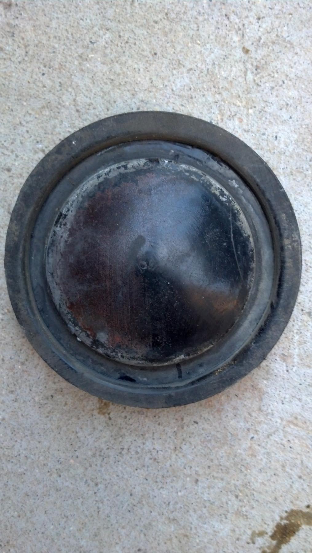

1) The tanks have a draining 'bolt' on the bottom rear of the tanks. Accessing them is a problem, however. They are hidden under a black plastic cap (or 'bung'). See 1st photo.

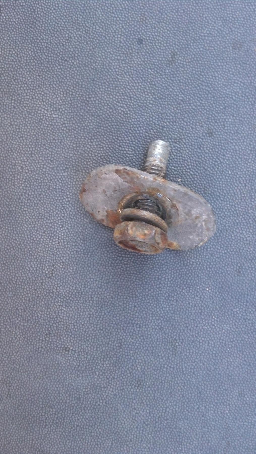

2) The bung can be pushed up, but DOESN'T come out, unless you break it. What you need to do is remove the Phillips head screws along the bottom of the rear quarter panel with a #4 Phillips screwdriver. I sprayed WD-4 in between the panel skin near the screws to loosen it up a bit. See arrows on 1st photo.
3) Once the screws are out (pic 2 is of the screw) , you need to remove two 7/16th inch bolts in the wheel well (see 3rd & 4th photo). This allows you to pull the quarter panel enough away from the body to push the black bung cap up into the quarter panel and over to remove it (Pic 5). This should reveal the drain plug (see pic # 6 & 7).
