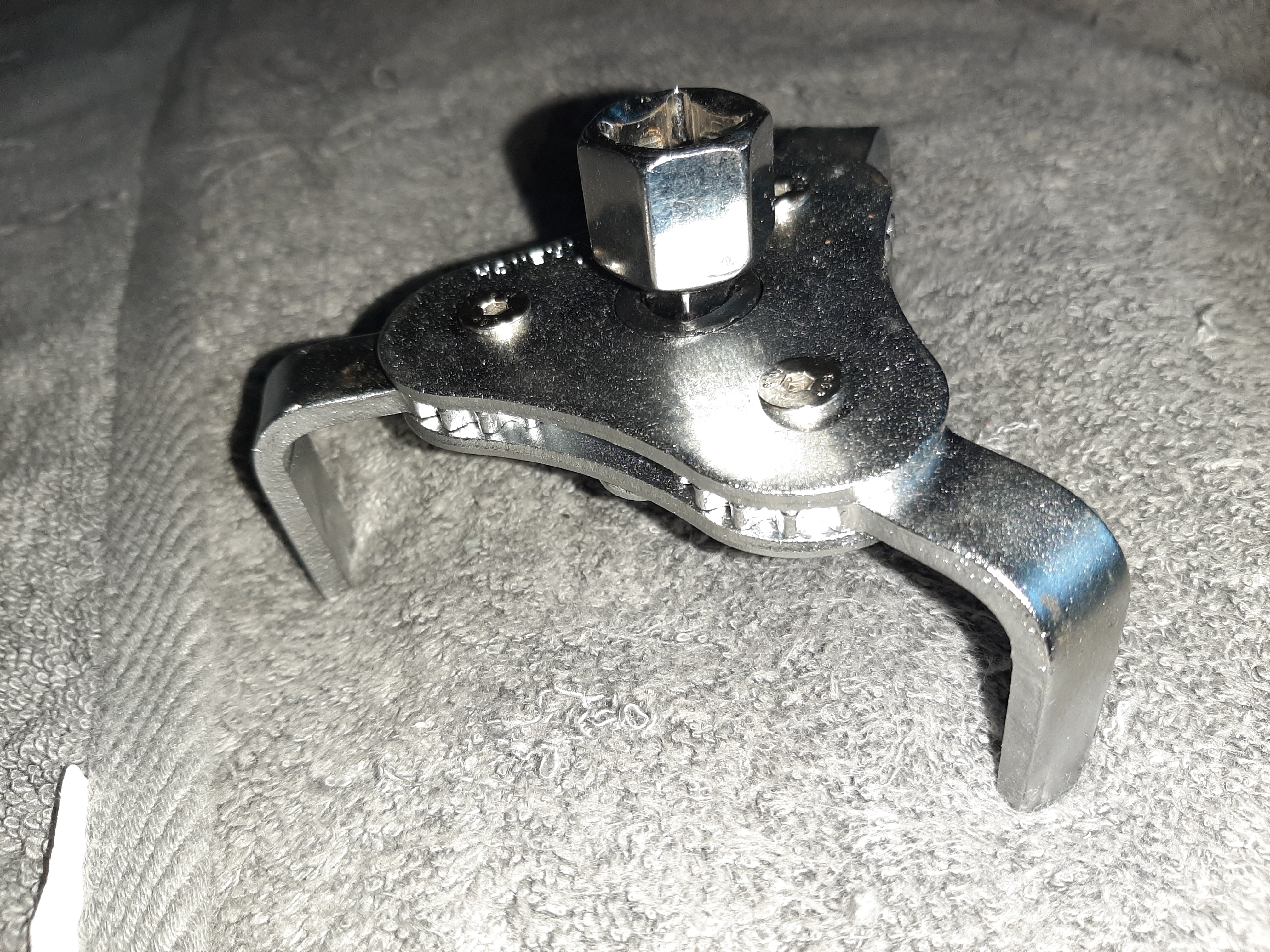

4) once you get both bolts loosened and you are having difficulty rotating the distributor, i found success using this tool:
i got it at napa to remove oil filters. it grabbed onto the outer edge of the distributor body (without the cap) and gave me the purchase needed to ease the assembly in both directions aided by a liberal amount of pb blaster. i was soon able to easily rotate it with my hand.
