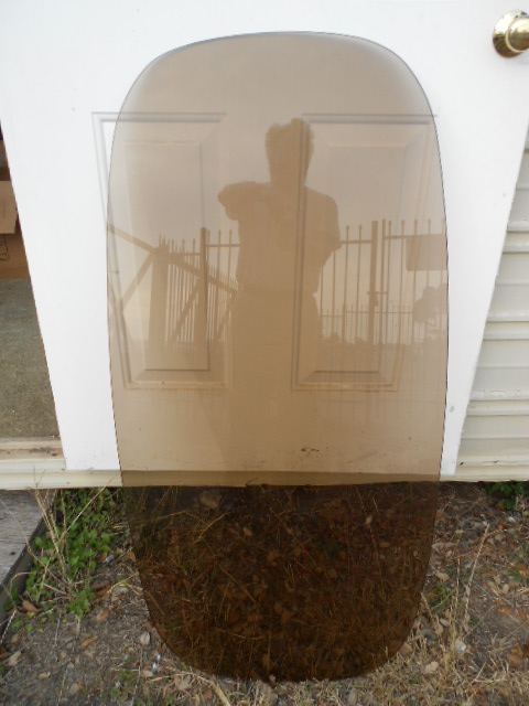

skillet; i have a great piece of thick brown see thru glass table top, 4' by 2' oval shaped, for your V12 base, great conversation piece,for sale for anyone interested, PM me.
