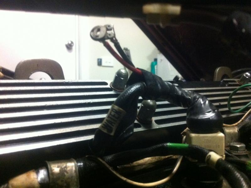

What other points of failure might there be? I do have a weird little wiring modification that seems really dodgy. I will try and attach a photo.

Interesting. Can't make out what the widget is at the end of the wires but it's some sort of modification to the coolant temp sensor.
Hard to say if this was someone's idea of an improvement or simply a way of masking a problem with the sensor...or what.
I'd peel back the tape and undo the wires and see what happens.

you could cut it out but i wouldnt that coolant sensor goes to the ecu the previous owner probably put it there to tell the ecu the engine is hot so you
can pull your thermostat and it wont dump fuel
